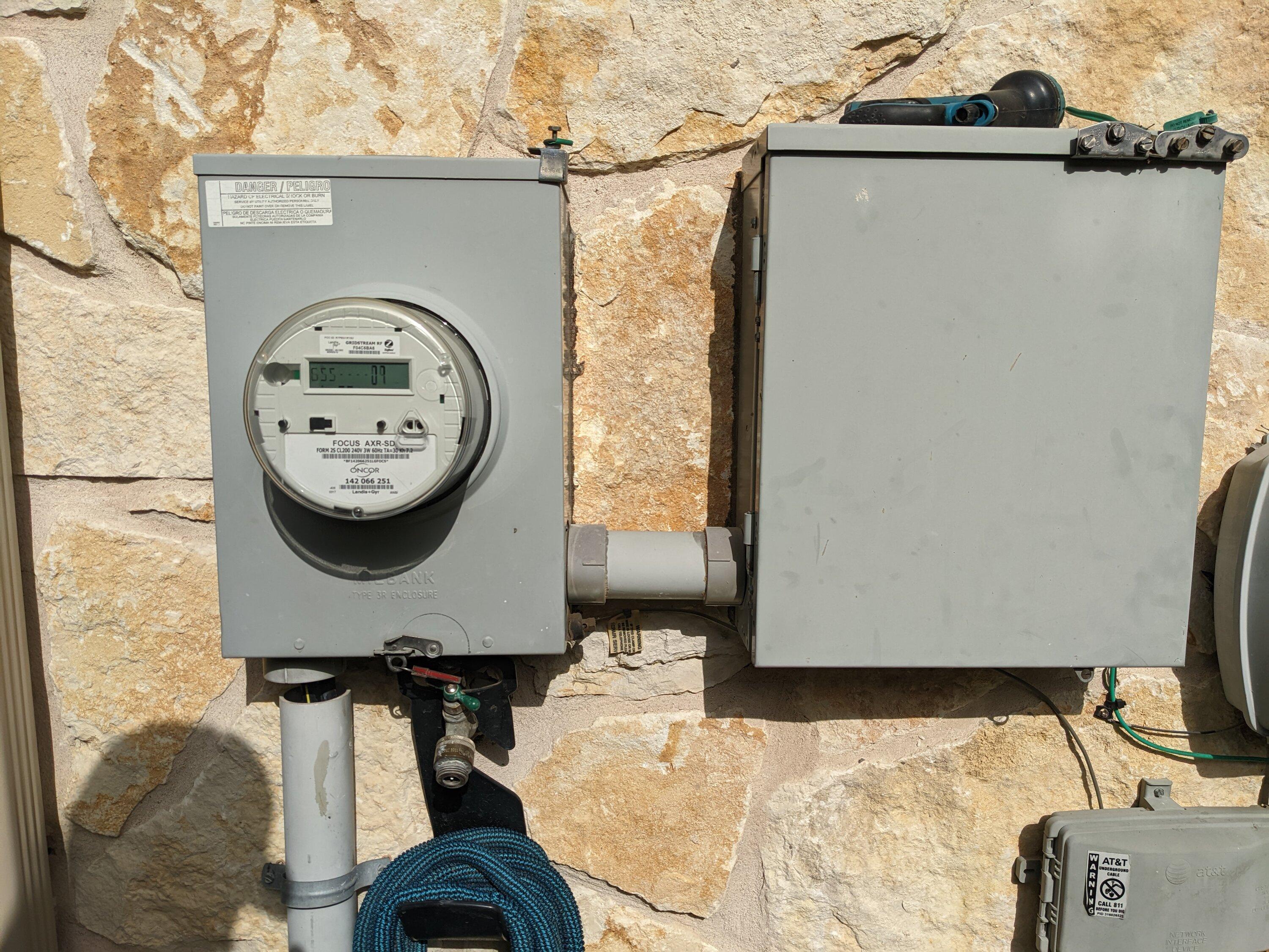

My main panel is outside near the corner of the garage. I park my truck outside on that side of the driveway. I'm going to install mine out there a couple feet above the main panel. Should be a cheaper install and it will be under the eaves of the house. If sun or rain begin to look like they'll impact it, then maybe I'll just buy a big, gray electrical box to put around it. Then it'll fit right in with the 3 gray cable cable boxes, 1 gray phone box, and gray breaker box all lining that side of the house.
Should go right above here:
Ford F-150 Lightning Should I Install Charge Station Pro inside or outside ? PXL_20220616_142145052
