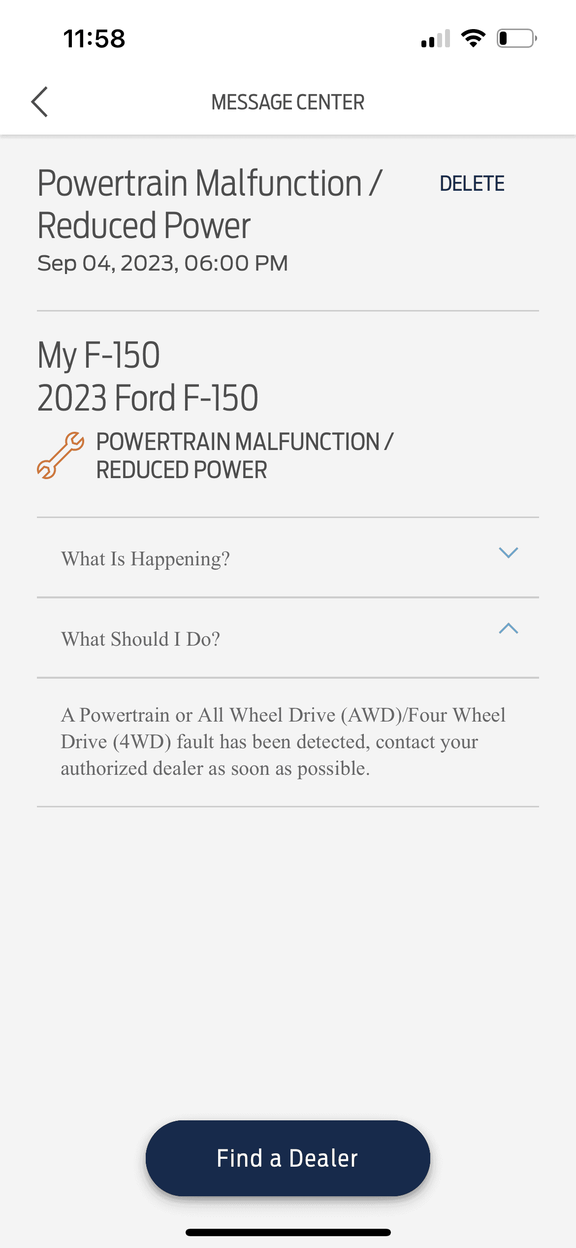

This weekend I received an error message on the instrument screen: "1 Pedal Drive Fault Press brake pedal to reduce speed". This happened immediately after start up, I hadn't even gotten out of the garage. Might have shifted the truck back from reverse to park, as I was loading the kids in the back, and determined I was missing a kid. Unfortunately I am not confident it that assessment. The truck is always set to use 1 pedal driving, so I am confident that was on. When the message was on the screen, the 1 pedal driving was clearly not working, as I just barely avoided damaging the mirror backing out of the garage (funny how quickly we adapt to new ways to do things, and compartmentalize certain characteristics to certain vehicles).
A wrench popped up on the screen as well, saying I needed to take it in for maintenance. Also received a notification within my Ford Pass app stating I needed to take it in for service. Here is what that looks like:
Ford F-150 Lightning One-pedal fault! Anyone else experienced this? malfunctio
I immediately restarted the truck and the 1 pedal message went away, and one-pedal driving started working again. The maintenance wrench remained however. Upon start up this morning, neither message nor the wrench is present and everything seems to be functioning normally.
Anyone experienced any of this?

I got that 1PD message on startup on my Mach-E twice in the 2-1/2 years I’ve had the car. Both times it was accurate (no 1PD) and it disappeared after the next start.
It looks like you have a bigger issue. The 1PD thing could just be a coincidence or a side effect of what your powertrain issue is. Time to see the dealer.

I had the same issue once. Turned off the truck and turned it back on and then I got some other message freak out (maybe the motors overheating? I can't remember). Shut it off again, waited a minute, turned it back on and it's been fine since
