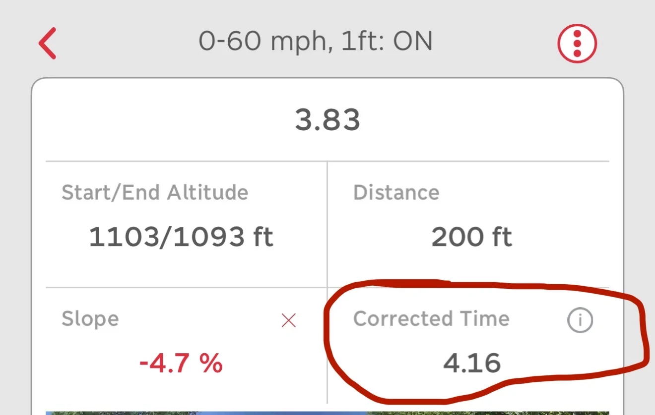

Again, this is great stuff. It would be nice seeing a result with no TC just to remove that variable, but otherwise your process seems reasonable.
This leaves you with two outcomes:
1. Due to the cold temperatures, traction issues are slowing you down by about 0.5s.
2. You’re also impacted my this mystery update that has reduced power output/deployment.
Hopefully it’s option 1, that said I’ve had wet launches that were better in very wet conditions (see the screenshot below)….. That said, TC was fully off so it’s possible the TC power cut is being a bit aggressive for you. Ultimately that’s going to come down to temperature and road surface. If not comfortable disabling TC you could always do a 30 to 60 roll to remove the traction variable.

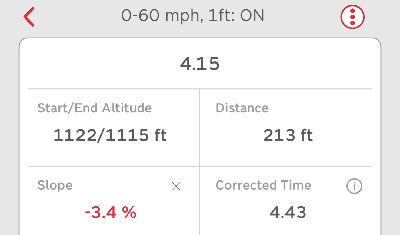

Indeed kW is power…. It’s been a long day. Again, the point still stands. How many amps should owners of each pack expect to see?
To answer your question, Ford.com has published all the 0-60 times over various model years. Right now it appears to only have the 2025 Lariat ER posted at 3.8 seconds and the Platinum at 4.0 seconds. However previous Ford publications circulated to dealership networks are easily searchable and show both the SR and ER packs at links like this: https://www.fordoffeasterville.com/blogs/4896/ford-lightning-0-60-times-and-acceleration
As mentioned plenty of auto outlets have also tested these trucks coming up with the following:
Pro/XLT SR = 4.2s
Flash 123kWh = 4.0s
Platinum = 4.0s
Flash/Lariat ER = 3.8s
