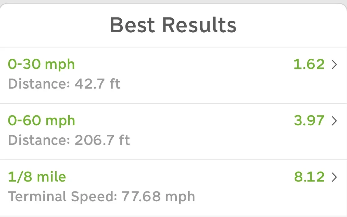

blb228
Brett
Apr 1, 2025
64
43
2024 Flash Agate Black
From personal experience - I have driven and drive in Sport Mode 99% of the time. For fun; I had initially gauged my 0-60mph time after purchasing in March of this year to see how close this '24 Flash was to the advertised 3.8 seconds. This was a pretty consistent 4.1-4.2 second 0-60mph times on a very slight downhill, but even grade. I tested this again yesterday several times and was getting consistent 4.6-4.7 second 0-60mph times. It was in fact colder outside yesterday than when I did this same 'test' in March/April.
ClevelandBeemer
May 10, 2025
367
512
2025 F150 Lightning Flash 131kWh
This is good stuff right here! So a few things, you’re getting 4.1-4.2 0-60MPH because you’re likely calculating without the 1ft rollout that Ford utilizes. When you remove the 1ft rollout you get a 0-60MPH run in ~4.16 seconds. So in March you were dead on.
Now for your run yesterday, was the road wet or covered in salt? Was SoC > 80%? Given the temperatures was 100% power available in the gauge cluster? Finally was TC off? Colder temps will certainly impact your times but just curious if there were other mitigating factors.
Ford F-150 Lightning Slight Reduction In Acceleration.   Has Anyone Else Experienced This Issue. IMG_8235
sotek2345
Jun 7, 2021
3,906
4,722
Upstate NY
Engineering Manager
Now for your run yesterday, was the road wet or covered in salt? Was SoC > 80%? Given the temperatures was 100% power available in the gauge cluster? Colder temps will certainly impact your times but just curious if there were other mitigating factors.
There is also the fact that the Ford numbers are on a prepped (high traction) surface. Traction control will and does pull power when you try to do a hard launch which will show up in the times and vary based on the amount of traction you have. Remember, even if it isn't cold enough to be impacting the battery or motors, cold tires have less traction! If you haven't yet turn it all the way off (press and hold) and then try a hard launch and see what happens. 4 wheel burn outs are fun!
