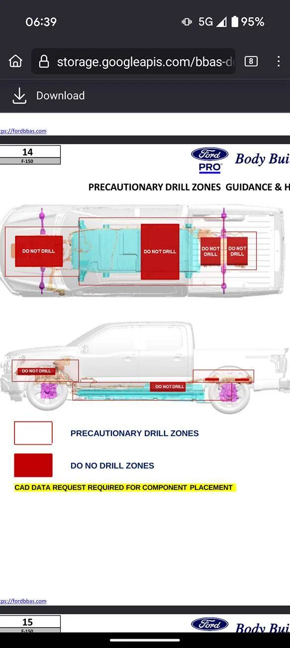

How much space is between the cabin floor and anything underneath it? Like the battery. If I have new subwoofers installed, how do Instruct the installers about safe installation?

There exists a "modifier's manual" (my term) from Ford issued for our Lightnings. I've seen it on this forum although I can't recall where. It is intended as factory guidance for body shops. I'm sure it would have appropriate under-cabin guidance You're seeking.
Is this it?
