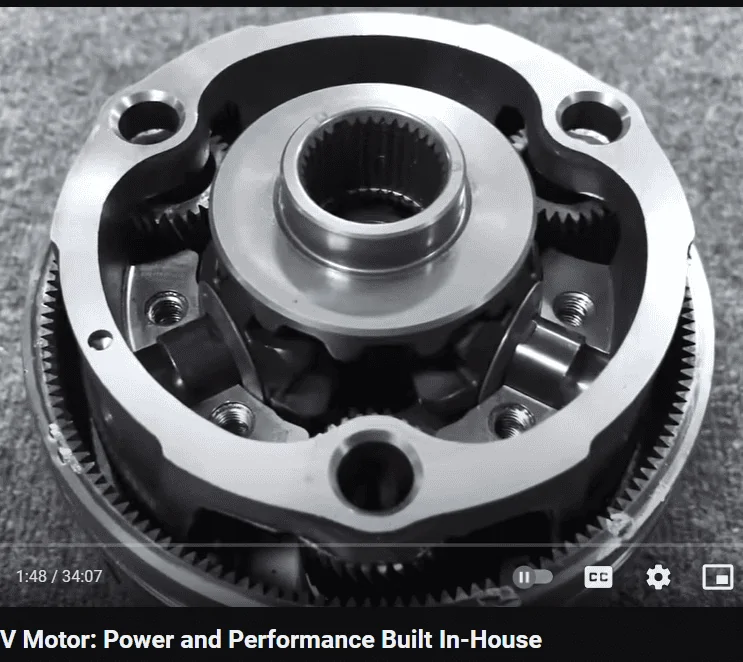

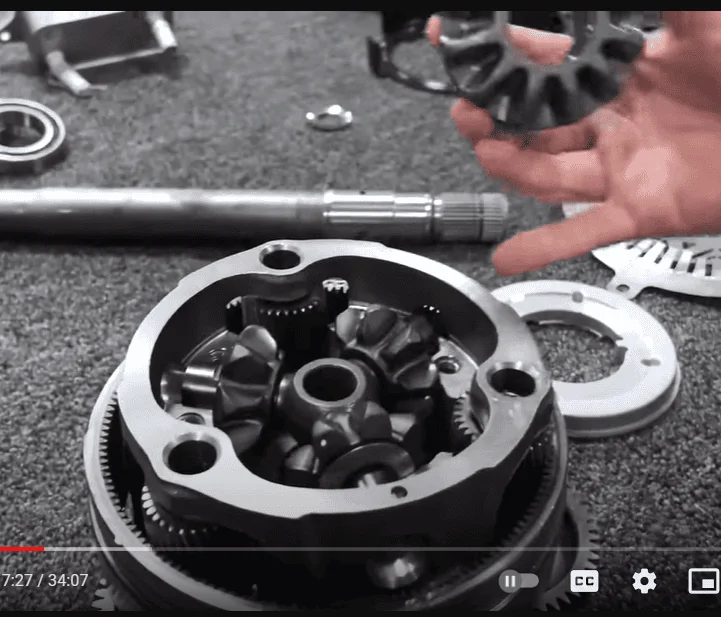

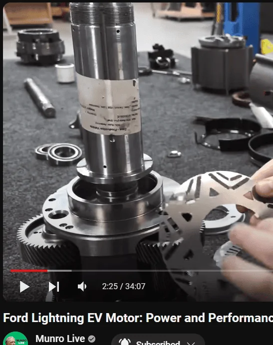

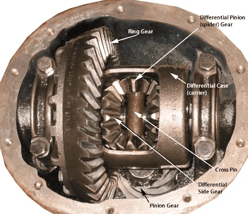

The differential planetary gears will be overworked on the axle with dissimilar diameter tires.
Lightning motor planetary gear sets:

Traditional rear end
