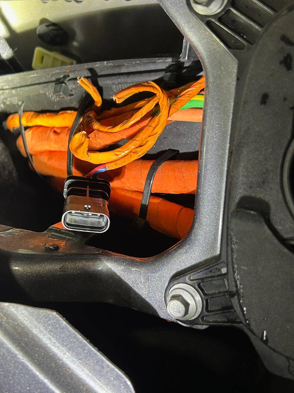

The other day, I walked out to my truck in warmer (40 degree) rain after a week of sub-freezing temperatures. I saw some chewed up acorns on top of my rear passenger wheel. I instantly had murderous thoughts about rodents. The first few months I had my truck (Sept '22), I had found a mountain of acorns and shells on top of everything behind the access panel in the back of the frunk. A shop vac had cleaned up most of that with no adverse consequences. Well...this time was different.
I got into my truck and started driving and about 5 minutes from home, my watch buzzes at me that I have a message. It says something about powertrain failure as a message from the ford pass app. I didn't have any reduced power according to the dash gauges and the truck drove just fine. I had already forgotten about the squirrel nuts on the tire. I drove it the rest of the day with no issue other than the wrench icon and request that I take it in for service as soon as possible. So I took it in the next morning.
The service advisor told me that they wouldn't be able to look at it until the next day, but because I pointed out some recall work that it needed, he wouldn't have any problem providing me with a loaner.
NOTE: Prior to them determining whether a problem you're having is covered under warranty, they're gambling providing you with a free loaner. I think I'll save up my non-critical recalls for visits like this to ensure I have the best possible chance of being put in a "free" loaner truck.
Last night I got the email from the dealership that it's rodent damage to the charging wires. It's a little over $1100 in estimated cost for them to manually repair the damage (they're not planning on ordering a new harness and believe they can repair it). Once it's repaired, they'll run diagnostics again to determine if there are any more faults contributing to the "powertrain malfunction" and will submit them to Ford if applicable.
For some reason, I decided to overpay for auto insurance 5-10 years ago and only have a $100 deductible. They cover damage caused by animals and it's a no-fault claim. So I'm starting with that route and they don't mind me using the dealership to perform the work. I'll update here as things progress. In the meantime, I'm going to incur the ire of my neighbors by killing some squirrels.

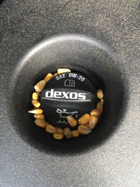

I worry about that even though my truck parks inside the garage.... I found the below a few years ago when raising the hood on my wife's Equinox after it had been parked inside her mother's garage for the weekend (they used to buy corn by the bag to feed the deer out in the backyard), so those little buggers get everywhere!
Ford F-150 Lightning Squirrel Chewed Through Charging Wires Equinox_Corn.JPG
I just checked the 12V battery area of my truck a couple weeks ago, as I'd seen another post like the OP made here, and thankfully the platform where the 12V sits was nothing but a big layer or dust with no critter tracks or disturbances at all (and hope it stays that way).
