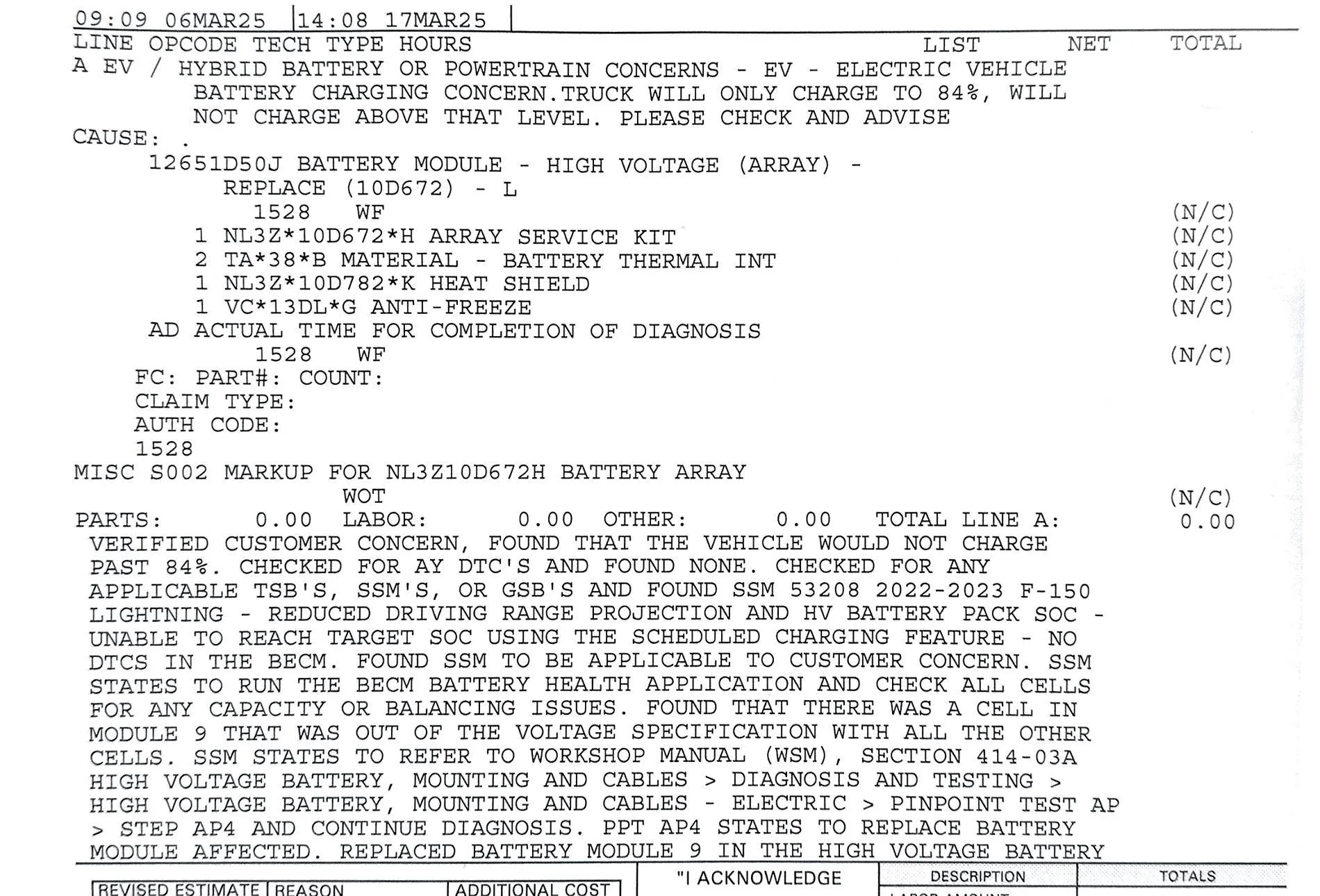

Update: Took truck to the dealer yesterday, was diagnosed with a bad module that will need to be replaced and I shouldn't drive the truck until it's fixed, so they gave me a loaner. No estimate yet on when new module will arrive, could be weeks.
This is my second module replacement, the first one (over a year ago) I only found out about because Ford emailed me to let me know that a single cel in a single module had a bad voltage reading, which they determined by over the air diagnostics. It was still charging to 100% at the time so nothing seemed wrong on my end. You would think they could have proactively diagnosed an entire module not working this time around, would have been nice if they did instead of me wondering WTF was wrong with my charging for a few weeks, attempting voodoo fixes, and then taking it to the dealer for the diagnosis which took an entire day.

Got my Lightning back today, they replaced Module #9 (on warranty of course). My previous module replacement (March 2023) was Module #8. I wonder how many others have had more than 1 replaced??
