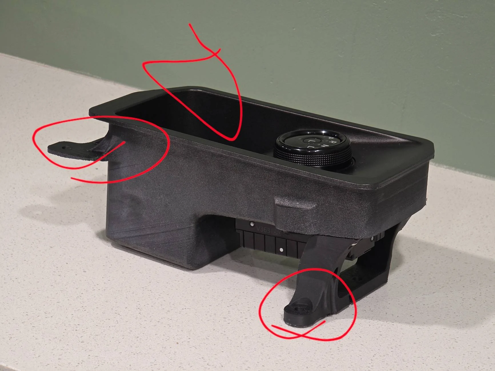

Here's my shifter setup...
I didn't necessarily like the existing designs as they were a bit "chunky" and made an attempt to get it more OEM looking.
BIG thanks to @ENDianDigital, without his design/kick in the butt I probably wouldn't have done this, it started as a few mods and turned into a complete redesign.
Main differences are that the shifter is located at the front (the cable is long enough if you cut/push out the strap holding it to the side wall).
The shifter is tilted 10-15 degrees.
You dont have to cut the tabs.
It accommodates the Escape and E-Transit shifters.
I ended up using the E-Transit shifter, being black, it doesn't stand out as much as a chrome would.
I painted the tub with a graphite metallic and dusted it with flat black to try and match the color/look of the cup holders, followed up with a matte clear.
And, yes, I'll post the drawings, this was basically the prototype and theres a few changes that I'd like to make before posting them.

So is it just using the back two bolts and the pressure of the trim piece to secure it in lieu of the front console bolts?

I feel kind of dumb because I have no idea what you're referring to.
The "tub" is using the back two bolts and the front right one to secure the tub.
I have a hole for the front left one as well, but the shifter connector is right above the bolt so it's too tight to get a screw/tool in there.
I did do a reverse bolt and got it attached from the back side / underneath, before realizing it was a really bad idea and that any dealership coming up on it would hate you forever, so I took it out and that one front, right, bolt holds it just fine.
The shifter use all three mounting points, I got a thread insert thingy for my soldering iron and pushed in three M4 inserts. The shifter is TIGHT so you may not have to secure it further, I just figured better safe than sorry. But I ran a PLA print for 2w without securing it and it was just fine.
Hey, yeah sorry, I totally missed that front right bolt hole in your original pics. Yeah, that would totally be sufficient from what I've seen.
My mistake; sorry for the confusion!

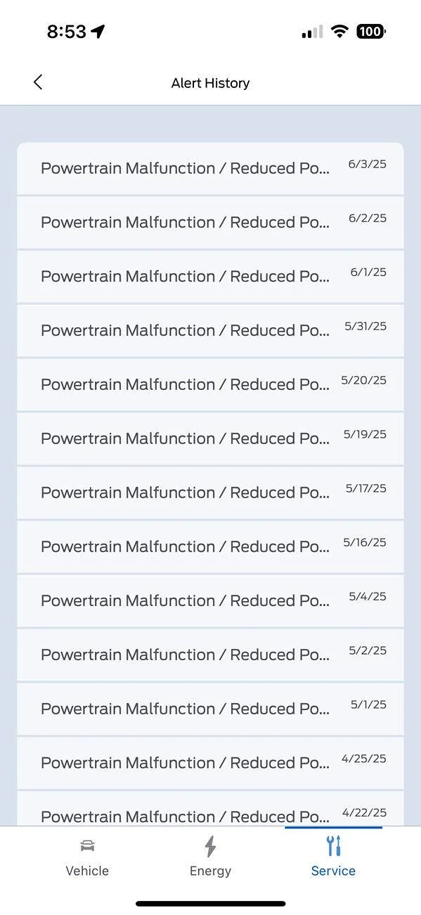

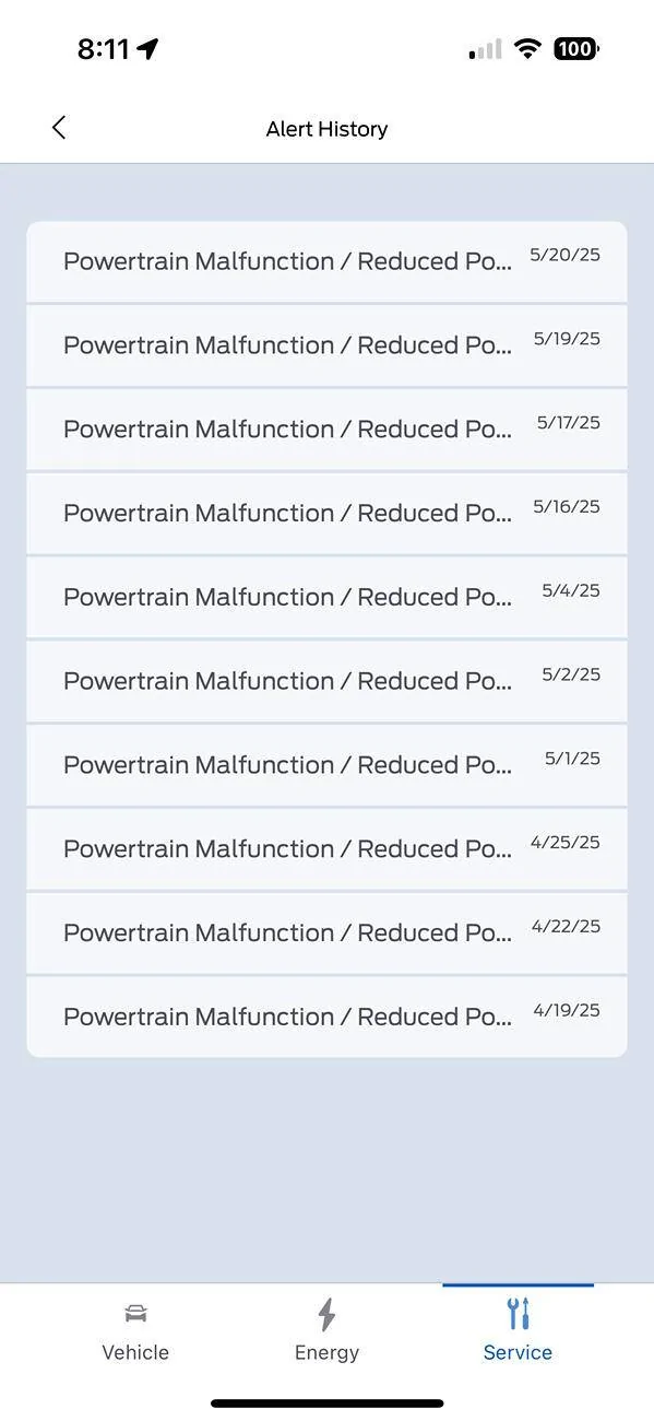

I started getting the "powertrain malfunction" notice on 4/19/25 and it was there for a few days then disappeared for a week or two and I thought things were good as if an OTA update somewhere had suppressed the warnings -- but nope, it came back and became more frequent and over the last few days it was an everyday thing.

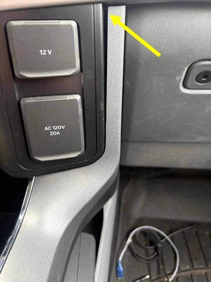

It was kinda tough to get the side trim pieces back into place properly and I'm not sure they went in perfectly, as there's a bit of a gap on the right side -- unless maybe that was already there and I didn't notice?

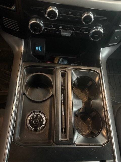

Anyway, here is a pic of the finished product. Yes I know that the pics show how dirty the interior can get with daily commuting (mine is almost 2hrs each way), but my priority was to get this swapped out and worry about stopping at the car wash & vac later. I'm also going to get a small round piece of rubber to act as a coaster and cover the bolt head in the cup holder of the printed base.
Ford F-150 Lightning Stick to Rotary Shift Knob Conversion w/ 3D Printed Rotary Shifter Holder IMG_0186
End result: truck started normally, and no more wrench light!
