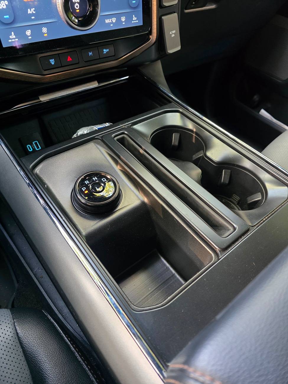

Here's my shifter setup...
I didn't necessarily like the existing designs as they were a bit "chunky" and made an attempt to get it more OEM looking.
BIG thanks to @ENDianDigital, without his design/kick in the butt I probably wouldn't have done this, it started as a few mods and turned into a complete redesign.
Main differences are that the shifter is located at the front (the cable is long enough if you cut/push out the strap holding it to the side wall).
The shifter is tilted 10-15 degrees.
You dont have to cut the tabs.
It accommodates the Escape and E-Transit shifters.
I ended up using the E-Transit shifter, being black, it doesn't stand out as much as a chrome would.
I painted the tub with a graphite metallic and dusted it with flat black to try and match the color/look of the cup holders, followed up with a matte clear.
And, yes, I'll post the drawings, this was basically the prototype and theres a few changes that I'd like to make before posting them.

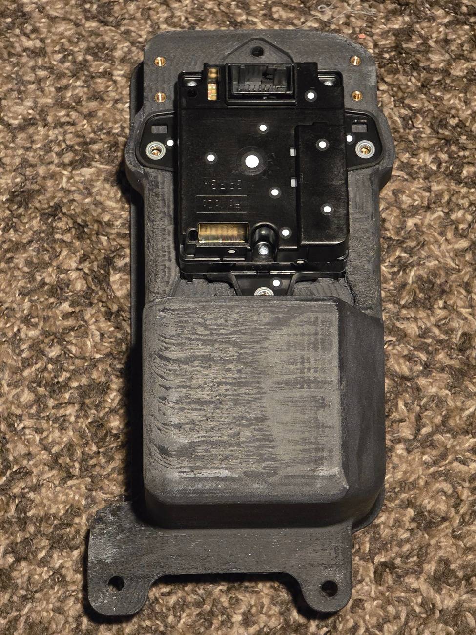

DId you ever finish share out the file for this one.

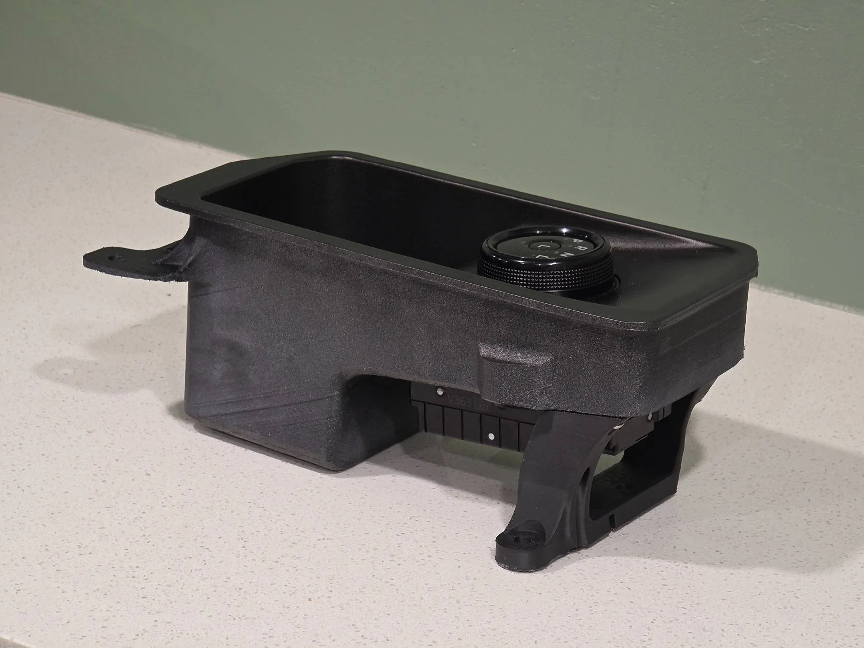

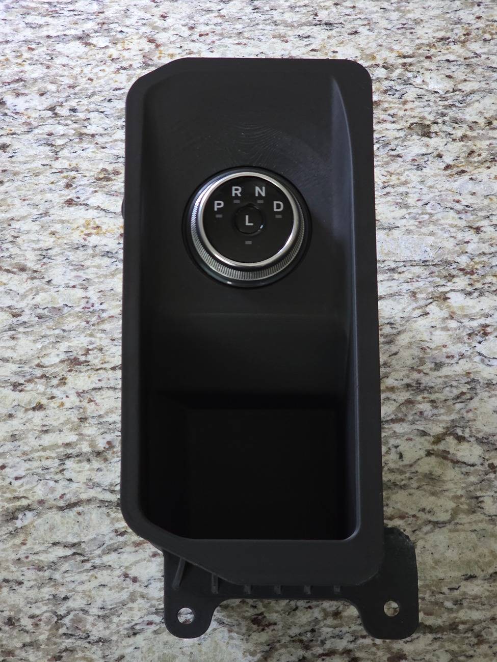

I didn't, well, until now that is.
My first print turned into a birdsnest halfway through, so I had to start over.
I modified the tub slightly so that it accepts the Bronco shifter as well, top one is Escape and bottom is Bronco (same tub) and it also does E-Transit (which is the one I'm using). Escape and E-Transit fits better due to their chamfered top whereas the Bronco shifter is straight, so visually there's a slightly bigger gap around the knob.
I'm using M4 metal inserts from this kit >> https://www.amazon.com/dp/B0CPVCTXJ7?th=1
Others may work, but this is what I used on mine. I'd use flanged M4x12 screws, but regular M4+washers is OK too.
When mounting it in the truck you need to undo the gray plastic clip in the back left hand side wall holding the cable in place. Because the support bracket end up right behind / underneath the connector you also need to plug the cable into the shifter before you attach the front support.
For the very same reason you can't use the center mounting bolt, it's too tight to get to it (at least for me, but don't worry, it's not going anywhere with the three that's there.
If you feel generous, go here >> https://www.thingiverse.com/thing:6978586/files and tip @ENDianDigital, it's only because he started it and was kind enough to publish his step files that I even thought about doing this, so credit goes to him.
This ZIP-File has the Step files and the STL files that I used to print the one below.
I'm by no means a mechanical designer, so this isn't optimized for anything except that it works for me. My print took 60hrs (0.12mm layer height and 20% infill), so be prepared to wait.
Ford F-150 Lightning Stick to Rotary Shift Knob Conversion w/ 3D Printed Rotary Shifter Holder 20250611_172008
Ford F-150 Lightning Stick to Rotary Shift Knob Conversion w/ 3D Printed Rotary Shifter Holder 20250611_172638
Ford F-150 Lightning Stick to Rotary Shift Knob Conversion w/ 3D Printed Rotary Shifter Holder 20250611_172538

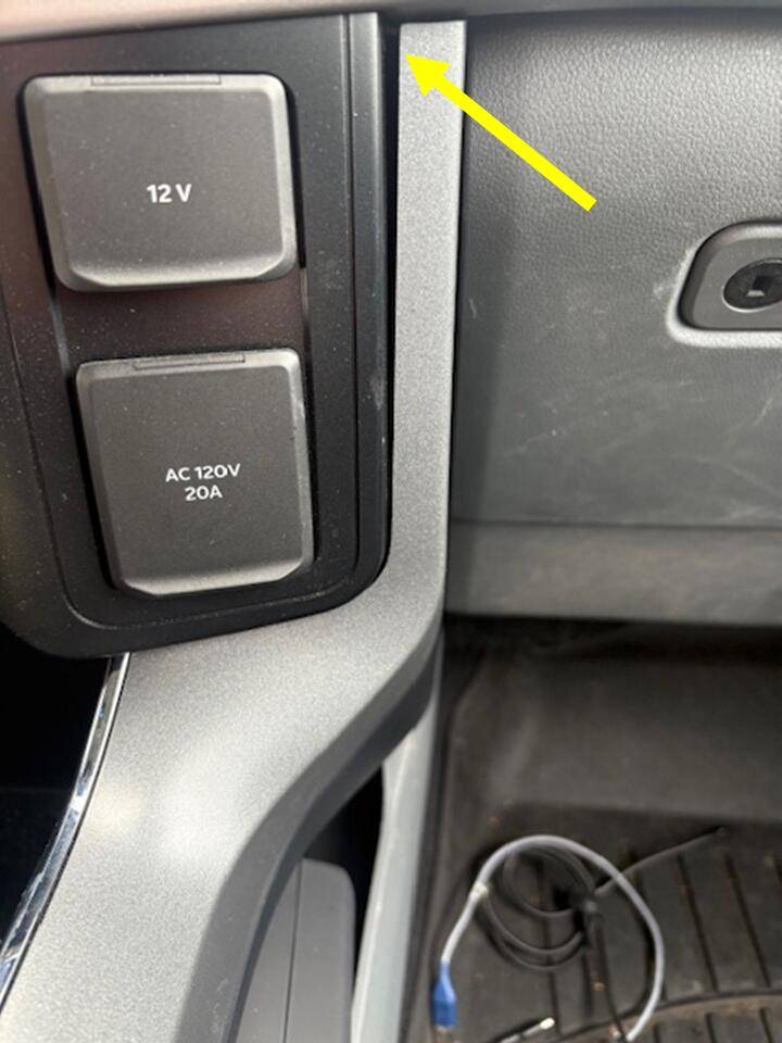

This has to be the best mod you can do on the Lightning! Thanks to Thanks to @Drayday55 for printing it for me his version which is perfect. Also the under seat air vent extension and Frunk button cover. The air extensions worked well for my
One note on the install, when taking of the center trim piece the video shows to pull towards but there is a plastic pin in a hole that needs to be lifted up but the center screen is blocking it from coming out of the hole it is in. You have to pry the hole down and the pin up to get it out, I also put a L- wrench in the hole once I had the pin out of one side to keep it from popping back in while prying the other side out. If you just pull I'm sure that pin will break, although not a big deal as it's probably not needed.
