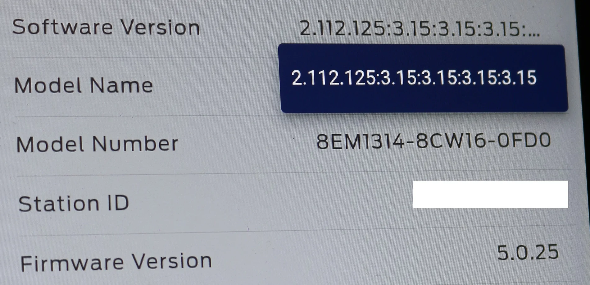

IF you can see you firmware/software versions ("About") this is the version I had when the app completed the setup step of adding the FCSP to FordPass:
Now March 16, 2025
Software: 2.112.125.3.15.3.15.3.15.3.15
Now April 12, 2025
Firmware: 5.0.25

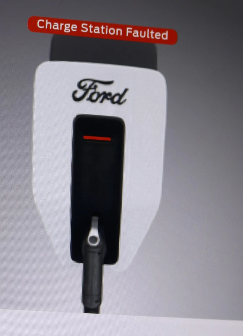

Last night I noticed that I had messages on FordPass that my FCSP had faulted and was unable to charge my Lightning.
The messages headings were: "Something went wrong with your Charge Station" at 4:23AM Sept 9.
and at 6:43PM the same day. However it did charge my truck just fine the day before on Sept 8, and no charge session was happening on the 9th.
The body said: "Something went wrong and your charge station can't charge your vehicle. Open your charge station settings for more information."
Nothing in the "settings" that I could see. But there is a big red banner that says: "Charge Station Faulted" above the image of the FCSP when I first open the tab for the FCSP.

When I look at the Setup and Configuration, and open the FCSP setup, manage settings, I see nothing out of the ordinary or unusual. Software and Firmware seem to be the same as at the last update"

There was a short utility power glitch the other day, maybe there were two at the times specified in the fault notice? I would not have noticed the 4:23AM one of course.
Very strange.
