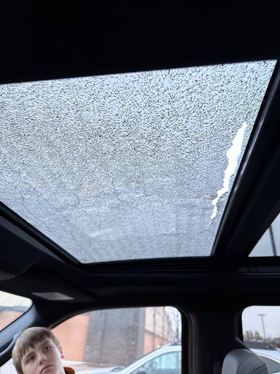

I called the dealer again and told them I need them to replace the track to make sure I don't have bits of glass that will eventually destroy the mechanism. Going in tomorrow for evaluation. I'll report back.
It took a week in the shop, but the dealer replaced the sunroof. They pushed back on the warranty telling me there was a 99% chance it was a rock that caused the sunroof to shatter. However, since I had taped the entire sunroof together after it shattered, and they were unable to find a chip anywhere in the glass, it was replaced under warranty. Problem solved. No insurance claim.
Did they replace the entire rail system or just the glass?

I'm pretty sure the headliner will have to come out for the replacement, so not just a 1 hour repair.
Nope.
4 bolts and a simple alignment.
.5hr labor.
