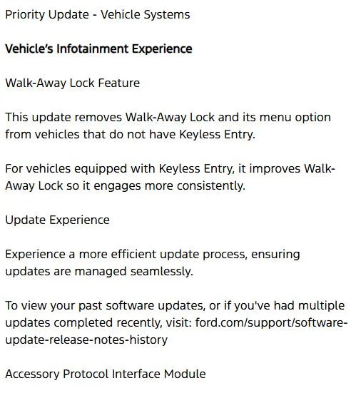

Would you mind sending me your vin. You have a 24 that shipped with it so I would like to see the files for the update

Thanks. This is actually an APIM update. Its the same as the 24 Mach E started getting.
I thought it would be a BCM update but this must be geared for the early trucks to add the WAL toggles.

I got this about a week ago as part of the frunk update. I reported that it doesn’t work. I received and email explaining that a fix will be released later. Hopefully this is it! Eap.

In the Mach E, the OTA is called SYNC-25.2.1.6.5 and updates Sync to version 25095.

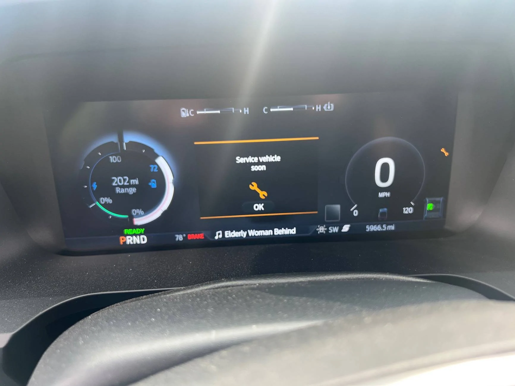

Ouch, that stinks. Try a 12v reset by pulling the 12v Negative at the LVB. That (hopefully) will refresh all your modules.

Just called the dealer. They said it’s a P0929 error and that it requires an update. Said it’s ok to drive until I get it there on Monday. I think I will try to reeet the 12v this evening when I get home.
You have a great dealer!
