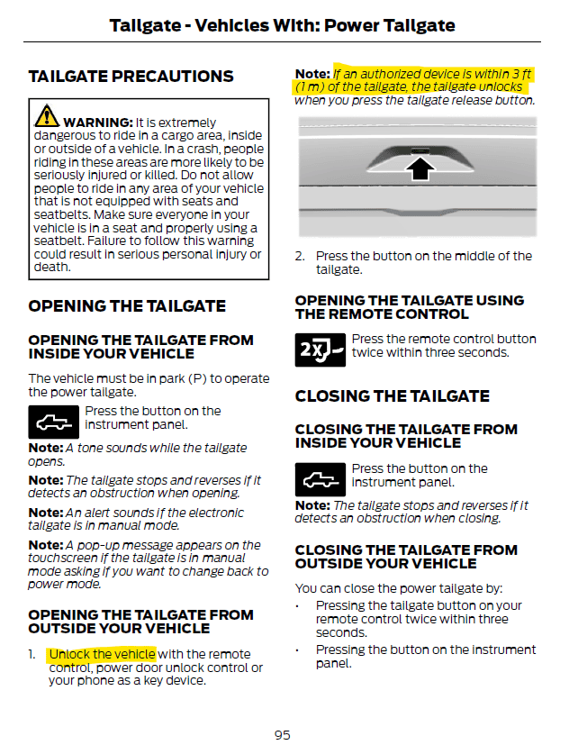

Monitor your use of unlocking the truck and or reliance on PAAK to allow the tailgate to unlock and allow opening, I suspect it's warning you that opening conditions were not met. This could be as random as when PAAK / FOB reader is late recognizing your presence.
Ford F-150 Lightning Tailgate triple beep 1701788103490
That all seems to relate to starting the process when the truck is locked.
The OP stated that his truck was not locked. I randomly have this happen as well. My truck sits in my locked garage, truck is not ever locked, fob is in the cup holder. If I press the button on the tailgate, it might open, or it might beep at me. When it beeps, I have to press a second time to open.
It’s almost like sometimes, the truck is “asleep” and the first press is needed to wake it up?
I was composing my reply with research while his follow-up posted before my final cut.

Same - I always thought it was an issue detecting the key fob.
Fob shouldn’t be required when the truck isn’t locked.
I’ve had people open the tailgate when the fob and I were about a mile away and the truck was unlocked.

Mine does the same 3 beeps on the 1st push, but I am ok with it. Could it be a safety/scratch warning feature? I park the truck in the garage about 12" from the garage door. If someone accidentally hits the rear tailgate button, I would not want it to open the first time since it would open right into the garage door.

Mine did the same. I watched it while doing it and it seems the motor always “closes” it prior to attempting to open it. I also noticed that the bedliner made the bumps protrude out enough it was impacting the system wanting to release and open. Reduced the liner back to the paint at the stops and now it opens fine but still try’s to close first?‍♂
