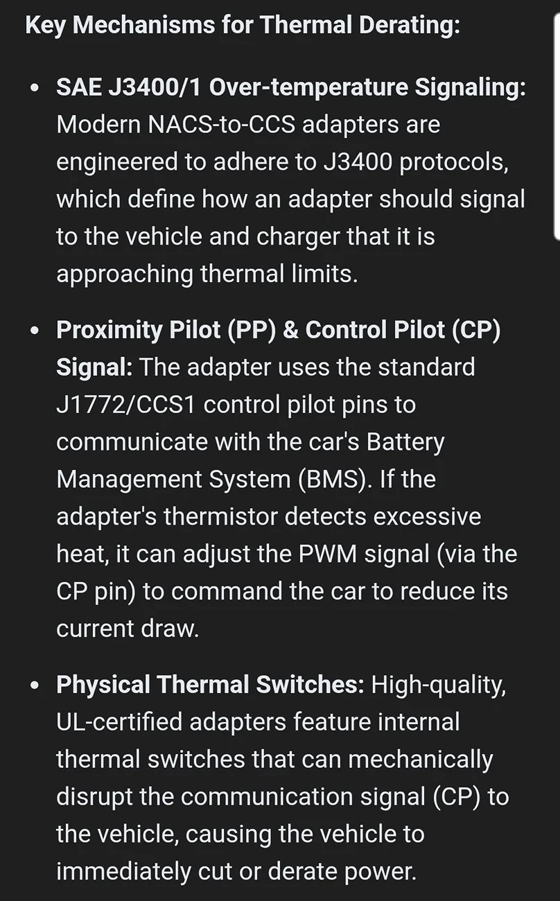

All adapters that intend to be UL listed can derate.
Thanks. That image in your response kind of smells like AI, which I do not trust as far as I can throw it, but it does make sense J3400 would include some provision for it.
The teardown of the Lectron unit I did force myself to watch did include a couple of resistors as well as the thermal switches. So perhaps that's the signalling, to add some resistance to the circuit somewhere. It was certainly rudimentary.
Seems like the J3400 standard itself is paywalled; I can't seem to find the details. In particular I would like to know if the *truck* can detect if the adapter is getting hot, or whether it's strictly between the charger and the adapter. Doesn't matter much in the end I suppose. But I would like to fully understand how it works. I don't want to be giving out bad information.

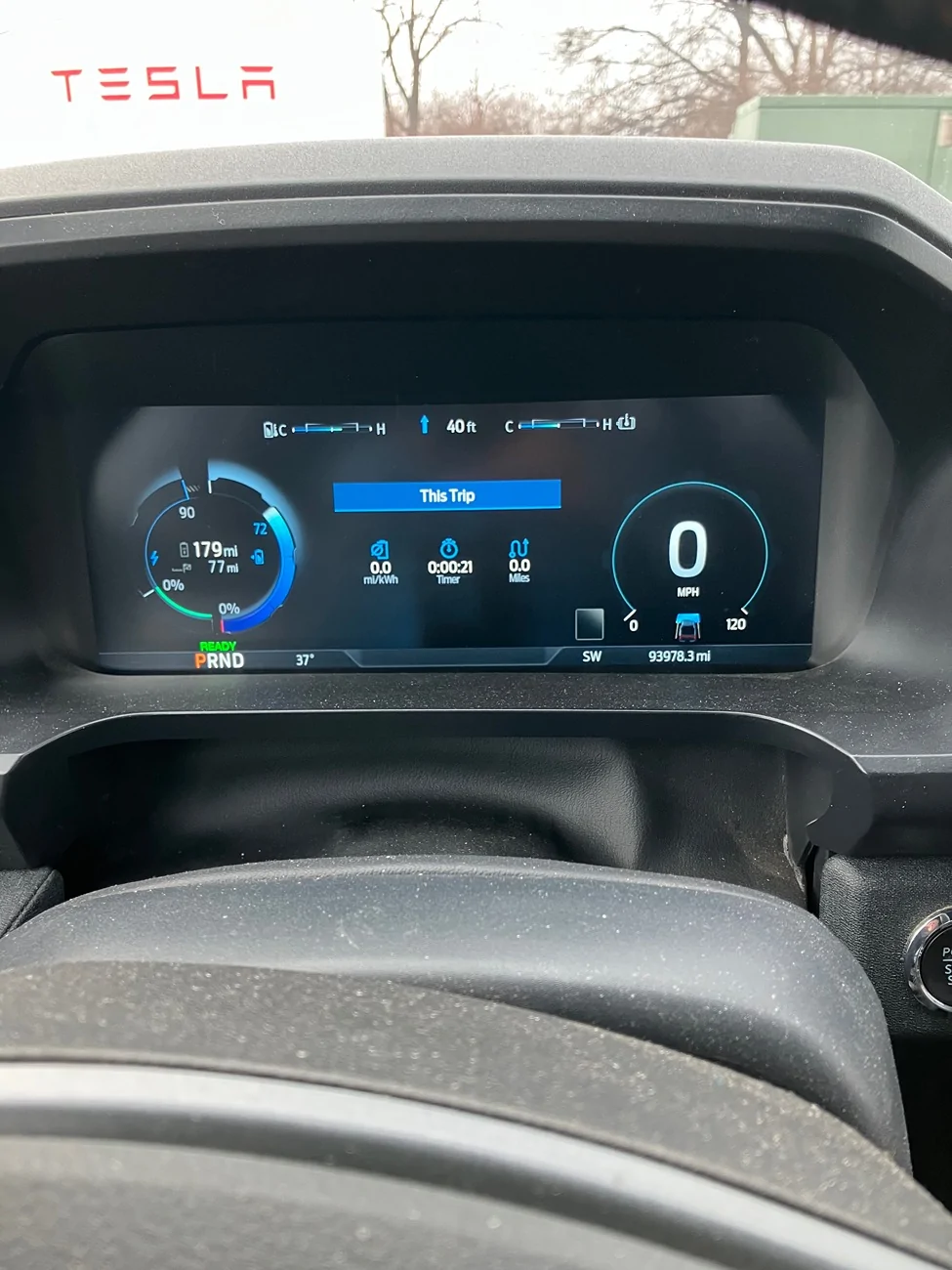

Did you happen to look at your battery temp gauge immediately after charging? The truck doesn’t show the gauge while charging, but when you go to drive away you can take a look. I have been noticing elevated battery temps after my second or third DCFC in a day on road trips. The elevated temperatures correspond with slower charging speeds. This started happening last summer on a road trip through the west. It was 114 F ambient temps in Kansas, so I assumed that was the issue. However, that evening I charged in Denver at 60 F and experienced the same issue. I have been working with my dealership ever since to try and resolve this, but the issue remains and even happened in February on a road trip to Vermont with ambient temps near freezing.
I’ve been working with the dealership, but after replacing cooling valves, a battery module, the charge port, software updates and various inline sensors; the issue remains. While the temps return to the dead middle shortly after driving, I am concerned that at 90,000+ miles I have an unsolvable battery/powertrain issue as I approach the warranty limit.

Yes it was an AI response, sorry I usually caveat that when using such responses wholesale. I didn't have the time to properly research how adapters control charge rate despite being passive. I think the pertinent bit of data is that the spec says (at least according to AI, as I also don't have access to the standard) the adapters control the signal that goes to the car. There is no communication directly with the charging equipment. It modifies the control signal to the car telling it that things are getting toasty and to slow down the rate. From what I gather, it just needs to modify the duty cycle of the PWM indicating that a lower max current is now available. The car then sends a signal to the charger requesting the lower rate. That can be done with passive bits and bobs.
After the second charge of the day (middle of the afternoon at 90+ degrees), the battery temp was slightly elevated (less than your photo above). It had cooled a little when I did the third charge (the one with the somewhat reduced rate), and was right back to the middle line for the fourth charge (fastest of the day).
That was the first time I had ever seen the battery temp above the middle line.

Thanks for the reply! It makes me feel a little better that other Lightnings are also seeing some temperature elevation during multiple DCFCs. I did mention to the EV tech my theory that this might be software related and not a bug, but a feature. I don’t remember exactly when, but it was before I noticed the temperature changes, the truck seemed to have an increase in peak charging rate. When I first got my truck in 2022, the highest charge rate I ever saw was 173 kW/h. Sometime about 2 years ago or so I noticed that my peak charge rate was consistently higher for the first 6-8 minutes—pushing 180-185 kW/h. I sort of remember someone on this forum talking about a software update that raised the peak charging rate. So if that is true, it may be that they increased the charge rate and the cooling algorithm didn’t get updated. This would be fine as the charging speed is better in your first charge of the day, but you may have issues on the follow on charges. My tech didn’t hear of anything like that, but said he would ask the engineers when he spoke with them. I don’t know if he actually did.
