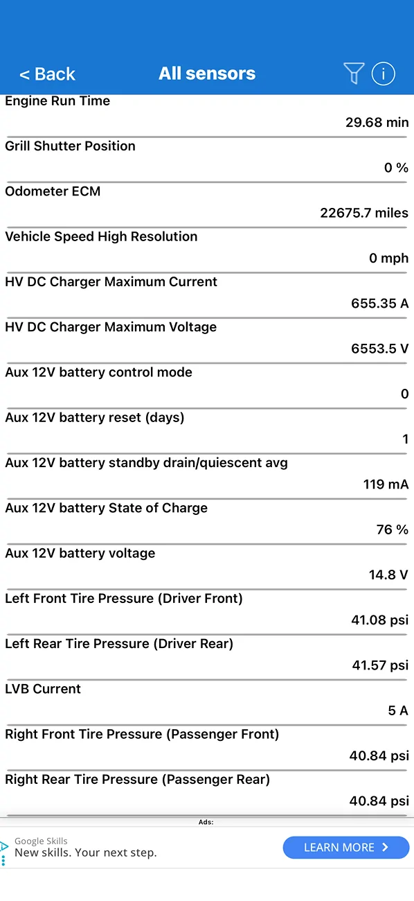

Here's a couple more pics I took with the "new" battery in and the truck in that blinking accessory only mode. End result, I took the battery back to Advance Auto Parts, they tested it and showed it was 12v and fine so something in the truck is making it tank. Calling Ford now and I expect to not have a truck forever. I'll update with the resolution when they tell me.
looks so so for the draw, but turn off the seat heater, heated steering wheel and possibly the pro power, mostly for good measure, whatever you're looking for uses about 300w on the 12v circuit so in theory it should be relatively obvious. The SOC is low, I don't know how the truck calculates SOC for the 12v, but others suggest a reset which it seems you performed. Next I would charge it with an external charger. As far as battery testing goes, what was the old battery type? Lead acid and AGM are mostly accurate to testing. I've had one false positive in 25ish years. Lithium chemistry and possibly other chemistries don't test accurately with traditional battery testers.
Edit: Also put it in run to see if the DCDC is even attempting to charge the battery.

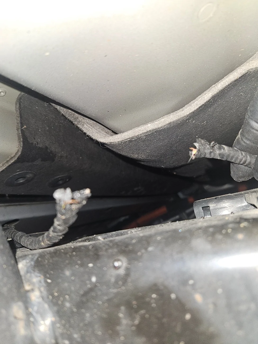

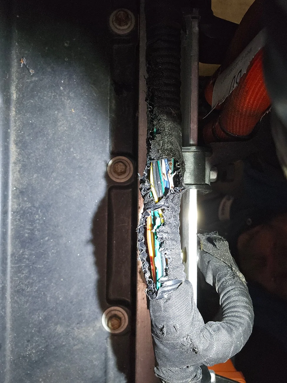

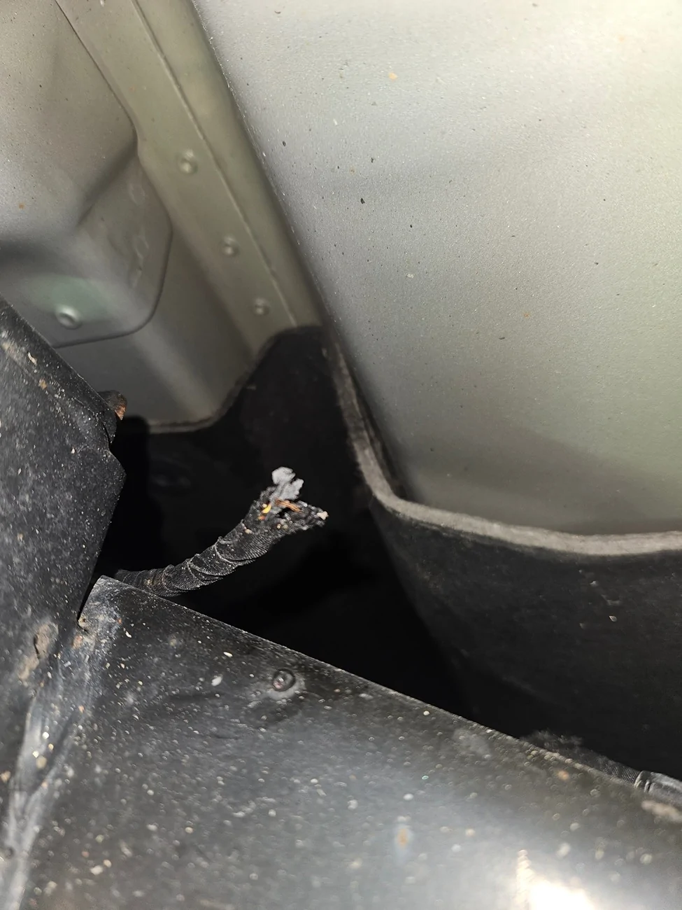

Well this is a twist I didn't see coming. $2k worth of rodent damage. :sadface:

Oh jeez... yeah it's the beginning of Winter and based on Your location, the little guys are now all looking for shelter.
They did a darn good number on Sonny Boy's Ford Fusion Energi in his Kentucky garage a few years ago. Them Kentucky mice are a tough crowd.
What is the chewed-through location on the truck? I want to be watching... we're going up to Canada soon for several weeks, so...
Intellibeam
Intellibeam
Jul 18, 2022
Massachusetts
2022 Lightning Lariat-ER Iced Blue Silver
Here's the report from the dealer:
Found rodent damage in 2 places on under side of vehicle. Found harness along high voltage battery support and near rear right of vehicle are chewd on. Recommend lowering of harness along support to repair and repair of harness near rear right.
