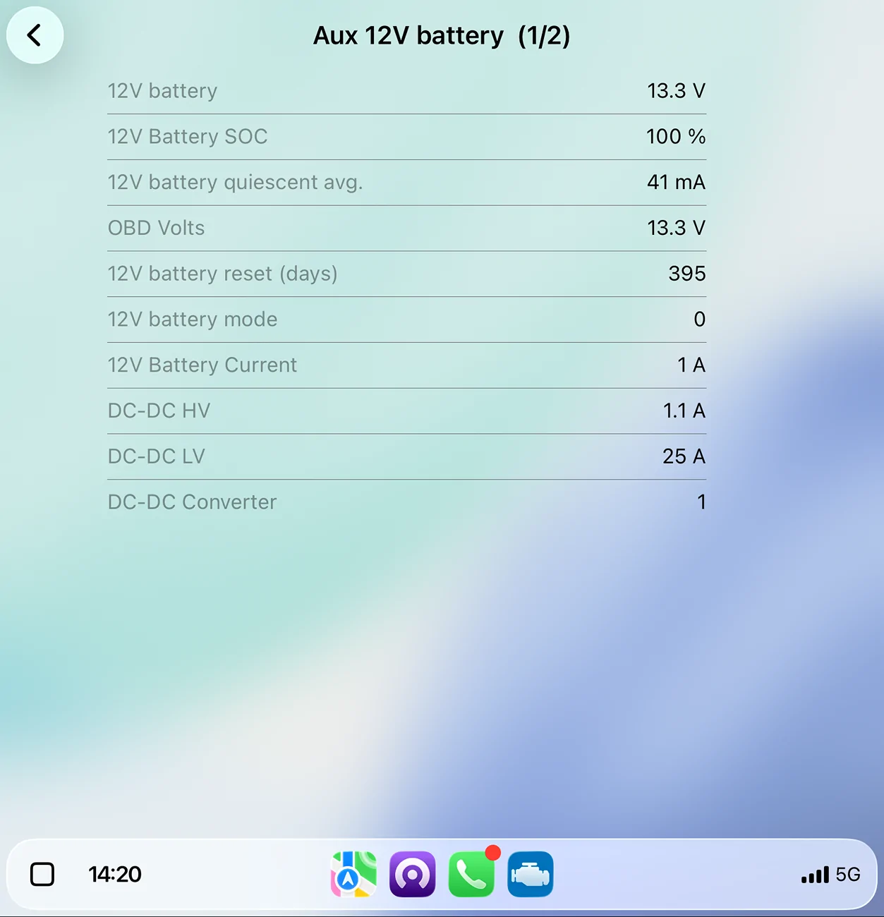

Here's one for the 12V battery guru's. Software Update PT-25.13.12 "Charge Port Functionality & Cold Weather Performance" has been failing each night for a week or so. Looking at Car Scanner, the 12V hovered around 80-90% in the morning when I'd see the failure notice for low battery.
Based on a couple comments here I picked up the Noco Genius1 and used it to get it up to 100% before the update started. First screenshot is seconds before I manually started the update and the second is 2 hours later when I went back out to the truck to see it failed. Topped if off again to 100%, started the update again, waited outside and watched the countdown timer and then the "Preparing Update" screen was up for ~90 seconds before the failure notice popped up and then turned off.
The truck was built 11/23 and as far as I know (bought used), this is the original 12V. Thoughts?

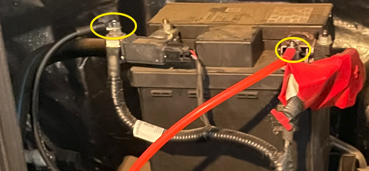

You may have hooked the NOCO up to the wrong negative post - it has to be downstream of the BMS sensor or else the system doesn't know the battery has been charged:
Ford F-150 Lightning Update postponed due to low battery IMG_6024-battery BMS sensor
Also be sure to use the 12V AGM mode on the NOCO.
But there is a whole list of other ways to charge up the battery to get updates - charging the HVB from 70-80% overnight at about 32A worked for me before I had the battery maintainer.
If things are hooked up correctly and your battery still won't hold a charge, could be you need a new battery.

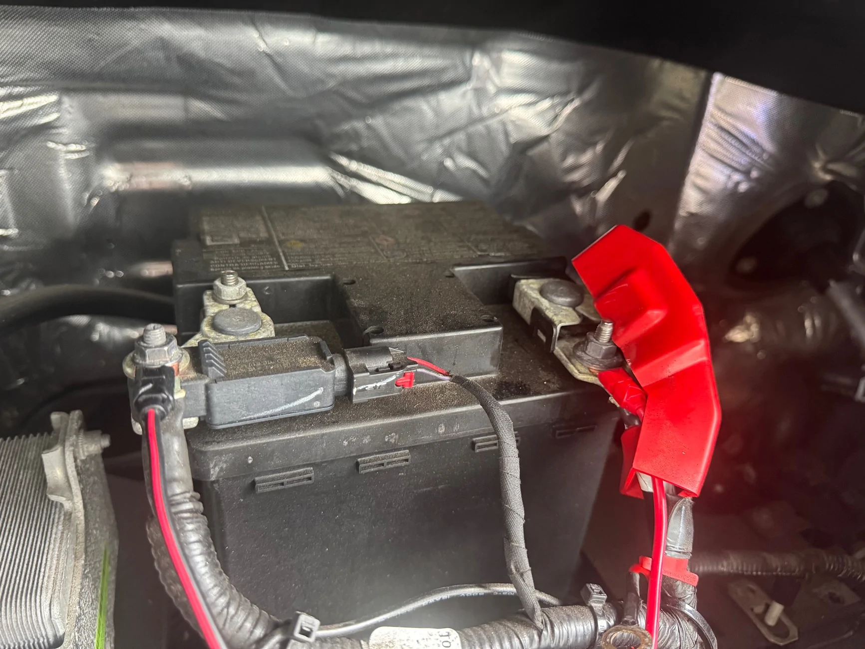

It’s downstream of the BMS and set to 12V AGM, I think? I tried all of the other strategies to get it charged before buying the Noco as the last option. Guess I’ll make an appointment at the dealer since the truck is well under 3yr/36k.

You might check if the NOCO *thinks* the battery is charged, will it then actually turn off and then periodically check. I have a Clore with this "smart" technology and disappointed it actually turns off at full charge. These smart types are more useful for long-term storage (months) IMHO. Battery Tender Jr. is a good model that has a true float mode after charging.
I have better luck doing the following:
1. Turn the truck on and disable 30-minute timer, HVAC, radio etc. Let it run 6+ hours in the evening.
2. At the same time have it on a float charger (puts out a constant 13.6ish volts, not smart).
3. Make sure you disconnected all OBD dongles, dashcams, etc. Frunk is closed.
Then let it attempt the update overnight.
FYI, in your pic, it looks like you disconnected the truck's 6mm nuts to put the NOCO ring terminals on. A better idea is to get another set of 6mm nuts and put them on top of the existing nuts with the ring terminal between them. Saves you from actually disconnecting the battery each time.
