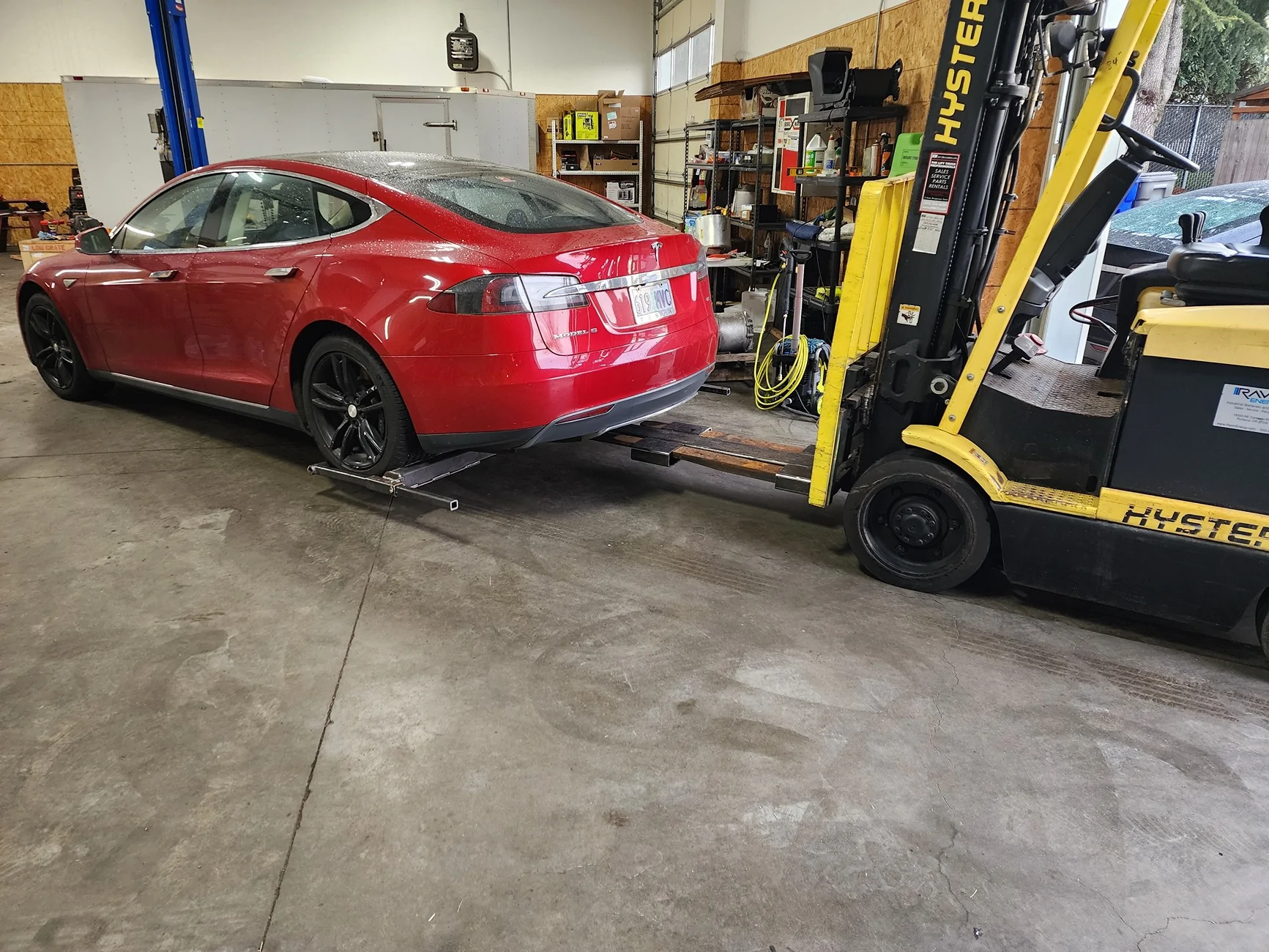

@ajbessinger awesome video and step by step guide! Also great to hear you’re headed to the east coast. How in the world did you get that giant pack off the pallet on the floor onto that rolling cart?
Best tool in the shop, forklift!

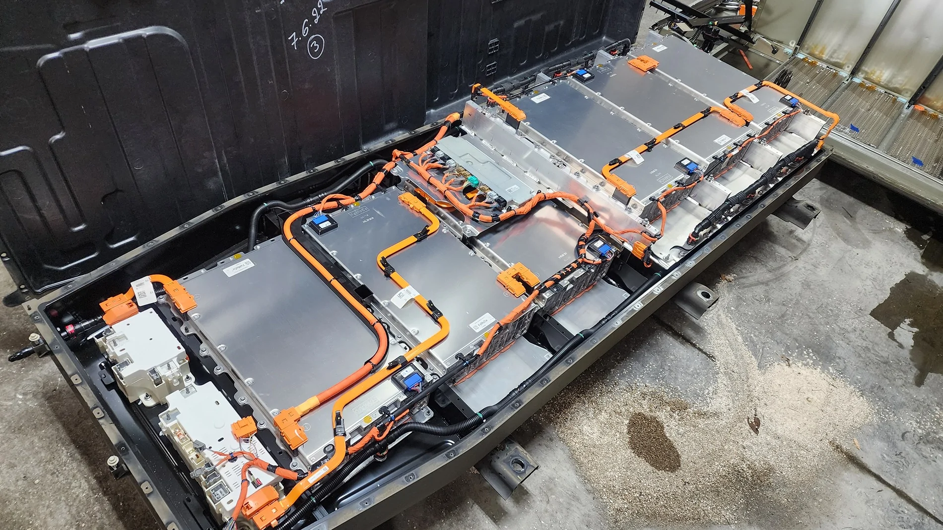

This is crazy, 100kWh of usable battery for 5K, that's like 1/20th the price of a Tesla Powerwall. ER packs are harder to find and will be closer to $10k.
So, is there a way to use the battery packs for home backup power? I know people have done it with old Leaf batteries and stuff, but how realistic is it for the SR batteries?
Each module is 10S (or 37v nominal), and 11.95kWh gross (probably closer to ~10.5-11kWh usable). You could stack as many as you want in series or parallel depending on your inverter's input voltage. Of course, you'd have to set up a BMS to keep the cells in balance, and prevent them from being overcharged or over discharged.
If you wanted to use a complete/intact pack, it maybe doable, but you'd have to decode and spoof the CAN signals to the BECM (factory BMS) using a CAN bridge in order to get it operating. There is an open source project for doing these types of systems and integrating them with different inverters, but the Lightning pack is not yet supported (Mach-E is though). https://github.com/dalathegreat/Battery-Emulator
If anyone here want's a cheap SR pack to play around with the good modules, I'm still trying to sell the old pack from the truck I upgraded in the video (8/9 modules are still good). If I don't find a buyer in the next month or so, then it's going to have to go to the recycler, as I don't intend to haul it to NC with all my other stuff, haha. I also have several older Model S packs in similar condition that need to find homes.
