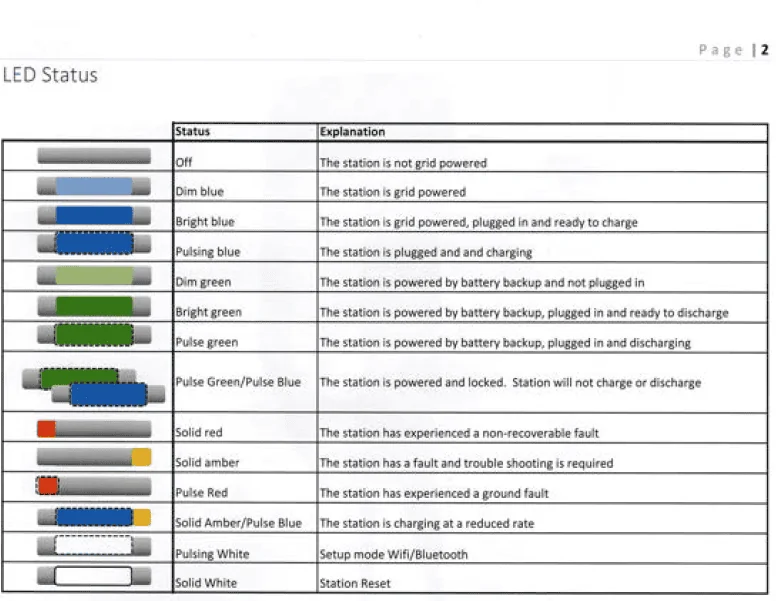

Doesnโ€™t the amber light come on when thereโ€™s an over temp condition?
Not sure, I never experienced the problem, mine updated within 24 hours of first power up.
The chart shows solid amber indicates fault requiring troubleshooting.
Third row from the bottom is what I was referring to. It will show this if you dial it down in the app, but I think it will also show if the rate is reduced by the FCSP for other reasons such as over temp.

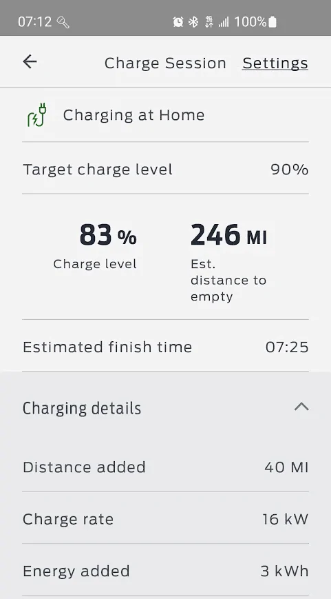

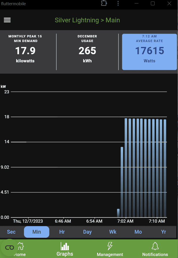

The FordPass charging information screen displays ~16-17 KW rate when I'm charging, while my Emporia Vue2 reports ~18KW rate, so there is a reporting inaccuracy on the Fordpass display, 12 minutes into the 7am starting time.

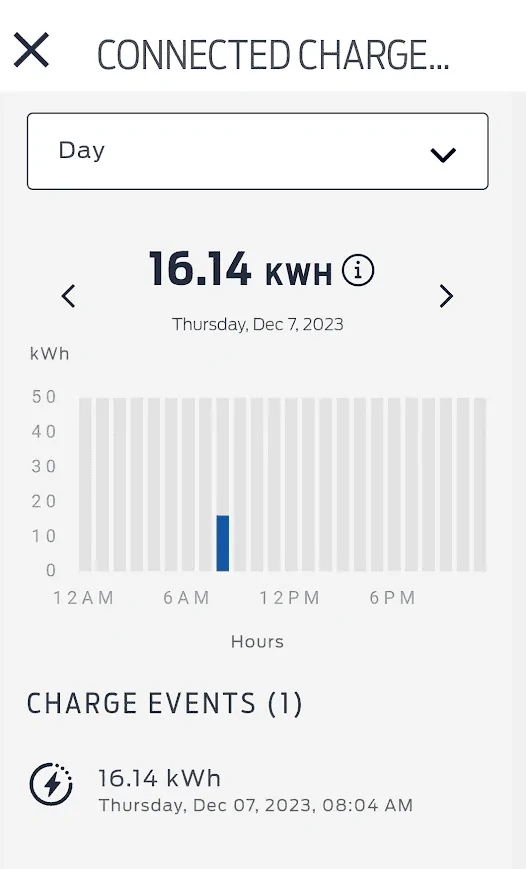

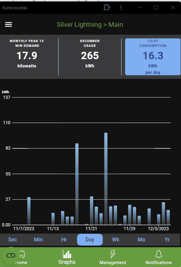

Total energy 16.3 KWH, or as reported by Ford pass Connected charge station report 16.14 KWH

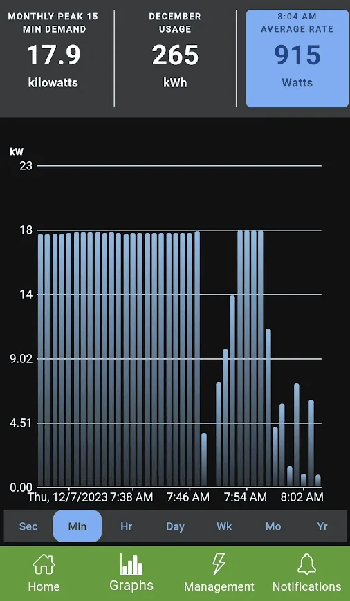

The session was 48 minutes of charging followed by 15 minutes of remote start warming.
This chart shows the end of charging followed by Remote start with a 1 minute gap
