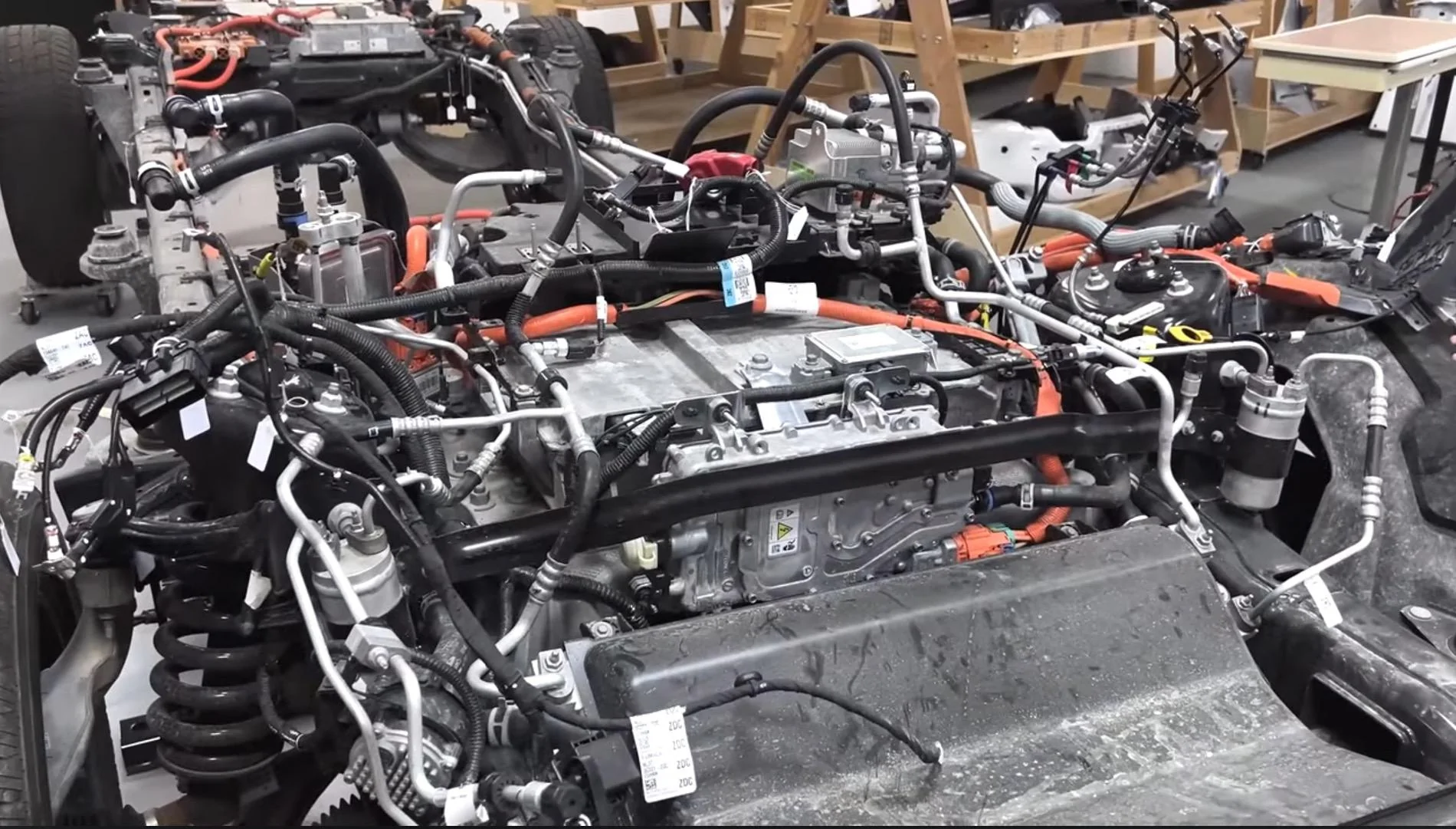

What is this under the frunk?

Take a look at this and see if it helps. This is from the factory shop manual with diagrams on how to remove the frunk.
Thank you for including that pdf., Don't need to tear into mine, but it's good to have, if I do...

Does that create an error code, or is that just the back-up noise maker??
Not certain, I still have mine active, those folks who have can give a better answer, I do know that some have created a sealed plug to go on the truck side connection to protect from corrosion.

My inclination would be to pierce the speaker, so it still makes a sound, but not a loud one.:bandit:

With mine, I disassembled the beeper, and stuffed the cavity with some higher density foam. It quieted it down a bit, but it was still annoying. Then I peeled the speaker off where it is mounted. It still actually beeps, but you only hear it if you really listen for it. It’s useful if I stupidly double-click the frunk button and am wondering what the hell is going on :)
To quiet it down a lot, all you need to do is peel the sticker off so it’s just floating. Once it has nothing to resonate against, it’s pretty darn quiet already.
closing it back up, I think I used some CA glue or something.

Can confirm that the newest update of the front hatch control module now throws a code that you can't clear . Kind of annoying since I disconnected my frunk beeper two years ago and the code shows up only after the March 2024 update. I don't feel like taking the entire front end of my truck apart again so the DCM will stay as a monument to the steadfast progression of technology (and my laziness).
Great idea. I like that solution better.
Three scrunched up biodegradable packing peanuts stuffed into the speaker hole does wonders.
