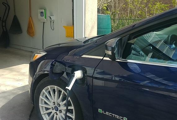

We purchased a Ford Focus Electric in 2017 and before we took delivery in the fall we chose an EVSE to purchase and install. We have a 2-car garage and the left side was being used by the ICE Focus we already had, so the right side would be home for the FFE. Also, the right side of the garage was an outside wall that had not been finished so it was open studs, and the garage subpanel is in the back right corner of the garage. This made for an easy cable run for the EVSE with only the last 18" or so having to be fished through finished wall to the subpanel.
The EVSE we got was a 32 A unit (about 7.6 kW) and required a 40 A breaker and #8 cable. We used an 8-3 cable because it was actually lower cost than 8-2 (less popular, so stocked in lower quantities), though we didn't need the neutral. The unit has an 18' cable and while most charging would occur with the car in the garage, I could see the need to plug it in in the driveway especially during the day on weekends. This dictated installing it about 3' inside the garage. To plug in inside the garage, the cable must be pulled over the vehicle to reach the port on the left front of the vehicle. A fairly easy maneuver with the FFE. When unplugging, it is a fairly simple task of looping the cable as you walk around to place it on the holder. Possibly because it is only 18' long.

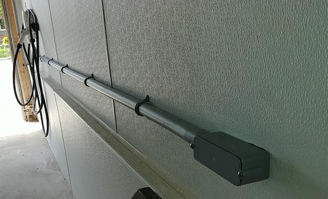

Fast forward to the F-150 Lightning order and the need for a second EVSE. The Lightning will not fit in the garage, as it's about 18-24" too long, so ideally the EVSE should go on the left wall opposite the existing EVSE. Fortunately, our main panel is in the basement on the other side of that wall, and the first floor is about 30" above the garage floor.
We purchased an Emporia EVSE that can be set for 48 A when hard wired. It was a relatively simple matter of drilling a hole through the wall and first floor rim joist to install conduit to the panel which is in a closet with an unfinished ceiling. The location of the hole is about 4' from the back of the garage, so there is an LB coupling to allow the conduit to run along the wall and curve up into the bottom of the EVSE. The conduit on the surface is not that much of a protrusion as the foundation wall creates about a 1.5" ledge:
Ford F-150 Lightning What wall outlet for FCSP ? Conduit
This EVSE has a 24' cable and because it is 11.5 kW, it is a heavier cable, so having to wind it will be more of an issue than it has been with the original EVSE.
This uses a 60 A breaker in the main panel and is wired with a pair of #6 wires for the power and a #8 for the ground. Our code only requires a #10 to ground something protected by a 60 A breaker, but I prefer to go up a step for grounding if it's not too much trouble or cost.
I considered that the future might see the need to move to an 80 A EVSE on a 100 A circuit. This would require changing the #6 wires to #3. The #8 ground would meet code for that, but knowing me I would probably up it to #6 which could be done using an existing #6 if I strip off the red or black insulation. ;)
I considered using 1.5" conduit since that is typically used for a 100 A 3-wire plus ground run (three #3 and one #6). Considering that a neutral is not likely and a pair of #3 and a #6 can fit in a 1" PVC conduit under our code, I went with 1" which is about 40% less costly. Your code may vary but there will be a percentage fill limit for conduit and you have to add up the cross-section area of the wires and divide by the cross-section of the conduit type and size to find out if its under the limit. 1" worked well because the plug-in cord that came with the EVSE that I removed used a 1" knock-out hole, so I didn't have to punch it larger.

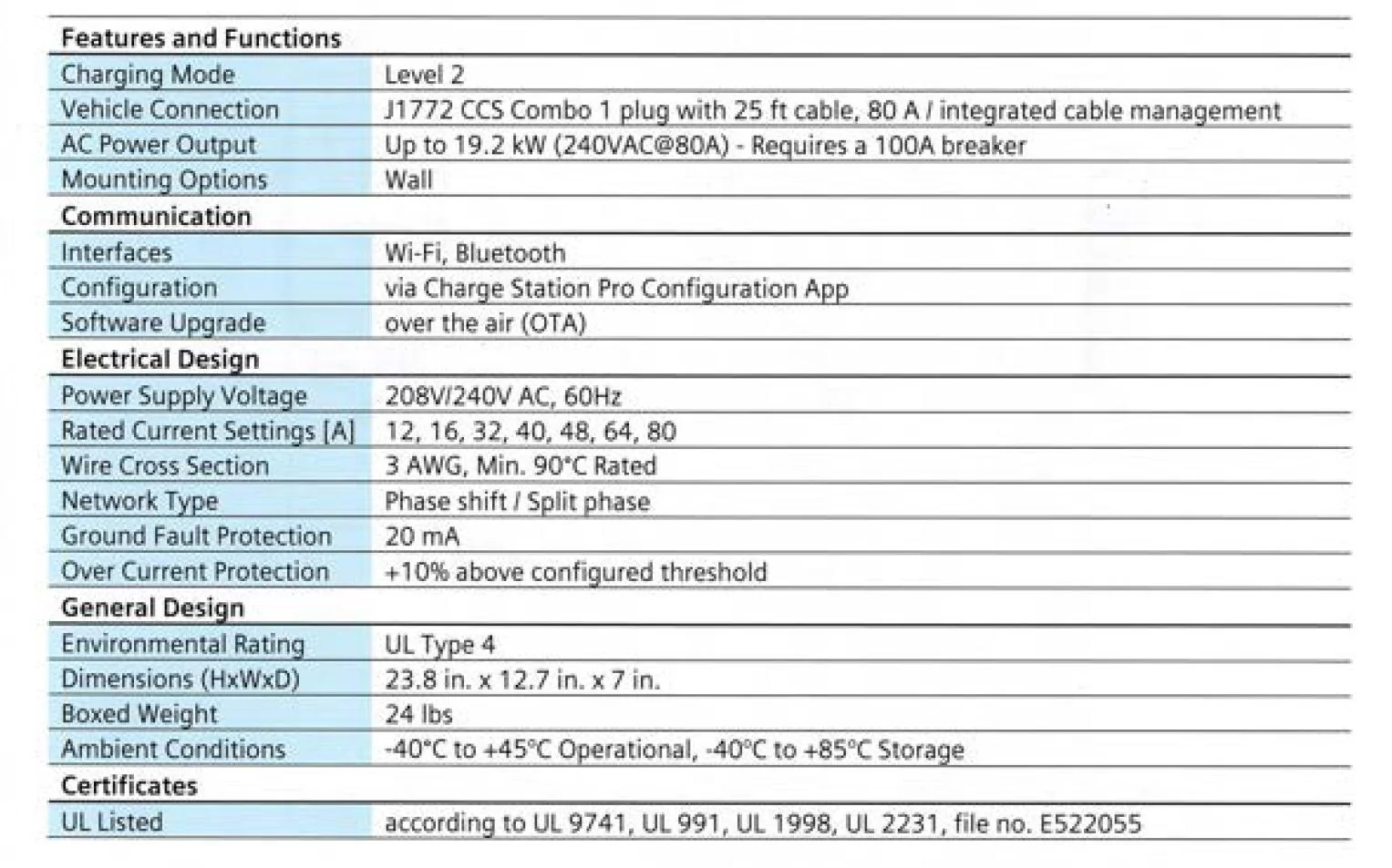

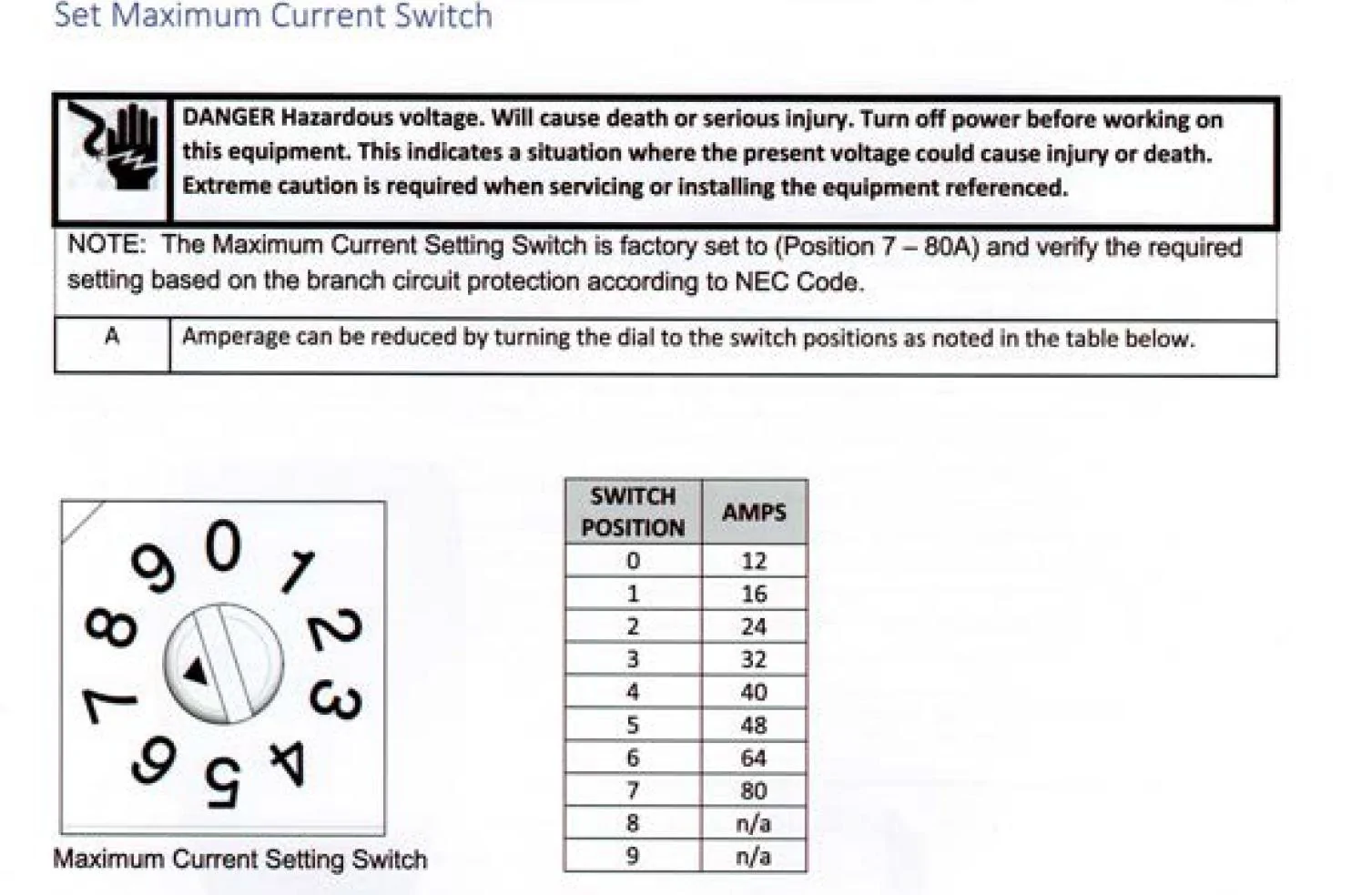

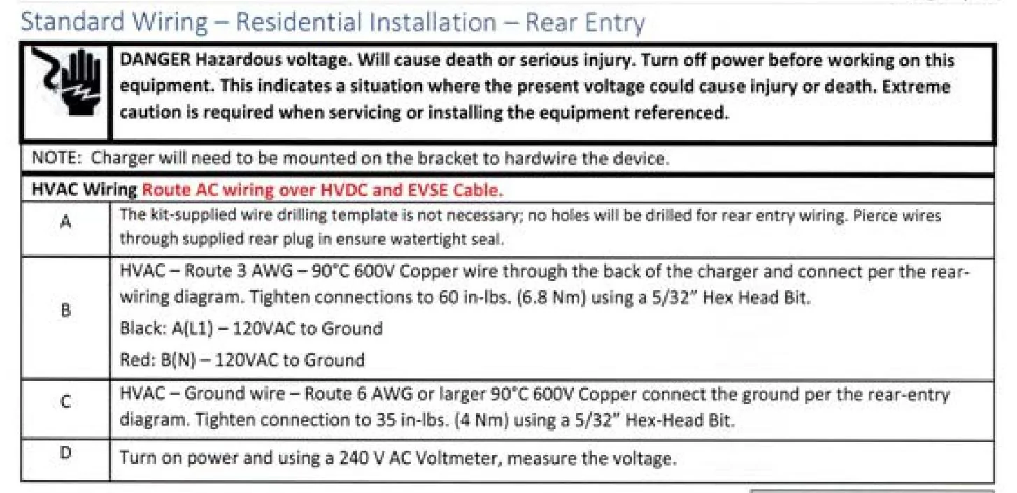

The Ford 80A EVSE manual requires a 100A breaker, #3 wire for the two hot leads and #6 wire for the ground lead.
If one wanted to use a lower amp set-up, one can set the max amps down from the factory 80A setting to what is desired.
No neutral is required, it assumes a hardwired connection.
Images from the manual attached.
If one wants to use a receptacle, according to the current code, for 60A and above, 4 wire receptacles are required, requiring both ground and neural wires.
But the code allows for connections from the receptacle to match the appliance, e.g., the EVSE.
So it seems one would have to use the required 4 wires from the panel to the receptacle.
But one would be allowed by the code to connect 3 of the 4 wires of the cord from the receptacle to the EVSE, that is, leaving the neutral wire unconnected to the EVSE and capped off to avoid accidental connection.
One should NOT connect the neutral and the ground wires together at the appliance/EVSE.
