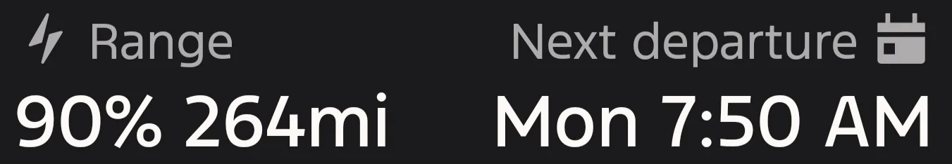

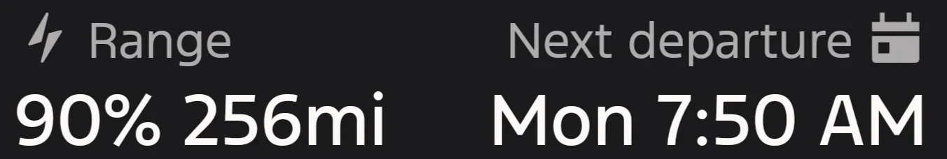

Hello fellow Lightning Lovers. We stay a weekend at these beautiful state park cabins way out in the woods, several times a year.
I always plug in my Ford Mobile Charger at 110v overnight and i usually add about 30 miles or so back into the battery overnight.
Last night before we went to bed, I checked and I had added 8 miles and 4.8 kwh to the battery. When I woke up about 7 hours later, I was expecting to see mid to upper 20s miles added. Instead I saw that only 2 miles were added in about 13 hours of charging!
I went from 73 to 82 SOC, but only added 2 miles (less than the 8 miles that was added before I went to sleep.
So I'm figuring that going from 45 degrees F last night to 34 degrees this morning, is the reason that I went backwards on my charging progress. What do you guys think about this?
