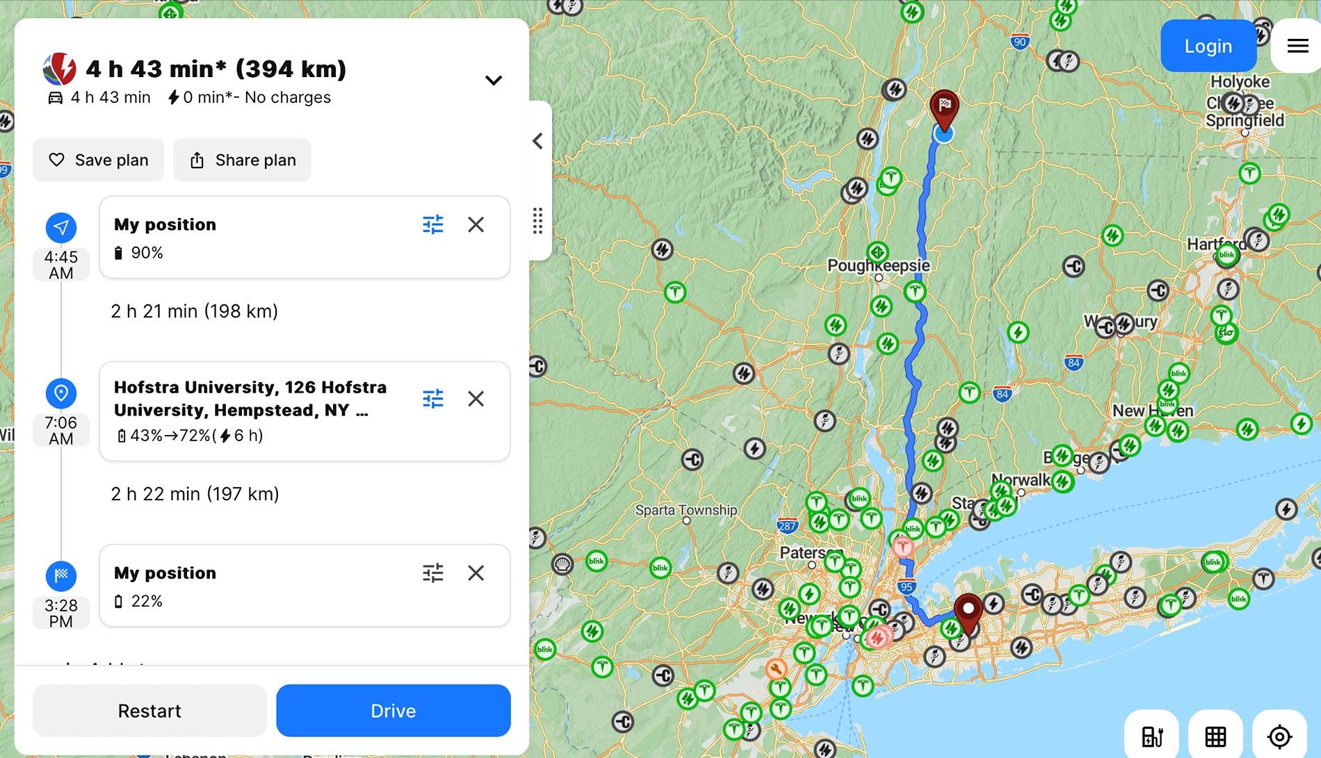

ABRP says…
Starting w 90% arriving work at 49%- 6h at 6.2 charger gets me to 78% and arriving home at 35%. Does that sound accurate? It says It adjusted for typical weather at time of year. Thoughts?

ABRP says…
Sounds right to me. Start at 100% with a departure time/precondition and it really shouldn't be a problem.

ABRP says…
That seems to be accurate BUT will you be able to totally recharge at home during your very inexpensive Off Peak Rate hours? You would need to replenish 55% of the battery to go from 35% to 90%. The 2024 ER battery can max charge at 48 amps on a 60 amp circuit if you have an EVSE that has the capability. 55% is about 72 kWhs of electricity.
Check my math:
Considering a 10% efficiency loss on the charger
  • At 48 amps (11.5 kWs) it would take about 7 hours
  • At 40 amps (9.6 kWs) it would take about 8.3 hours
  • at 30 amps (7.2 kWs) it would take 11.1 hours

My typical Monday (127 miles from upstate to long island- mon and weds 52ish times a year)
He should be able to recharge, even if spread within TOU limits over 2 days (Mon/Tue then Wed/Thur)

ABRP says…
Check my math:
That is good info- yeah I would be out of TOU by a few hours.
If I get a 2023 then I can amp up? But loose the heat pump. Thoughts on that

ABRP says…
So I adjusted for 20 degree weather (both legs) and 90% start charge and it says I arrive home with 20+%
That would mean I would use 120kw of energy for 256ish miles 2.1m/kw?
The calculator is accurate on my tesla from last weeks cold snap- but 2.1m at 20 degrees seems like quite a stretch for the Lightning?

Couldn't you pause charging Monday/Tuesday and resume early Wednesday?
What are the start & stop times for TOU?
