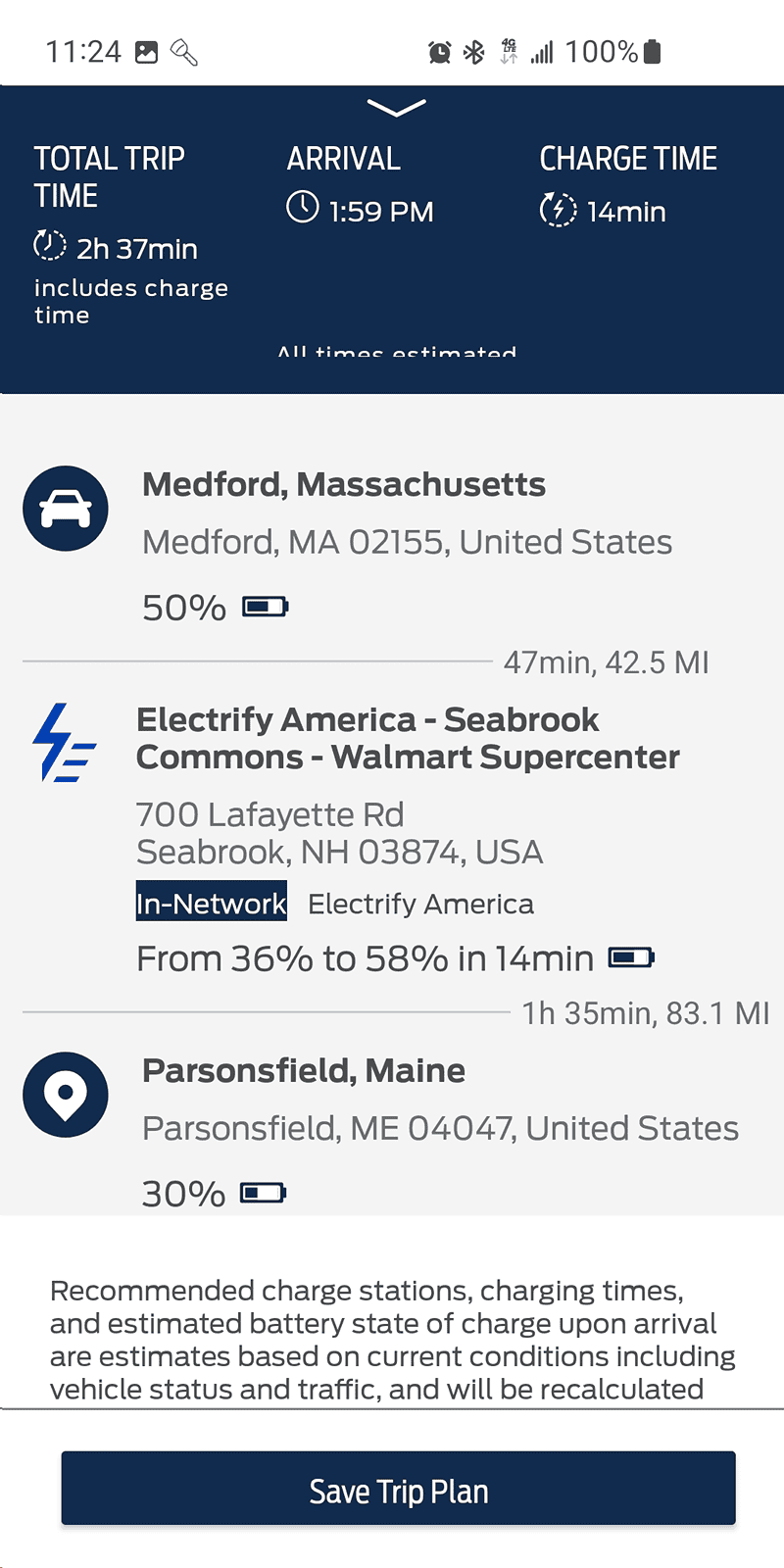

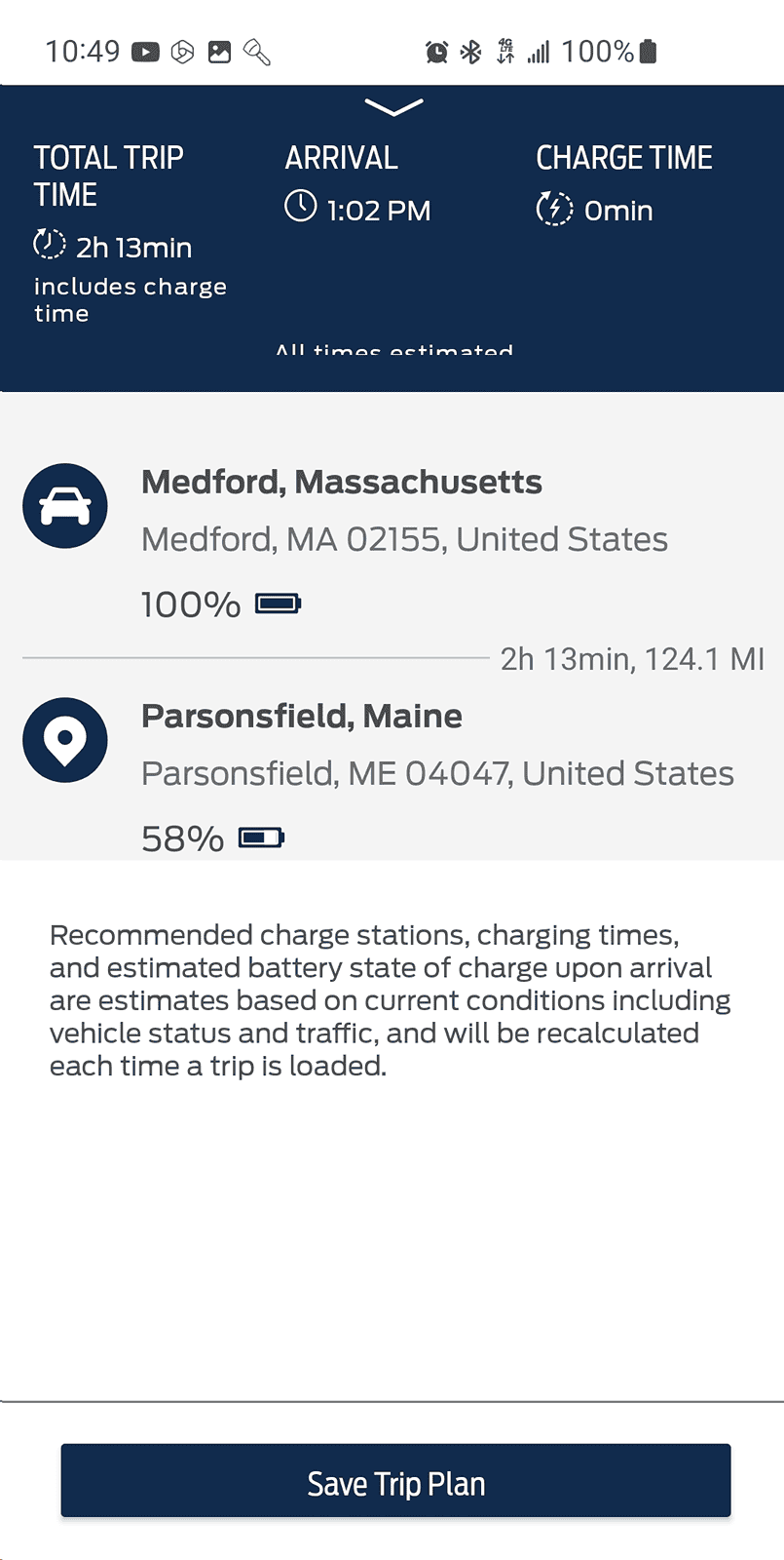

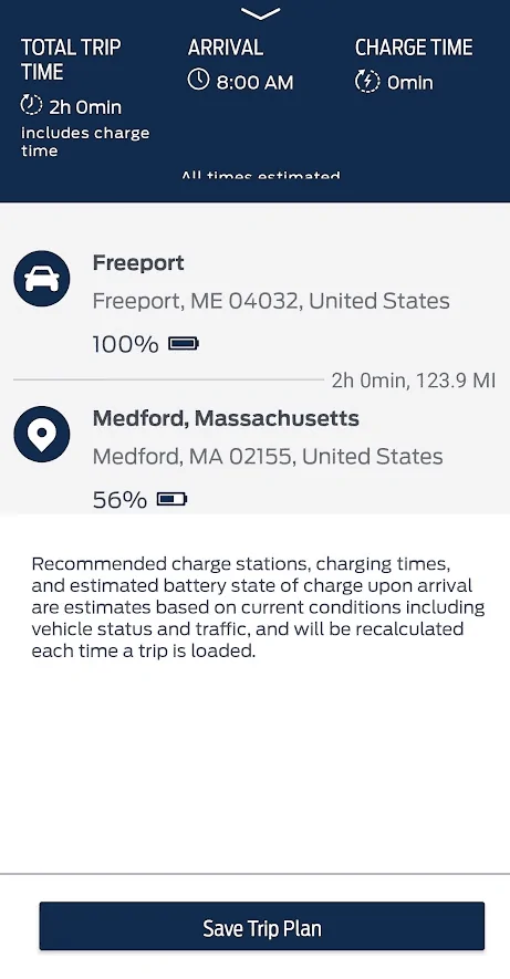

This is what the Ford pass trip planner projects, note this is assuming an extremely optimistic 2.14 MPK, reality is depending on speed & how much heating you use it could get down to 1.6 or 1.5 MPK.
ER battery pack with 131 KWH at 100% starting SOC, consume 58 KWH of energy over 124 miles, 2.14 MPK, the reality is a lower number, worst case, 124 miles divided by 1.5 MPK, 83 KWH
SR battery pack with 98 KWH, you would use ~85% arriving at your destination with 15% reserve, or 10% if you started with 95%
Use Rick's recharging factors, the conversion losses of 15% is ballpark, but I've seen it as good as 8-10% but that is on an ER pack with dual inverters and 80-amp EVSE, with an effective input current of 75 amps.
In the end you can make it work in a SR truck, bookmark the DCFC stations along the way, pump up enough energy if you're falling short, the best point to top up is when you are 10-30% SOC then use home/remote home charging to top up for next long drive.
BTW, when it comes to winter battery prep, set your max charge to 95%, schedule the departure timers to be ready 10 minutes before actual leave time, this will ensure the battery & cabin are fully warmed up!!

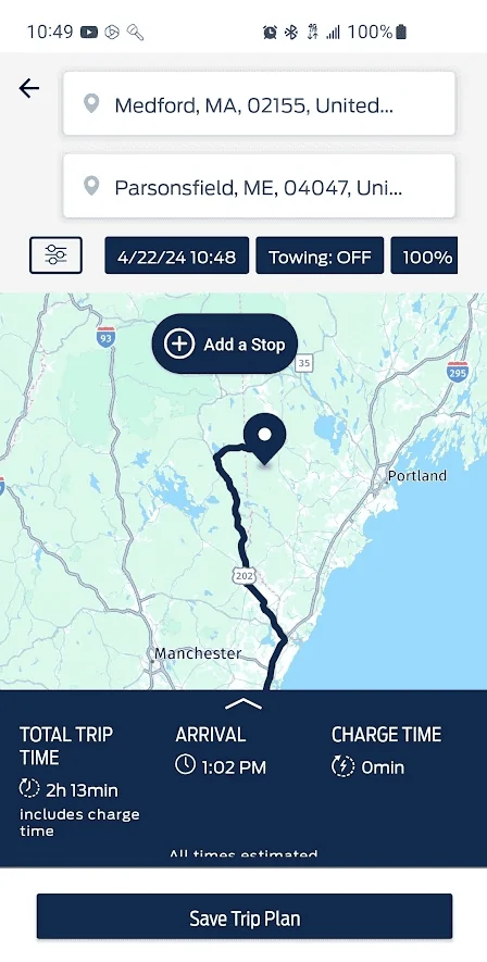

I'm actually going to western maine, which means only half will be highway, but also slower driving... If your model can easily spit out Medford, MA or Parsonsfield, ME that would be helpful! But you have all been so helpful already. Much appreciated!

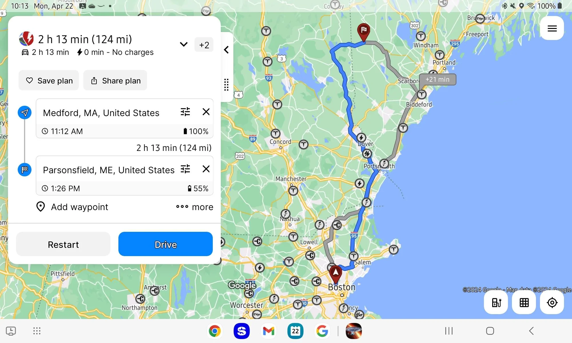

55 KWH over 124 miles = 2.25MPK
124 miles / 1.5 MPK = 83 KWH

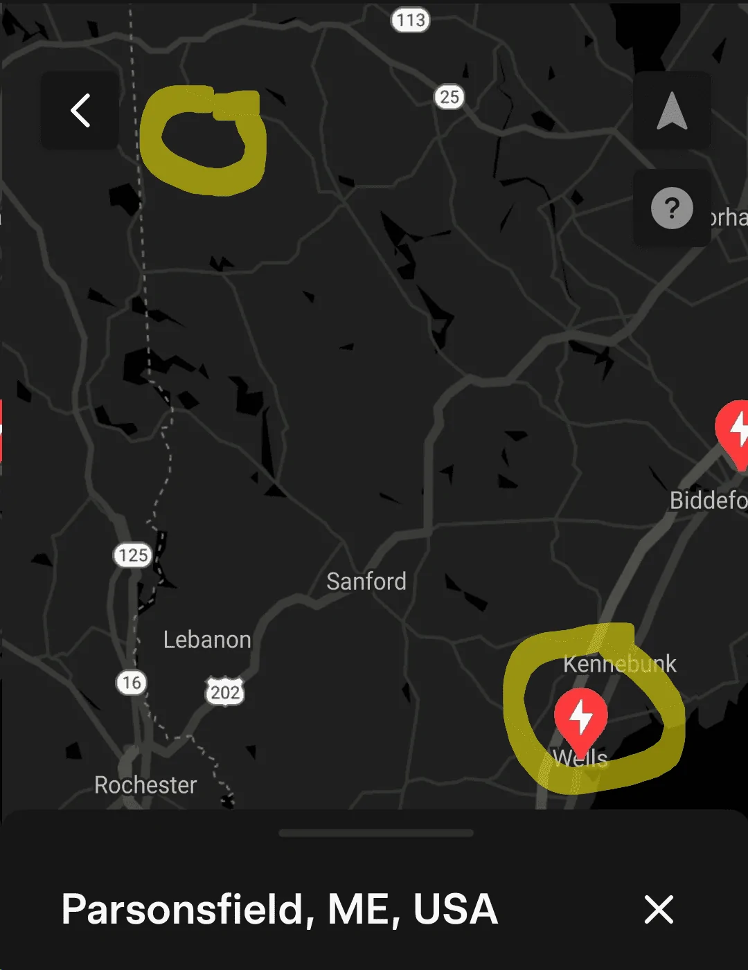

I'd be pretty uncomfortable with too much off main roads in Maine, I lived in Bath and would not even consider SR for winter. Battery range impact is easily 20 to 30% and wind is huge impact. 70mph with 10mph head wind is equal to 80 mph drag, and very low m/kwh. I'd hate to almost make any distance in cold Maine winter.
If you are dead set on a SR, on this trip sto0 at last DCFC and quick charge to 80% to be safe in winter temps.
232
16,502
18,599
DCFC Stop in Wells, Me at Tesla
