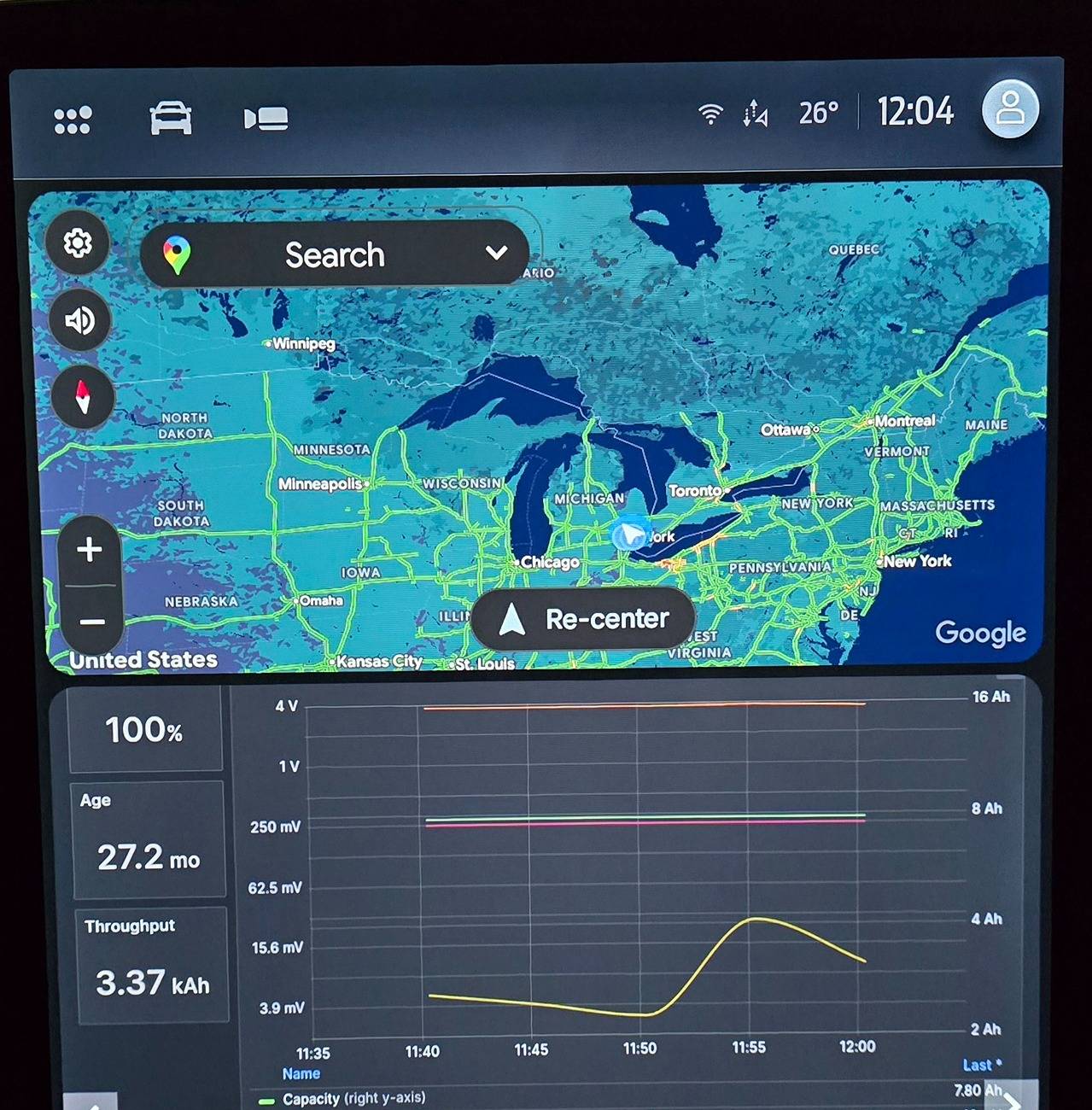

There is one for total/accumulated throughput in Ah, I can dig it up tomorrow.
HYBAT_LIFE_CHRG
0x22485D
tmpValue = parseInt(vResponse[3] + vResponse[4], 16);
Not sure how this translates to Torque or CarScanner, but it's the same as all the other 16bit values, no conversion needed and it gives you the throughput in Ah (my graph converts it to kAh)
