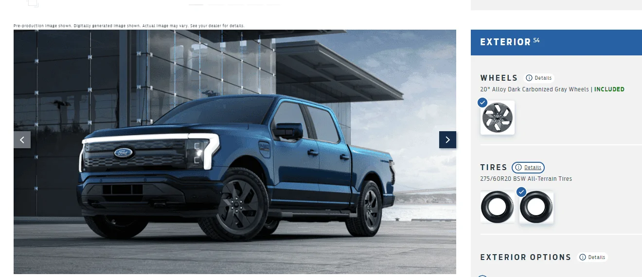

@FordVideoGuy Tim Bartz mentioned on his Tuesday night podcast that due to a shortage of the 20" all season tires, the order guide and build and price have been updated to default the All Terrain tires on Lariats and high trim XLT's.
Just a reminder the 20" All Terrain tires reduce GVWR and Payload by 150 pounds on the Extended Range models) compared to the all season tires.
20" All Terrain tires GVWR = 8,400 pounds.
20" All Season tires GVWR = 8,550 pounds.
This change actually affects the 4th character in the VIN. 1FT6... = GVWR>8,500 pounds. 1FTV.... = GVWR < 8,500 pounds.
The 20" all terrain tires have a recommended inflation pressure of 36 psi. The 20" all season tires have a recommended inflation pressure of 42 psi. I think it is this difference that triggers the GVWR change.
There is a thread from this spring regarding this difference and the impact it has on the Massachusetts MASS More EV tax credit (no credit for vehicles below 8,501 GVWR. https://www.f150lightningforum.com/...n-reduces-lightning-gvwr-by-150-pounds.10227/
Now defaulting:
Ford F-150 Lightning 2023 Lightning with 20" wheels now only shipping with All-Terrain tires (at no cost) 1667488185070
Edit: Just to clarify, this only impacts the Extended Range GVWR. The SR GVWR will be 8,250 pounds in both Lariat and XLT trims.
