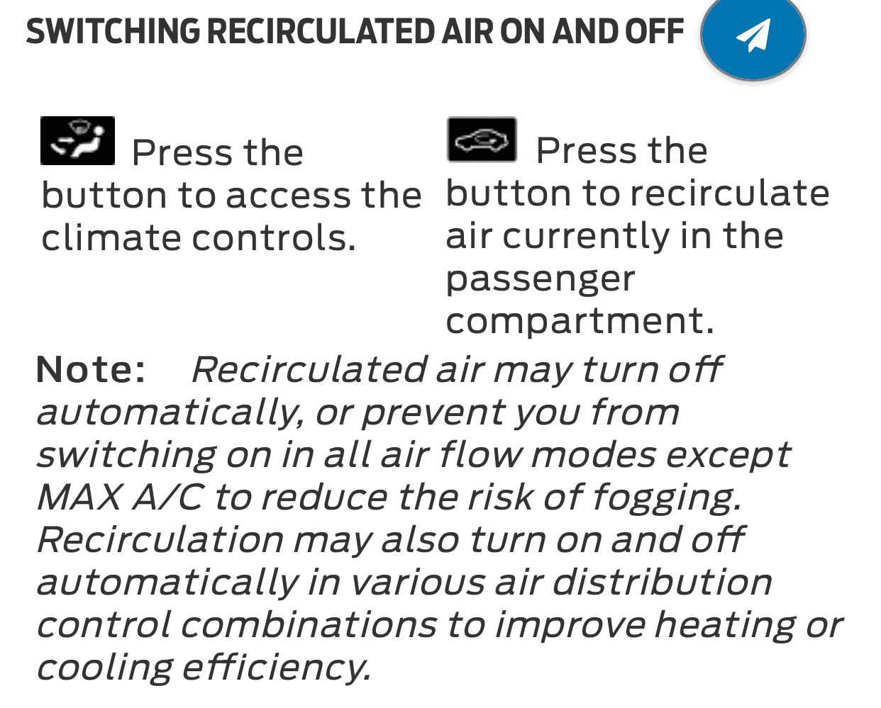

Somewhere I read that Recirc monitors air quality and turns off when it determines high moisture conditions that could fog the windows and require more energy to clear than allowing it to condition outside air. (Or, something like that.)
Edit: It's explained in the on-board manual search : recirculate

Yep, by design as @Amps stated.

If you 1) don’t use the “Auto” setting, and 2) don’t have airflow directed to the windshield, recirc will stay on indefinitely.

"It's a feature, not a bug."
It is intended behavior.
Is says that but it’s a complete lie. If it was “monitoring” it would’t be timed. If there was a fog condition then me turning it back on recirculate immediatly every time it turns off would mean I should have a fogged cabin, I don’t. If it was to save energy it would not be filling the cabin with 50 degree outside air when I have the temp set to 70, the heat off and “auto” set on 2 bars (it’s actively making the car colder than I want). It’s the most frustrating climate control ever invented. After reading the manual I realized there is no manual mode, only off and three fan speeds of auto. @Ford Motor Company please fix this most annoying “feature”. I have TWO dedicated buttons on the home screen for max defrost. Why? Please change one to recirculate and don’t turn it off without a prompt for me to override.
