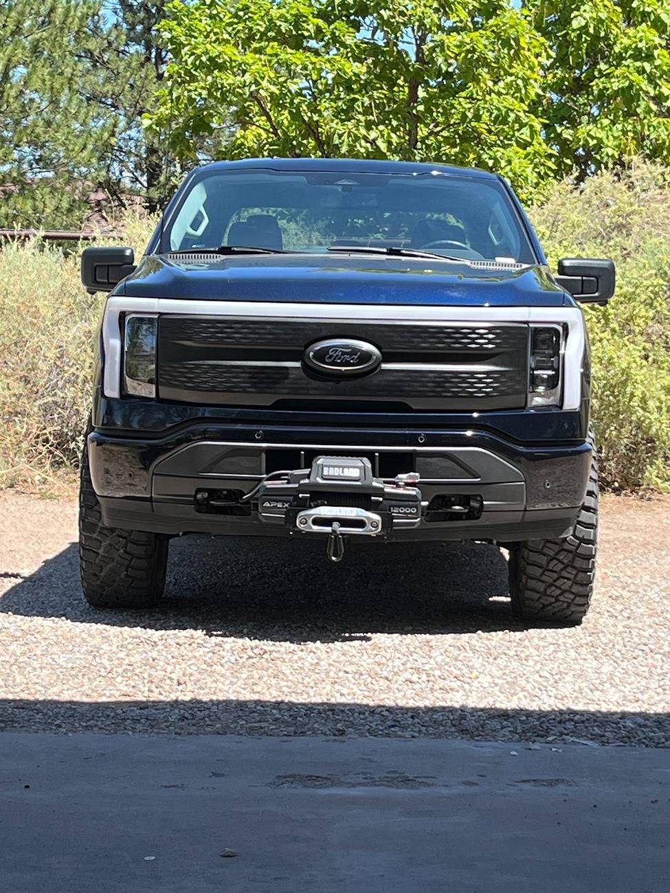

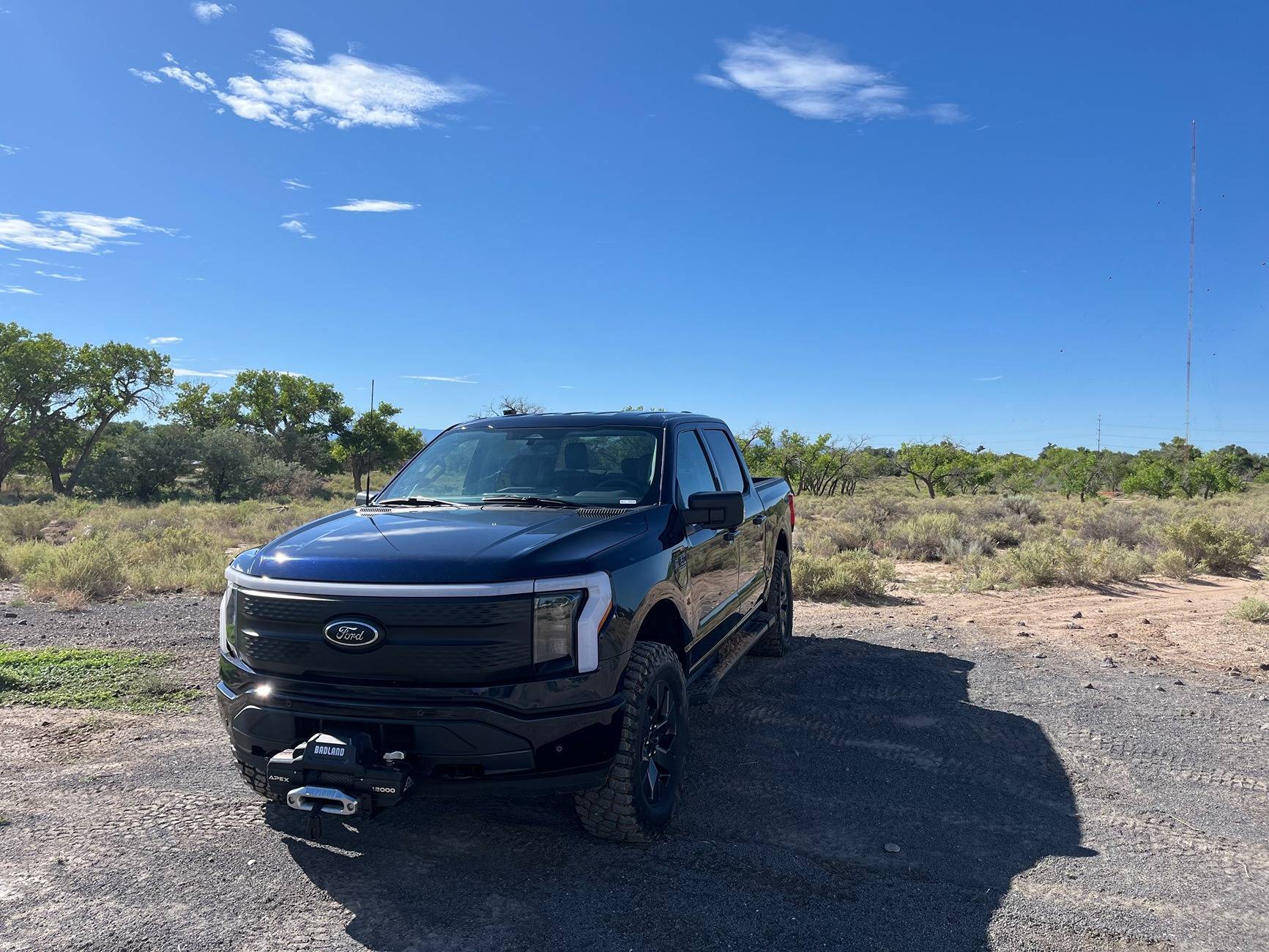

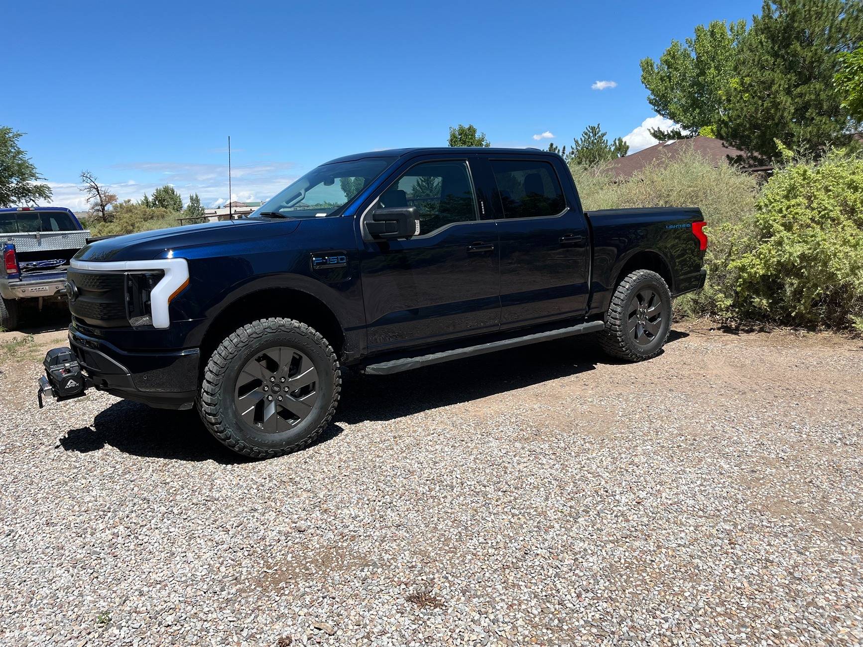

OK, so here is what I did:
Front lift – factory springs, 1.5” KSP spacer puck, and Eibach PRO-TRUCK Sport Shocks set at their highest setting for about 3.5”-4" of combined lift overall.
Rear lift - factory springs and Eibach PRO-TRUCK Sport Shocks set at their 2nd setting for about .3” of lift.
Tires - BFGOODRICH Mud-Terrain T/A KM3 LT295/65R20/E, (35.1 x 11.61)
Wheels/spacers – OEM wheels with 1” Bora spacers (This tire/wheel/spacer combination barely rubbed the front spoiler, so I took off about ¼” of the tip of it. The other rub is was a slight amount on the front crash bars.
Curt front hitch for winch mount
– 1st modification, redrilled the mounting holes 22mm lower and then removing the excess metal above that so it could move the entire thing up 22mm, gaining that much ground clearance.
- 2nd modification, welded a 2nd 2” receiver tube on top of the original one so that the winch would sit up about 2.5” higher. (Total additional height of receiver tube for the winch is about 3.25” higher than the original Curt setup.)
- 3rd modification, welded a 3”x 3/8” steel strap from the two tow hooks to the newly installed 2” receiver tube to provide more strength (for straight pull or pulls at an angle).
Winch – Badlands 12,000# (it does not seem to interfere with the front sensors at all)
Prior to adding the weight of the front hitch and winch, the back end was slightly lower than the front, so I was prepared to bump the spring setting on the shocks rear shocks up one more setting (the maximum per Eibach). Now, with the extra weight it seems about level. I also will be putting a full sized deep cycle battery up front to run the winch, so I’m confident that it will be leveled-out then, if its not now, so I am not likely to adjust the rear further.
