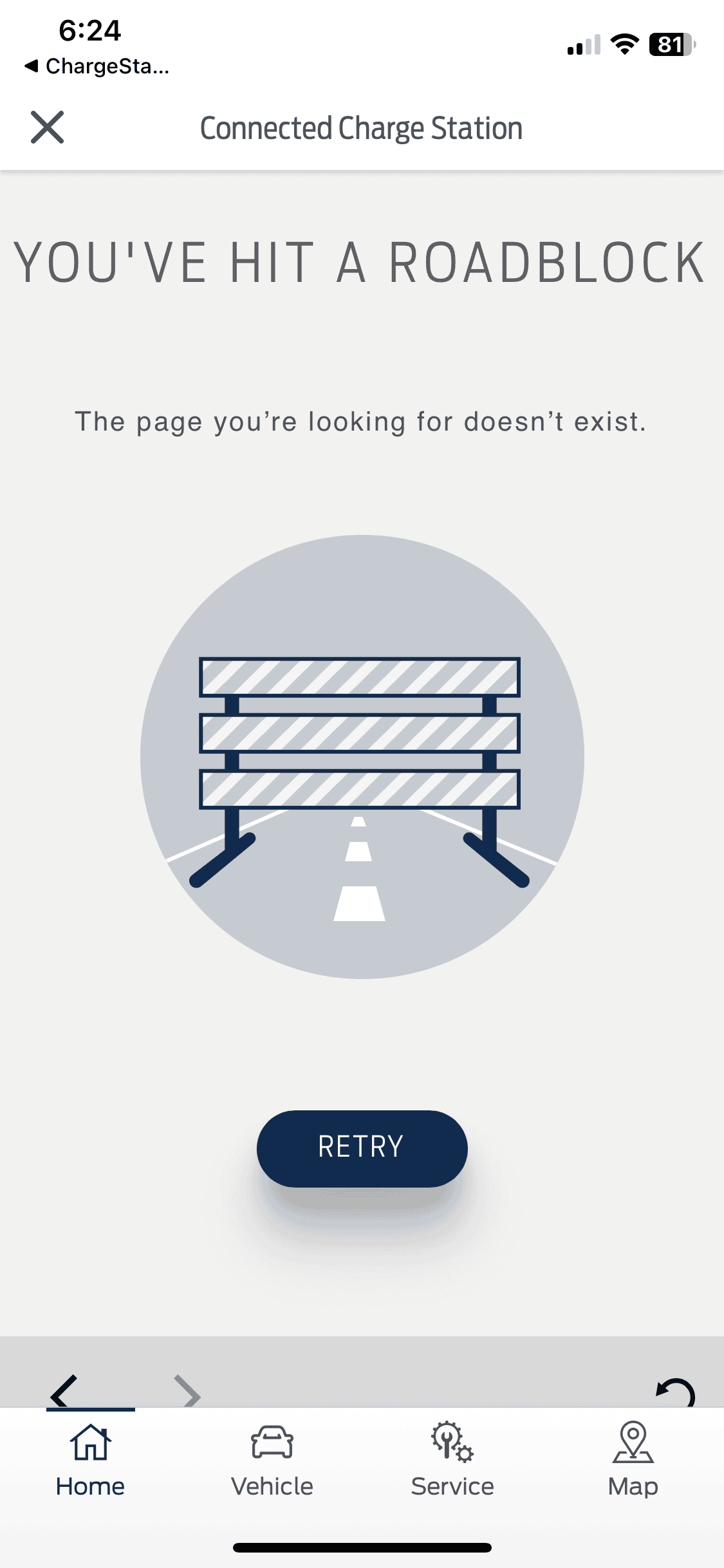

Hey All,
I have the charger all set up in the ChargeStation app, and when I get to the part where I can CONNECT TO FORDPASS, it opens the FP app and then I get this error message. I’ve tried resetting the charger and reinstalling the app several times. I’m at a loss and the Ford people are not helping. Wondering if anyone else has had this problem and if there’s a solution. Thanks!

Yes. It started today. Customer service said to delete FP on all devices, reinstall and try again. If it doesn’t work to call them in the morning. I put the lime in the coconut too, just in case.
I’ll call them tomorrow because it didn’t work.

Also having the same problem. Charger still seems to work as normal but can’t access within FordPass to change charge rate.

Glad to see most of you are back in business.
Seems that back end services were down from yesterday afternoon to this morning.
Charge history might populate retroactively for missing records.
