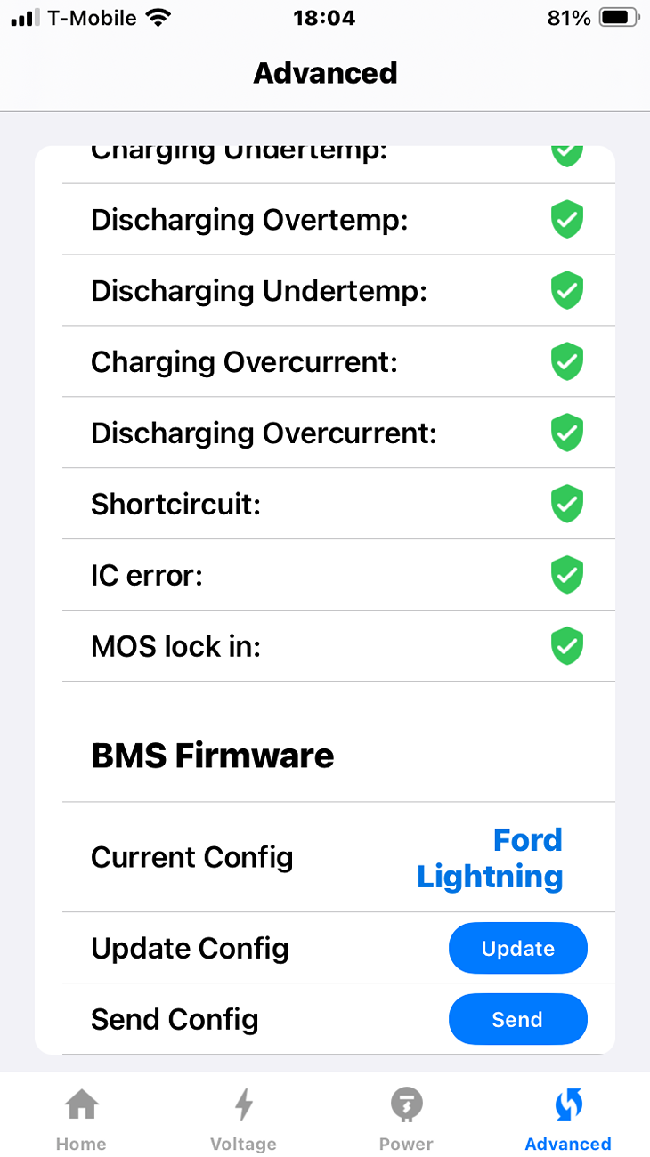

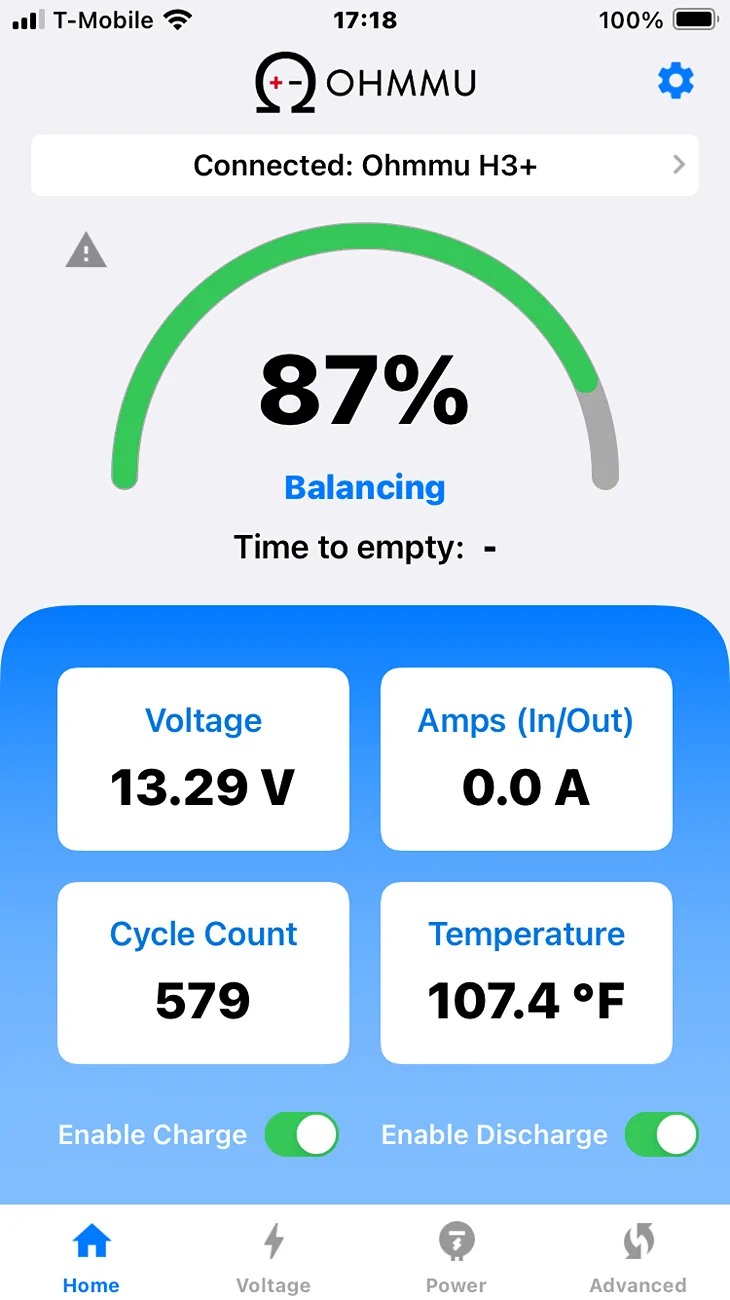

Lithium about 2 years ago. Configured for the Lightning and simple installation with 10mm wrench. About 9lbs lighter. I’m in central Florida and it’s warm this time of year.
Screen shot from app below.

l’ve been using the Lithium battery in my 22 Lariat ER for over 2 years with no issues. OEM 12v barely made it 8 months. Ohmmu advertised as ready to go. See screenshot from app below
That terminal voltage indicates that battery is at about 90% SOC. Does the APP have a SOH calculation - that would be interesting to see.
Apparently, it has a built in BMS to balance the cells so that makes it compatible with the Lightning system:
