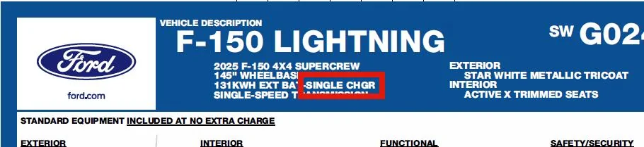

Jumping on this thread - someone please redirect me if I'm on the wrong one.
I have a 2025 Lariat with ER battery. I also have a professionally installed FPSP with 100A circuit. I've voluntarily set it to 48A using the internal current limiting dial. It's worked well for months. Today, however, I needed more juice in a hurry. I opened the cover and set it to 80A and... the truck says the max is 48A under the Advanced screen and my Ford Pass App says the same (max slider setting is 48A). People online are talking about one or two onboard chargers for AC charging. How can I tell what my specific truck has? Can the external temp be limiting my charge? It's 94 degrees F today?
Thanks in advance!

Beginning in 2024 all Lightnings (except certain fleet models) have a single onboard charger and are limited to 48A. See your window sticker to confirm:

Yup. I see it now. My sticker says single. Very sad.
Thanks for the quick reply.

I see that now as well. It's a 7 alright. I'm not happy at all. I'll be smarter next year.
So what models do come with the dual chargers?
2022 and 2023 ER. For 2024 and 2025, fleet dealers could order a Pro or Flash with dual charger. But not available on the Lariat or Platinum.
