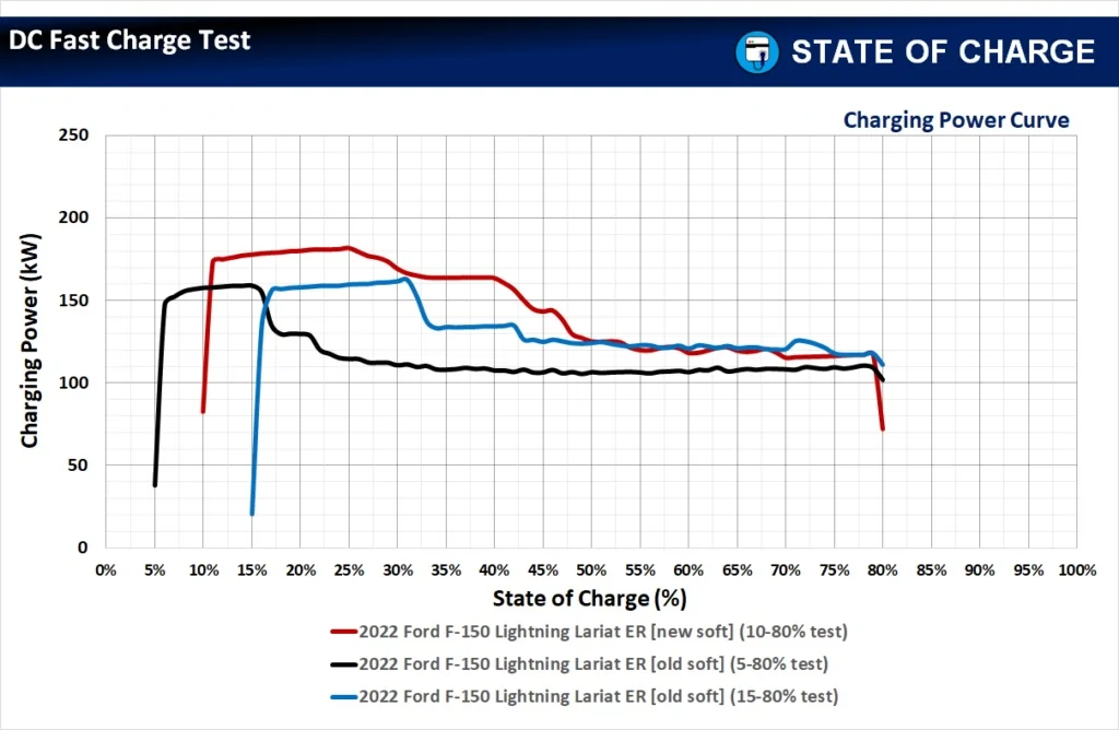

At a properly working 350kW charger, an ER Lightning will hit low 190s if you start at 10 or 20%. It won't drop into the 50s until 80%.

This is rather slow for the Lightning.
Generally speaking below 60% SOC or so the Lightning will charge at ~180kw for a few minutes and then drop down to the mid 120s until 80%, at which point it plummets to around 50kw and continuously gets slower and slower as it approaches 100% SOC.
At 60% SOC you should have been seeing over 100kw until 80%.
Guessing from your location it wasnt over 100 degrees out when you stopped to charge. Aside from towing or maybe really high highway speeds imo your battery should not have been too hot to charge.

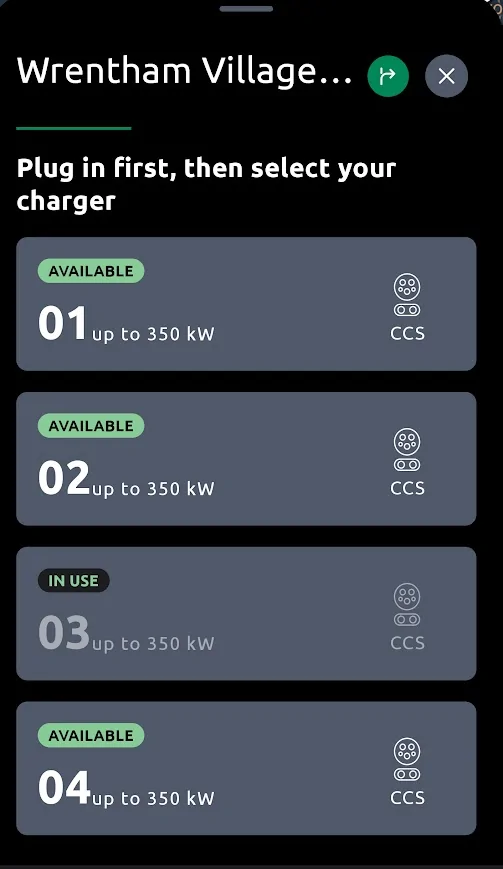

Battery at 60% went to a 350 KW electrify America charger and was only charging at 58KW.
Which location?
The one in Wrentham at the Outlet Mall has a couple terminals that are perpetually slow even at low starting SOC's
