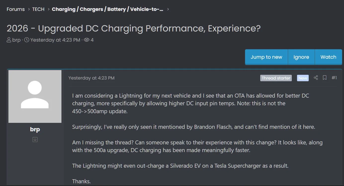

I am considering a Lightning for my next vehicle and I see that an OTA has allowed for better DC charging, more specifically by allowing higher DC input pin temps. Note: this is not the
450->500amp update.
Surprisingly, I’ve really only seen it mentioned by Brandon Flasch, and can’t find mention of it here.
Am I missing the thread? Can someone speak to their experience with this change? It looks like, along with the 500a upgrade, DC charging has been made meaningfully faster.
The Lightning might even out-charge a Silverado EV on a Tesla Supercharger as a result.
Thanks.
Ford F-150 Lightning 2026 - Upgraded DC Charging Performance, Experience? 2026lightningerror
Looking at the thread title I think you'll be disappointed as there is no 2026 y/m for the Lightning, the last y/m made is 2025. I'd imagine by now it's slim pickings on what's left on the market other than used.

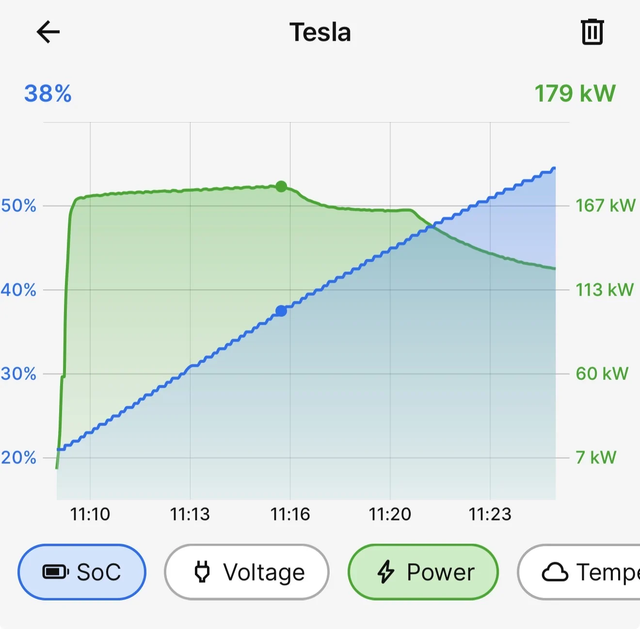

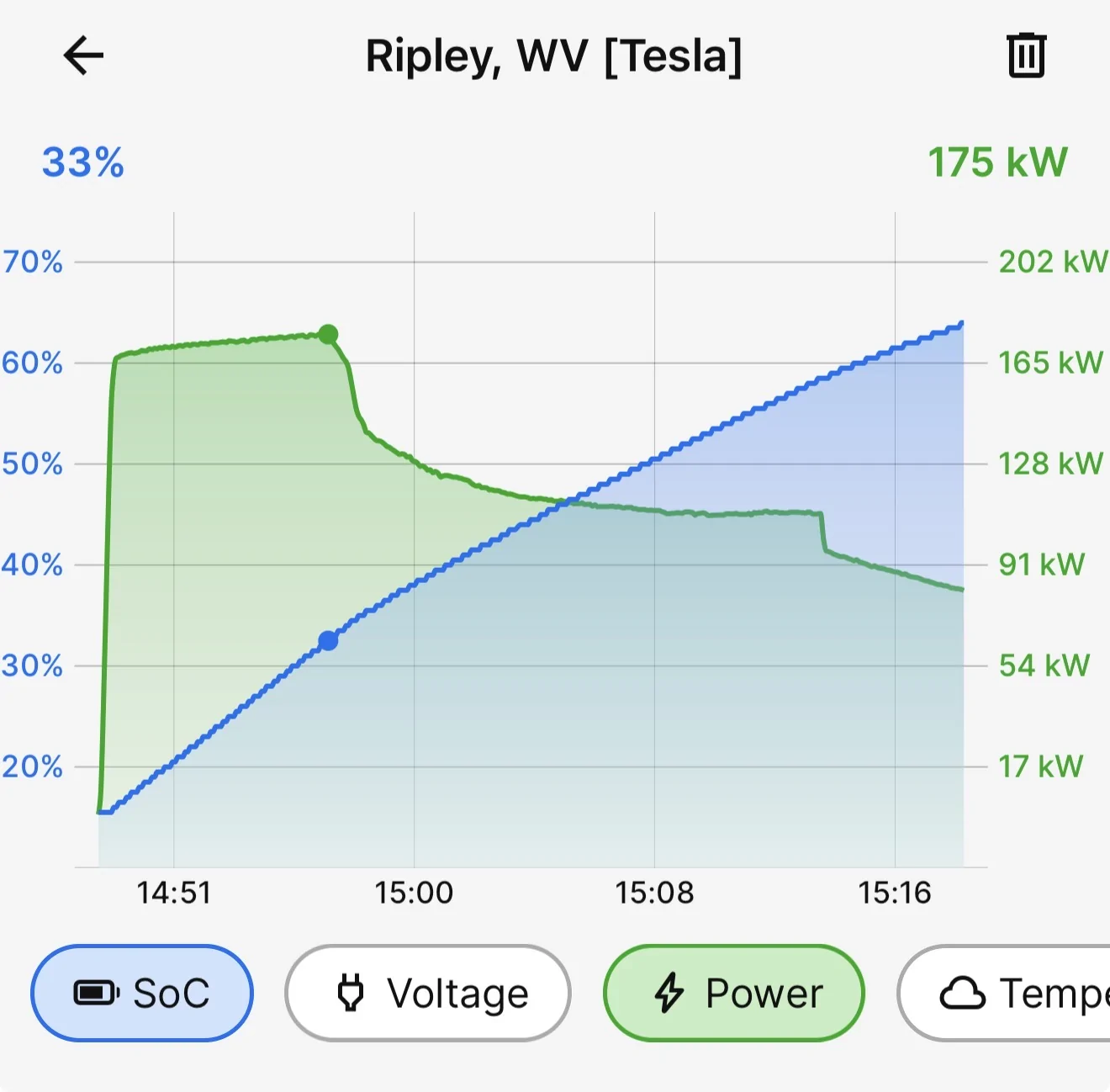

I’m not sure the difference it will have in the real world. I’ve done several charging sessions in very cold temps, and the vehicle still pulls amperage after around 10 minutes. The attached “Tesla” session was in 22°F weather and the “Ripley” session was 85°F with sun directly on the charging cable.
EDIT: I see what Branden is talking about. This is the update to give the early Lightnings the same curve that the 2024’s and later have. You got me excited that there was something new out there.
