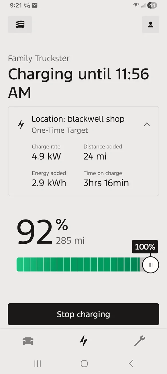

Screenshot soc was 91% started to derate after i hit 90%
Im currently at 92% and its down to 4.9
Was pulling 6.8 at 90%
Time on charge looks weird
because i pulled into shop at 88% it charged to 90 and was shut off for a couple hrs before i restarted

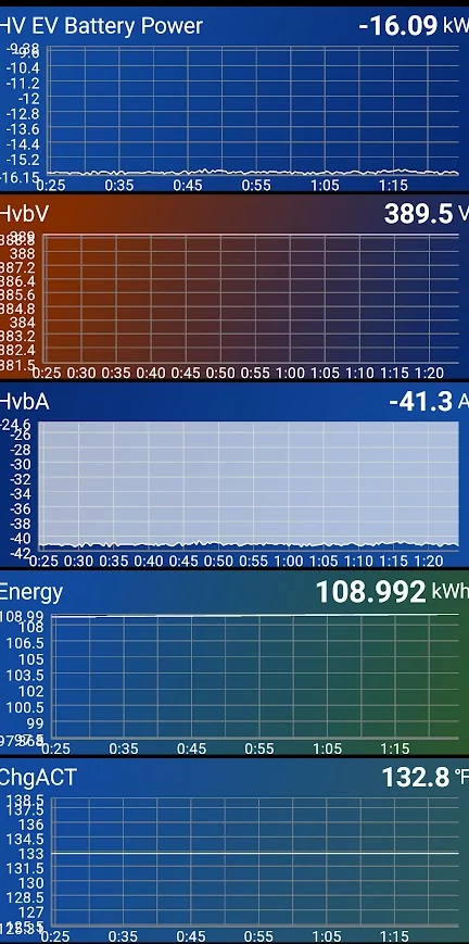

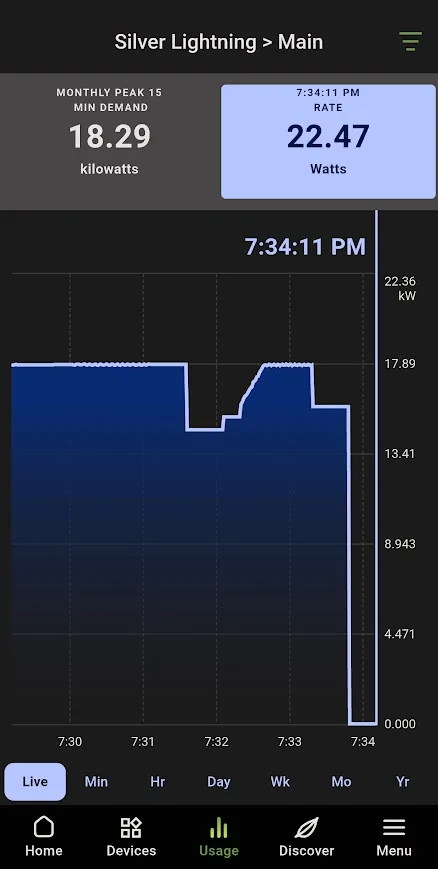

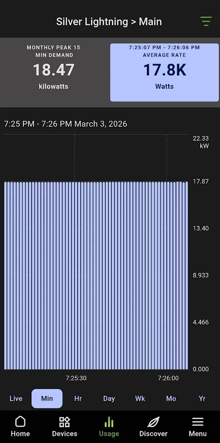

Do you record log files with Car Scanner, if so look at the AC Charge COupler Temperature to see if it's spiking!!! Hope it's not as that would indicate a problem with either the port in the truck, since your seeing the same with your EVSE and the one at work, we can assume they aren't the problem.
Of course if you don't see abnormal temps, ie. 136 degrees is what I just experienced charging my truck from 83% to 95%, I never seen a derating during the entire process, then you might have other issues with the hardware of software on the truck.

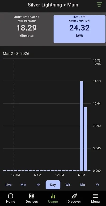

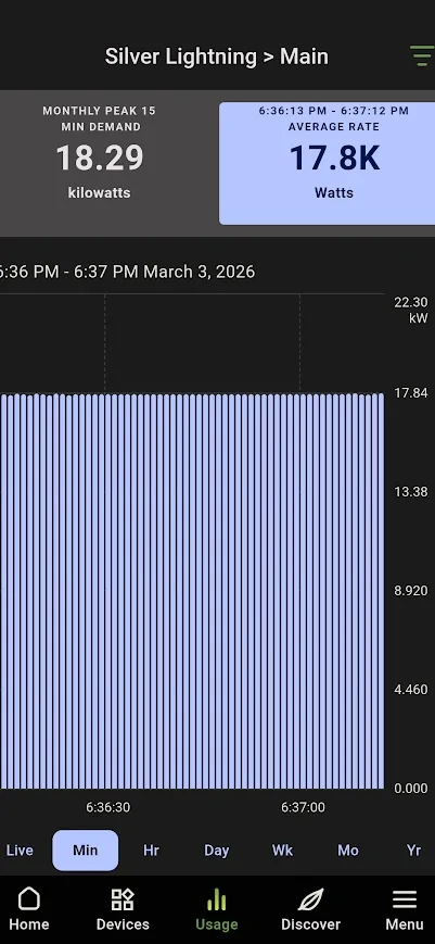

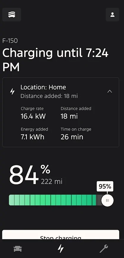

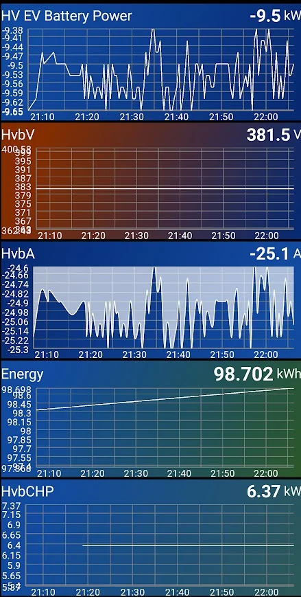

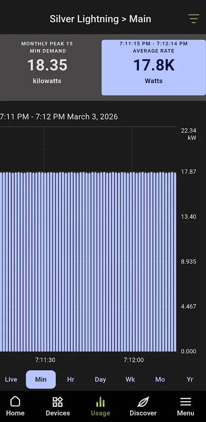

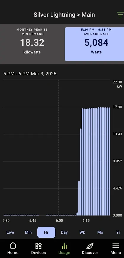

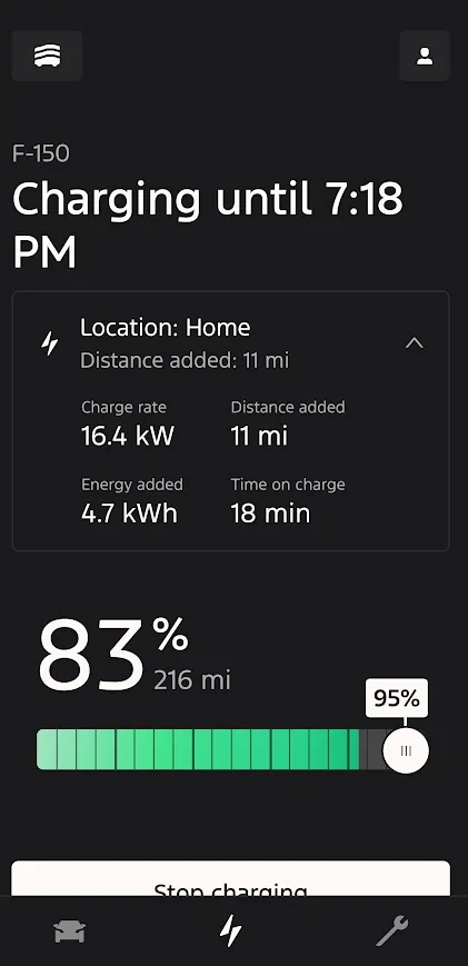

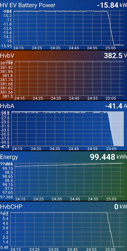

At the start of the process the HVB was very cold, so half the energy went to the PTC to warm it up as seen on second photo bottom graph 6.37 kW for warming (Cabin HVAC OFF) and 9.5kW was to charging (80 AMP EVSE), Emporia monitor showing 17.9 kW energy flow.

At this point 26 minutes the battery reached acceptable temp for full rate charging, PTC energy shut down to 0 kW, EVSE continued plugging along

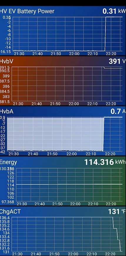

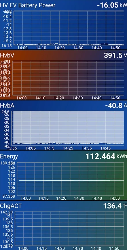

I started monitoring the AC Charge Couple temperature on the bottom graph at this point (middle photo) input energy is consistent, no sign of derating.

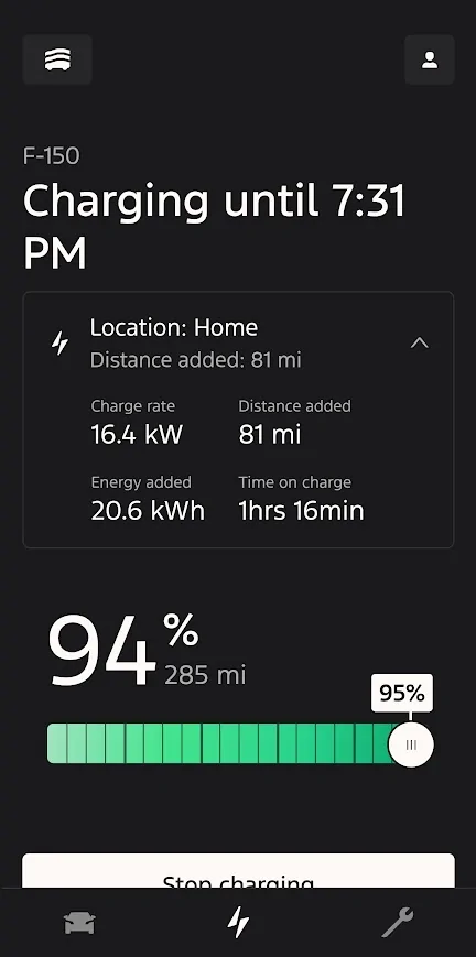

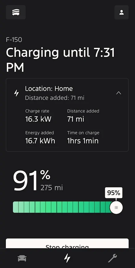

Now at 94%, all is running fine, coupler temp 136.4 degrees, input energy stable

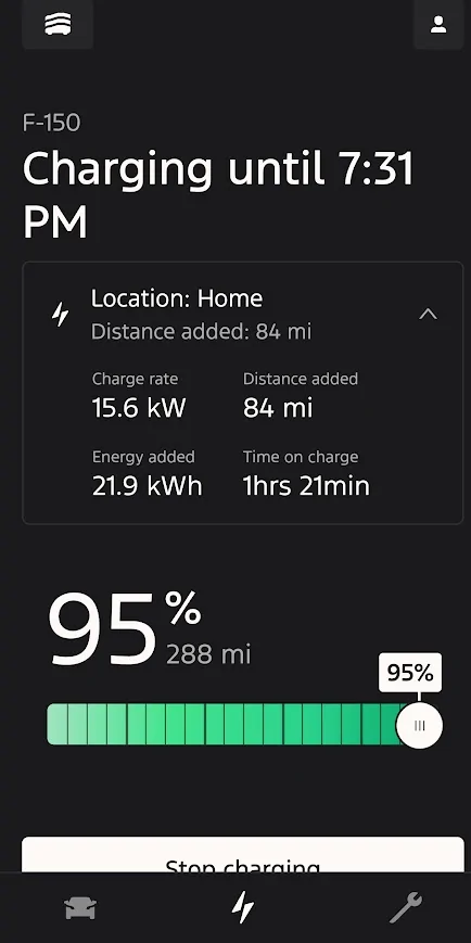

Hit the 95% point, it didn't auto stop because I had the truck "running" to keep the data feed going to car scanner with out interruption, I manually shut it down, ending results.

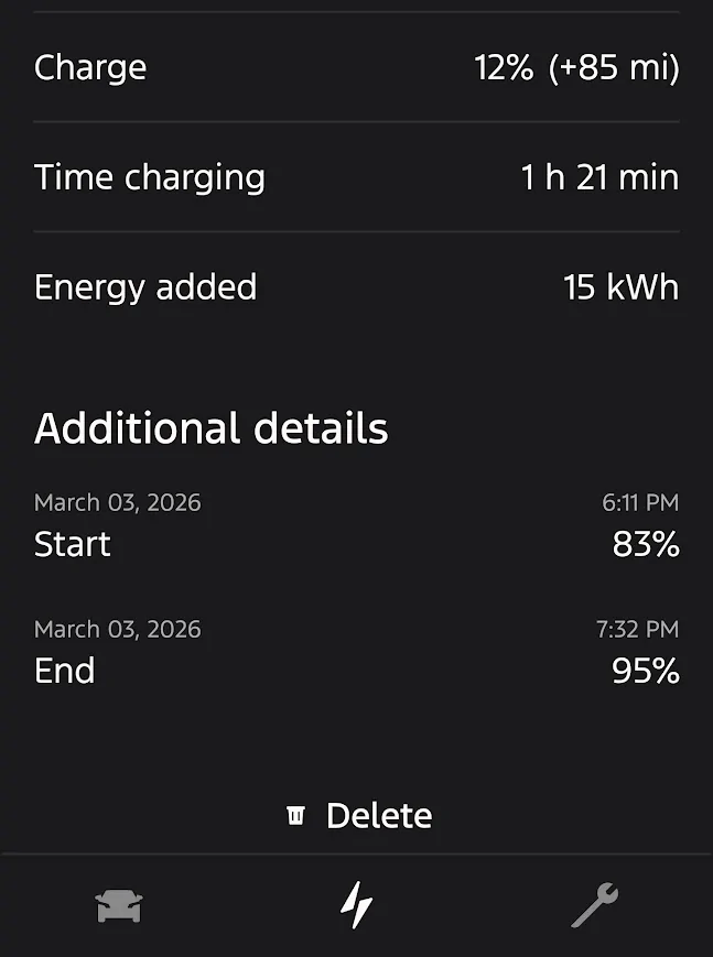

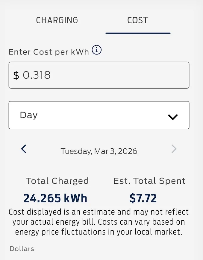

Charging statistics for the fun of it............

Excellent, answered my remaining questions about the PTC, including both how it looks at the charger/ford app (just looks like charging) and amp cost at the charger (25-30, daymmm)
