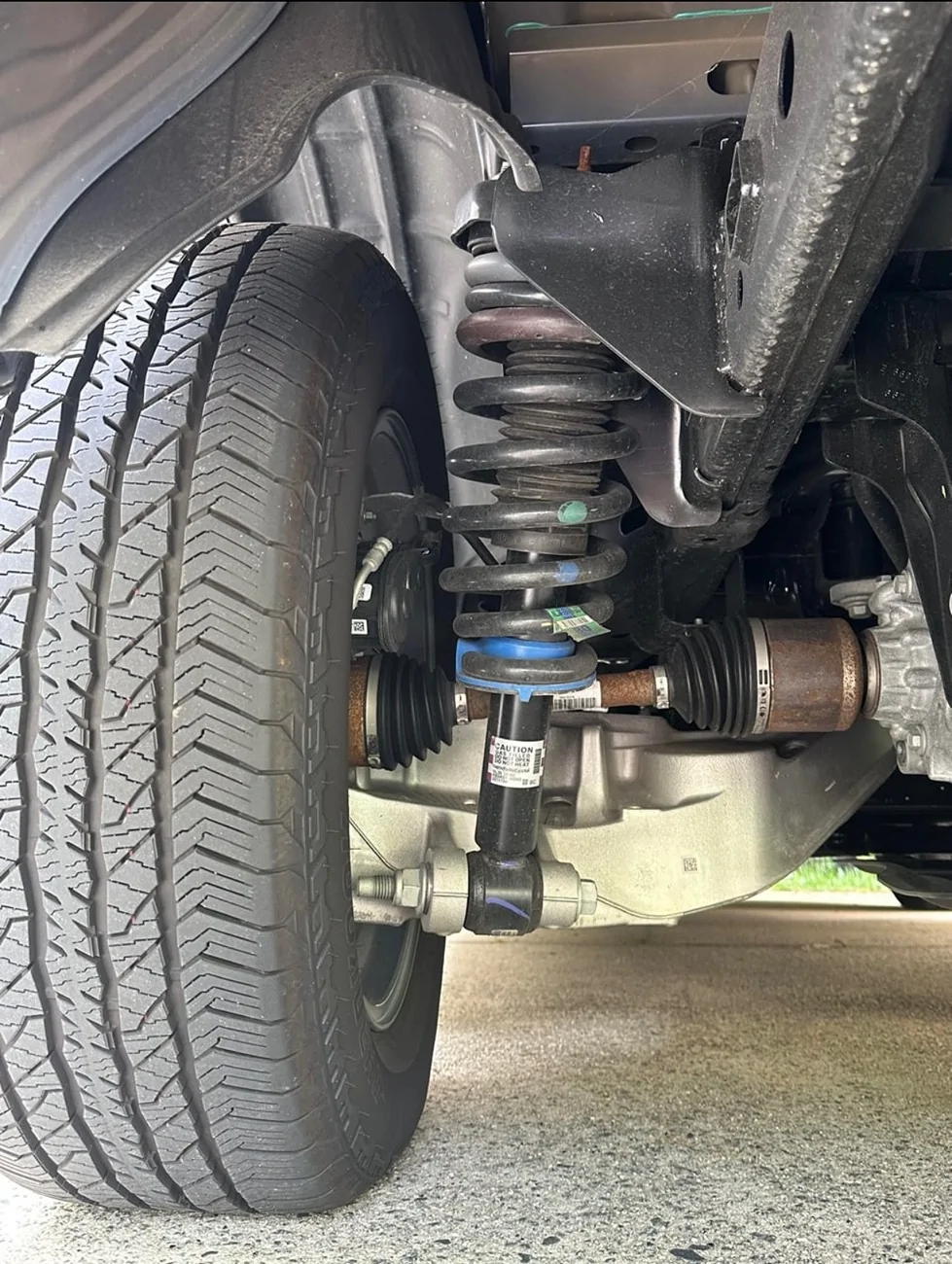

I see what you’re talking about. Found this photo of a Lightning rear suspension on Reddit (credit to u/csukoh78). It does indeed look like a typical front coilover.
I’ll probably end up going with Eibachs simply because the company that makes them says they fit the Lightning, but it would be cool to run Bilstein 6112s all the way around.

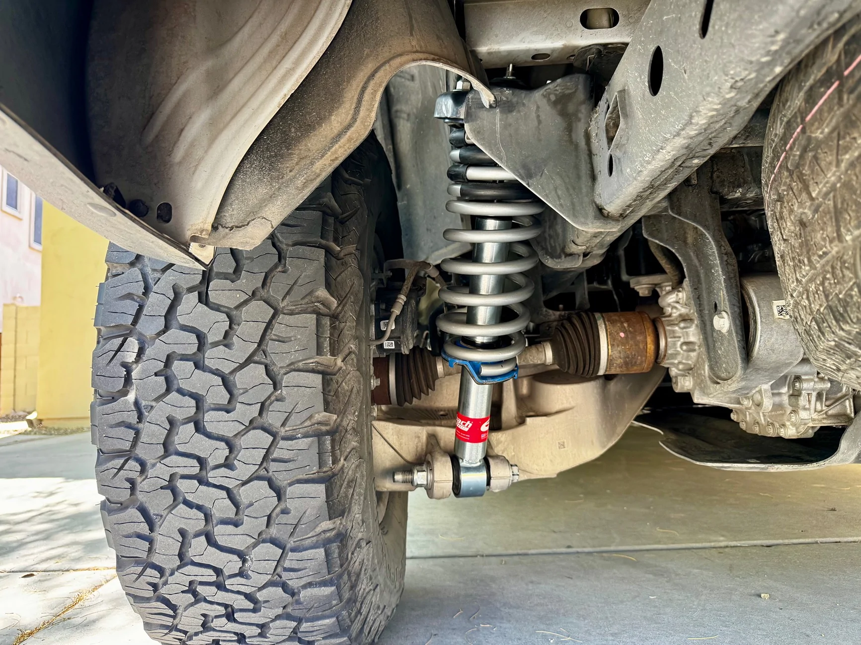

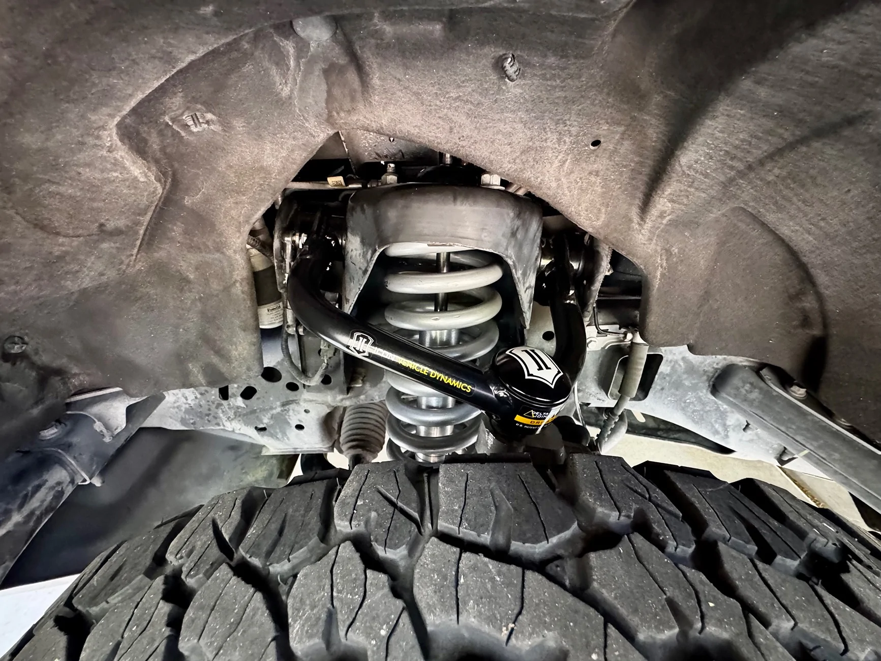

I went with Eibach lightning spicific stage one kit with Icon UCAs and couldn’t be happier. Two of my four OEM shocks were actually blown upon inspection when removed
Ford F-150 Lightning Aftermarket suspension options for Lightning?? IMG_9817
Ford F-150 Lightning Aftermarket suspension options for Lightning?? IMG_9898
Ford F-150 Lightning Aftermarket suspension options for Lightning?? IMG_9819

@AZT9 are your 1st and 3rd pics of the front or the rear? Looking at the Eibach website, the shocks and springs aren’t pictured as coilovers, so I was imagining that they were mounted conventionally. Good to see from your pics that they work as coilovers. Which model Eibach shocks come in that kit? Does it come with 4 lowering springs as well? Are the UCAs necessary or optional?
@21st Century Truck are your Eibachs also mounted as coilovers using the factory springs? Which model shocks?
Edit: I realized that’s the spare tire visible in pic 3, which would mean we’re looking at a rear shock/springs
