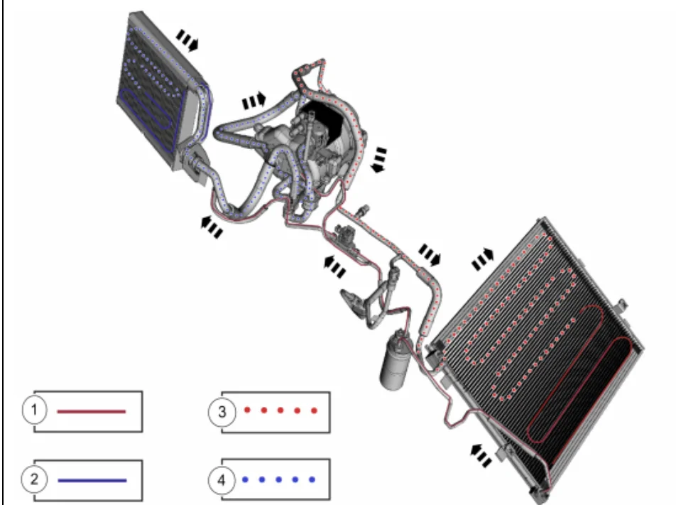

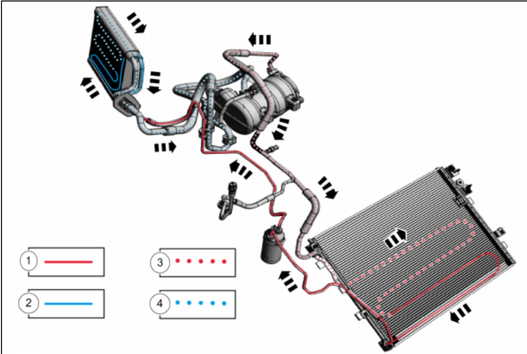

Yes it does. From my understanding and according to the shop manual there are two distinct, divorced refrigerant loops, one for the battery and one for the cab. But what I'm not super clear on is is there one compressor or two?
