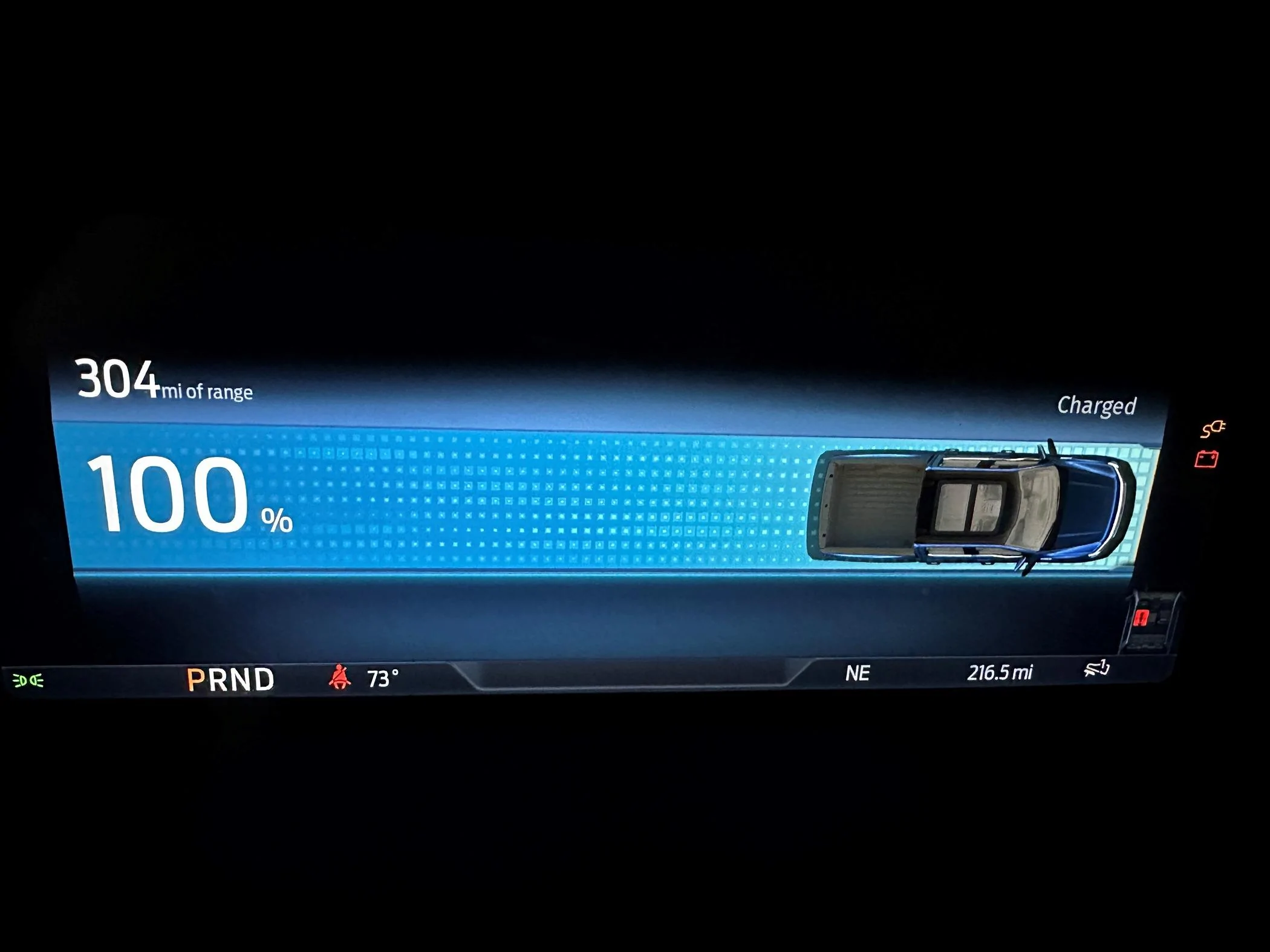

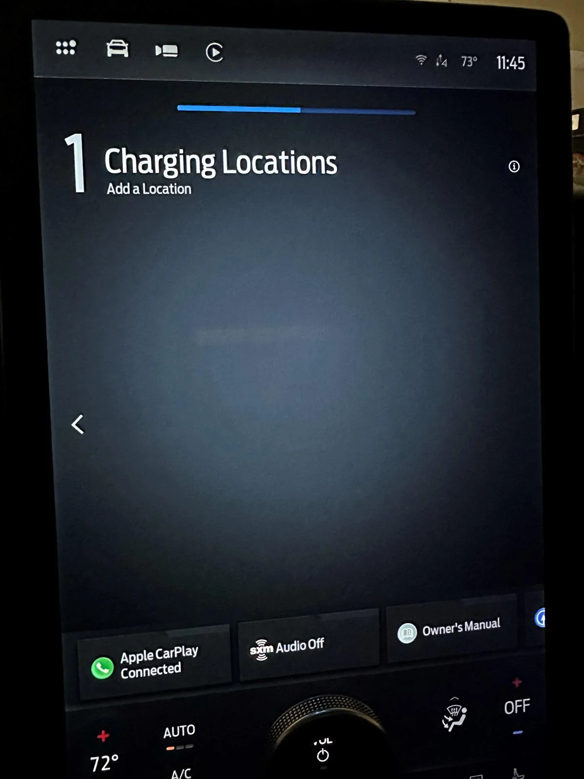

Thank you for the response. To add more clarity here. The truck is currently plugged into my level2 charging at home. Here are photos while it is plugged in at home in my garage and at 100% charge. Additionally, all gps and cellular data services are Enabled, and the Truck is connected to my wifi at home. Issue remains regardless of whether it is on my home Wifi or not.
I am not sure if it related but I am also not able to use the Navigation features at all even though it is enabled and the service plan is active.
It shows I do not even have the option to Add a Location:

Hmm. Seems like the Navigation has to be working so it can get the GPS to offer a charge location. Sometimes the default name of a location is just the GPS coordinates (can easily edit the name later).
Been a while since I did this. Hopefully others will chime in.

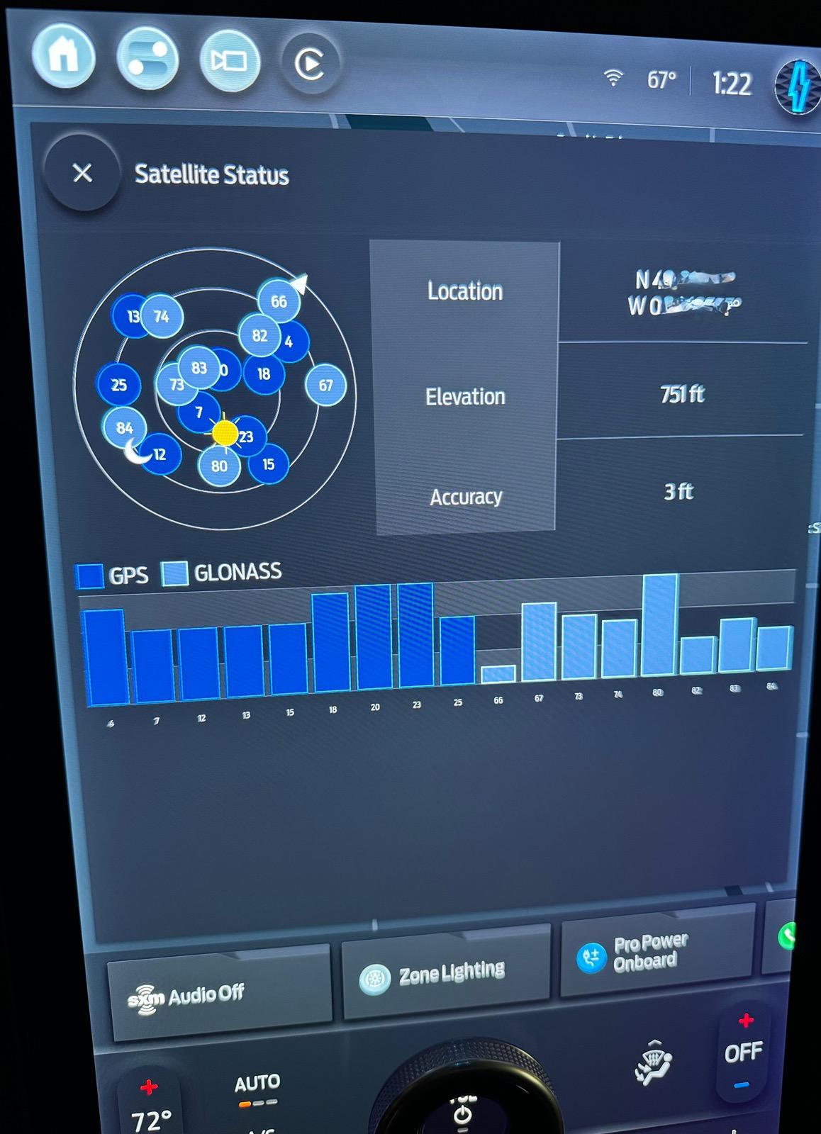

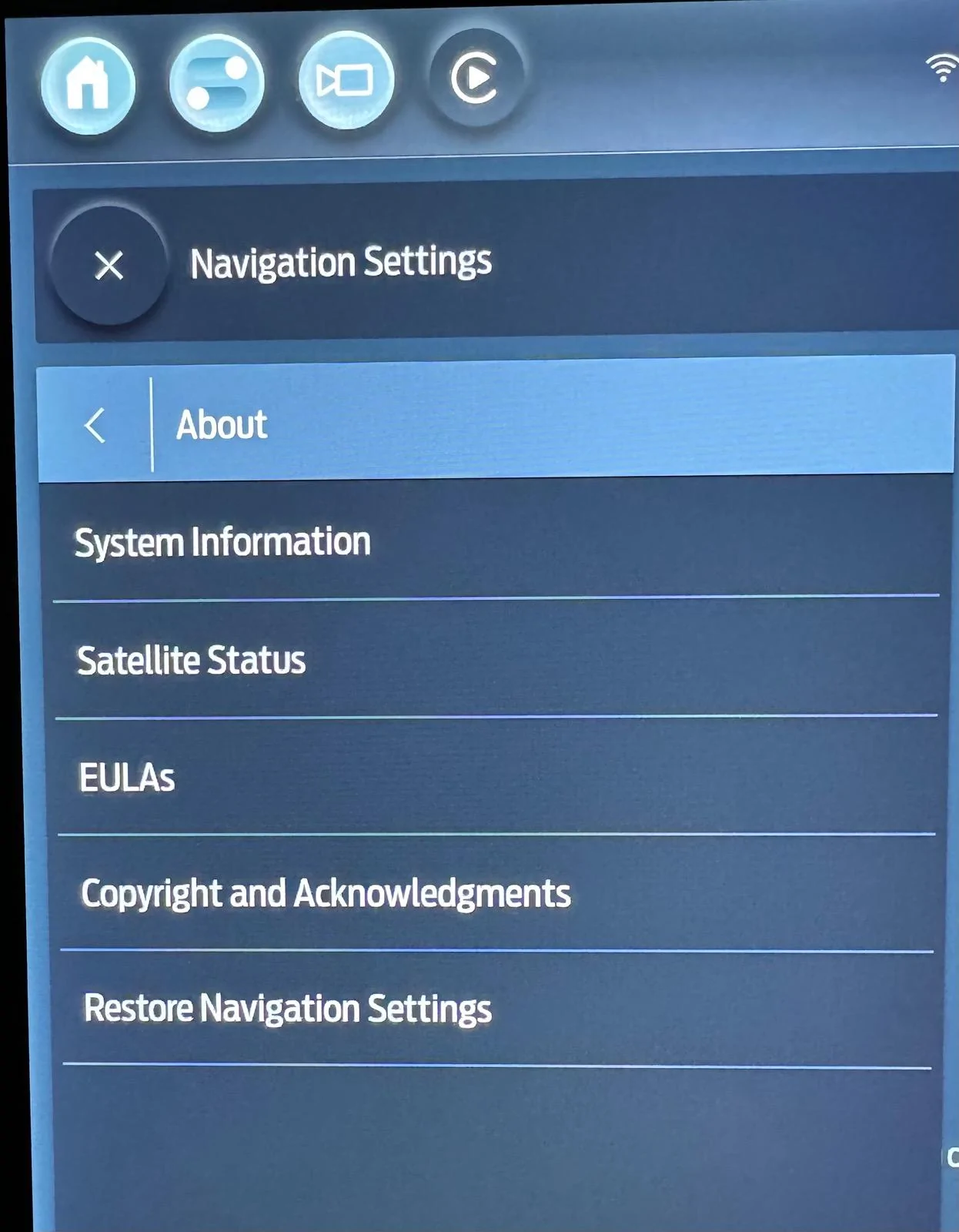

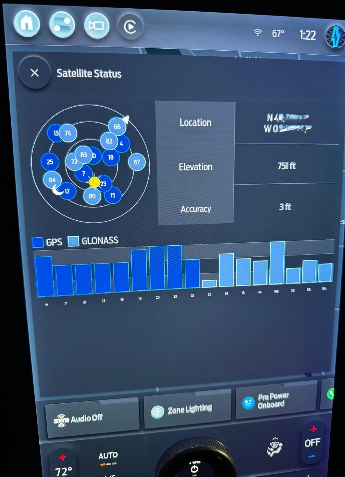

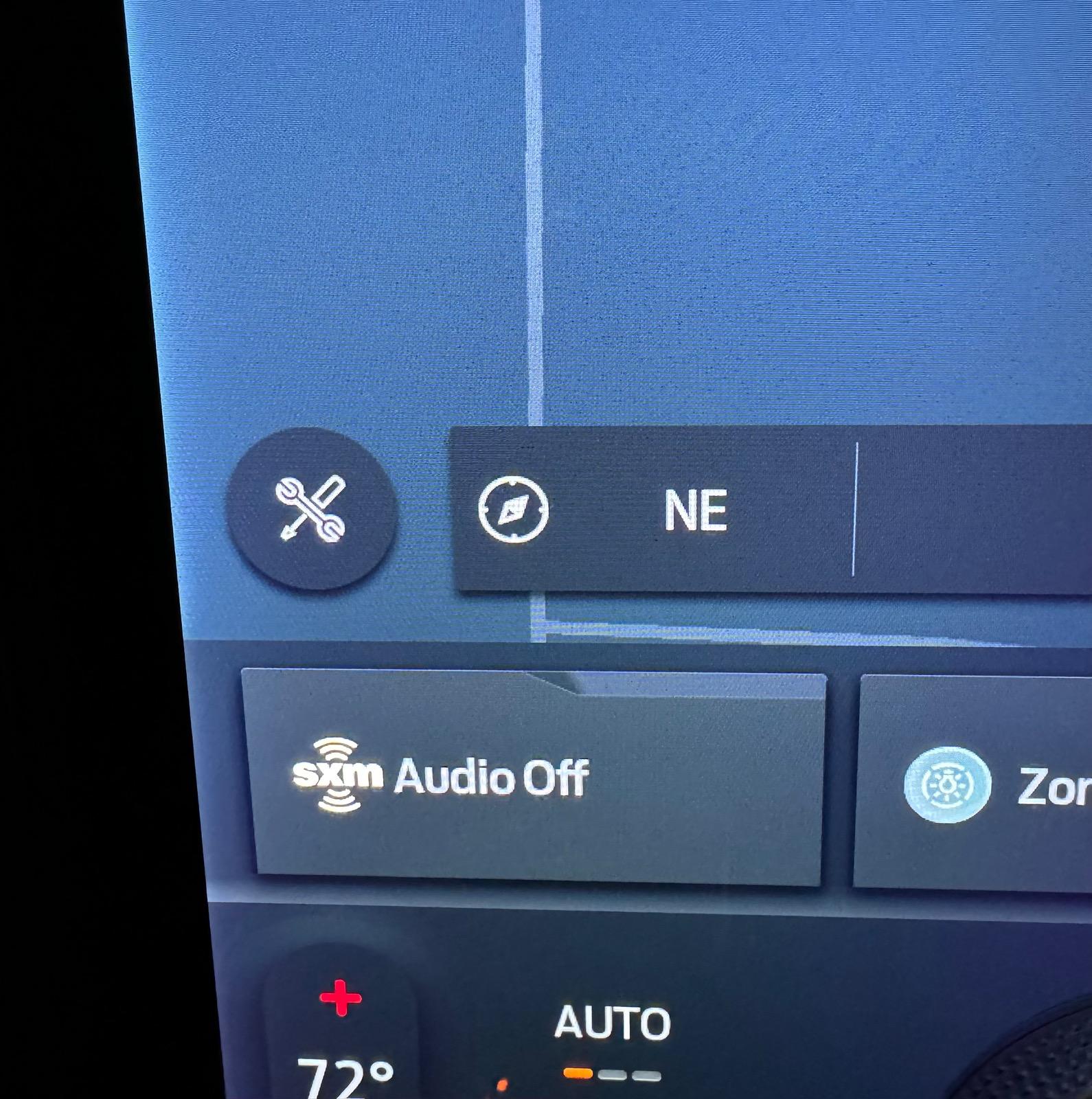

You can also check how many satellites the Navigation is picking up. Start with the Tools icon in lower left of the screen. May have to be parked outside to get good reading.
It's funny I just found this. Nav and Satellite Status will work if I unplug the charger. Getting great Satellite signal in my garage.
