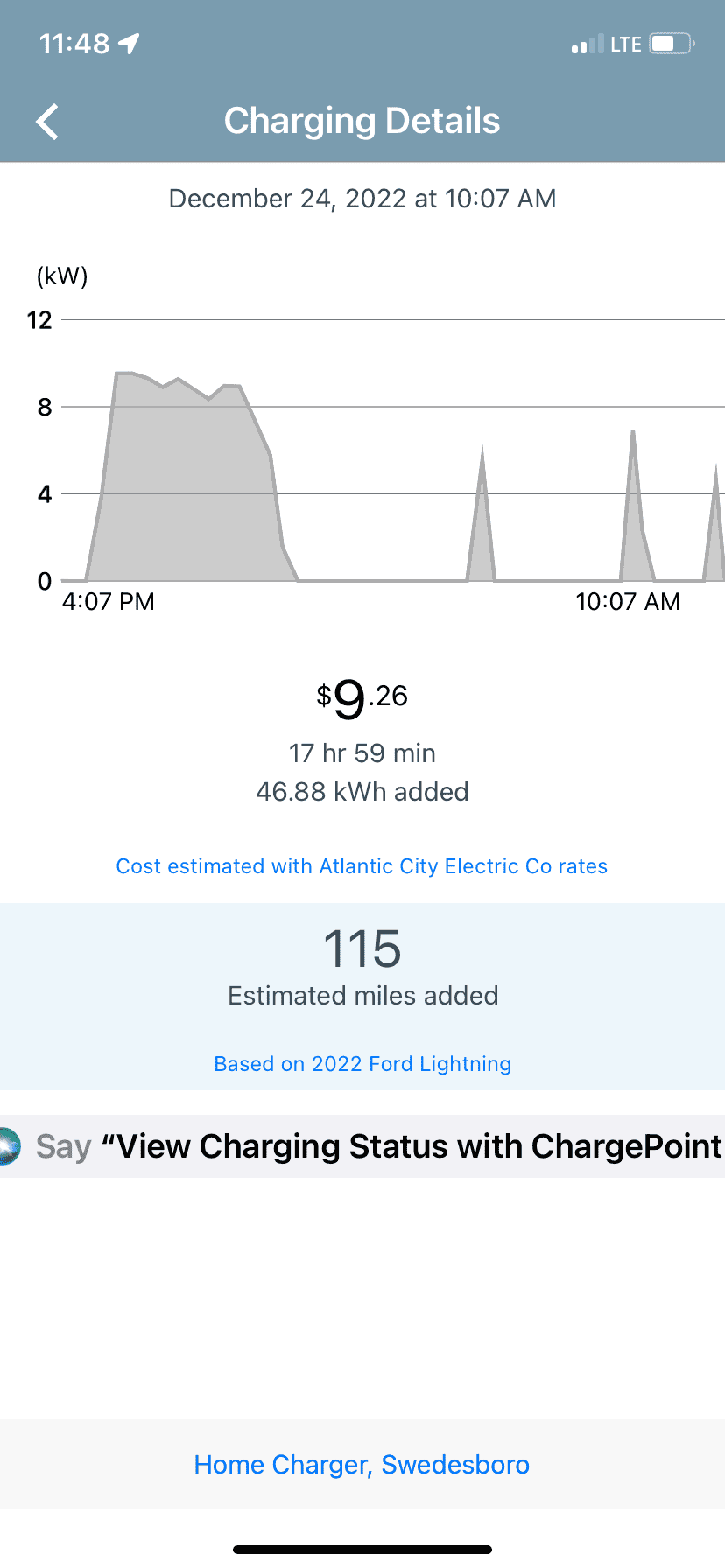

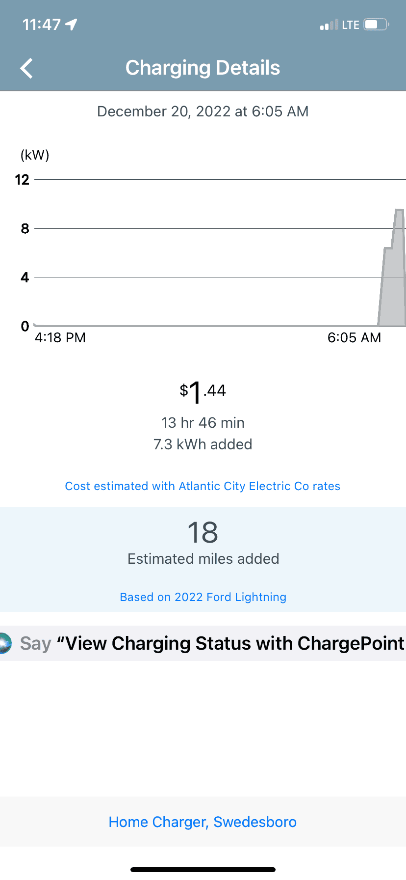

Data/Kw from my home ChargePoint charger, includes:
Charging on the left side of pic, then periodic current draw to warm battery in extreme cold temp on right side.
Other pic is preconditioning, which started about an hour prior to departure time.
