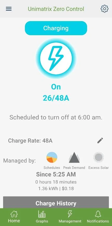

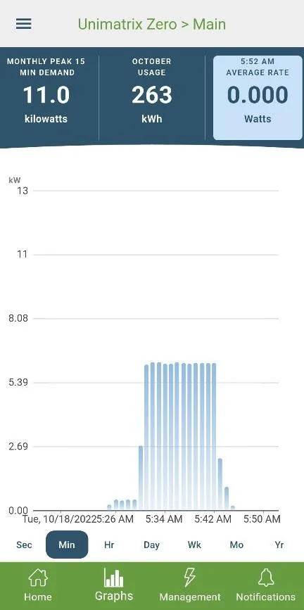

I set my truck to precondition. While it was doing that my Emporia charger recorded a 26 amp draw, or roughly 6kW.
Interesting data point, thanks!
