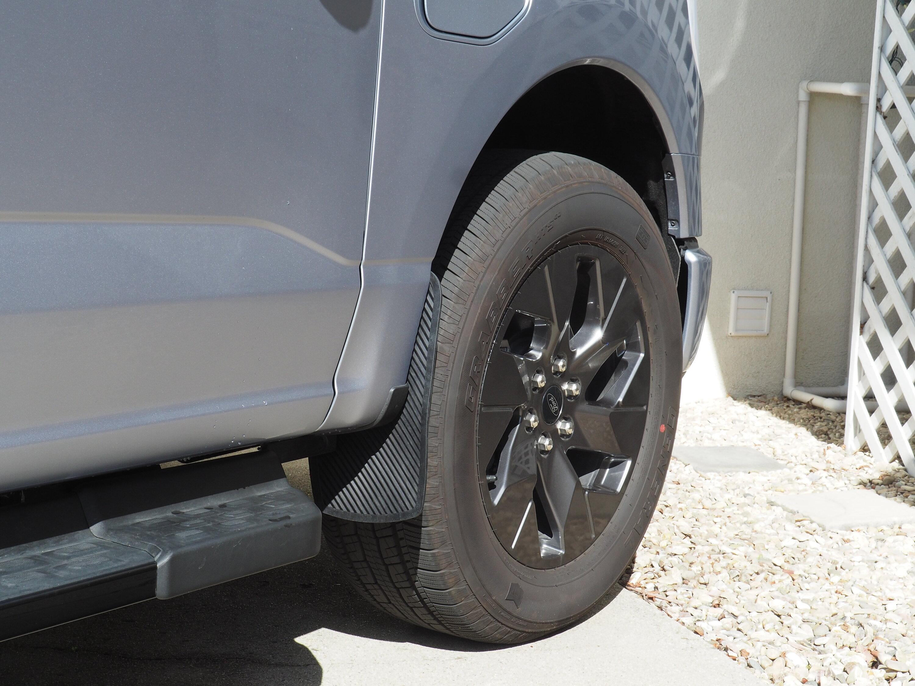

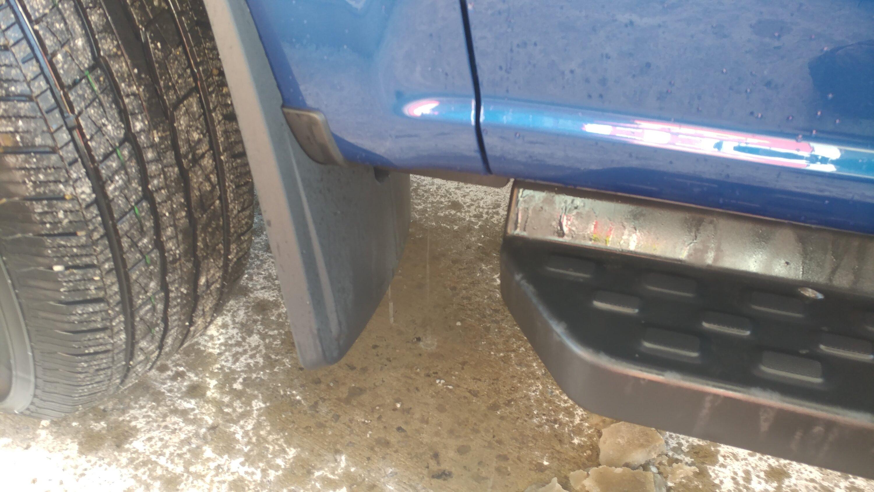

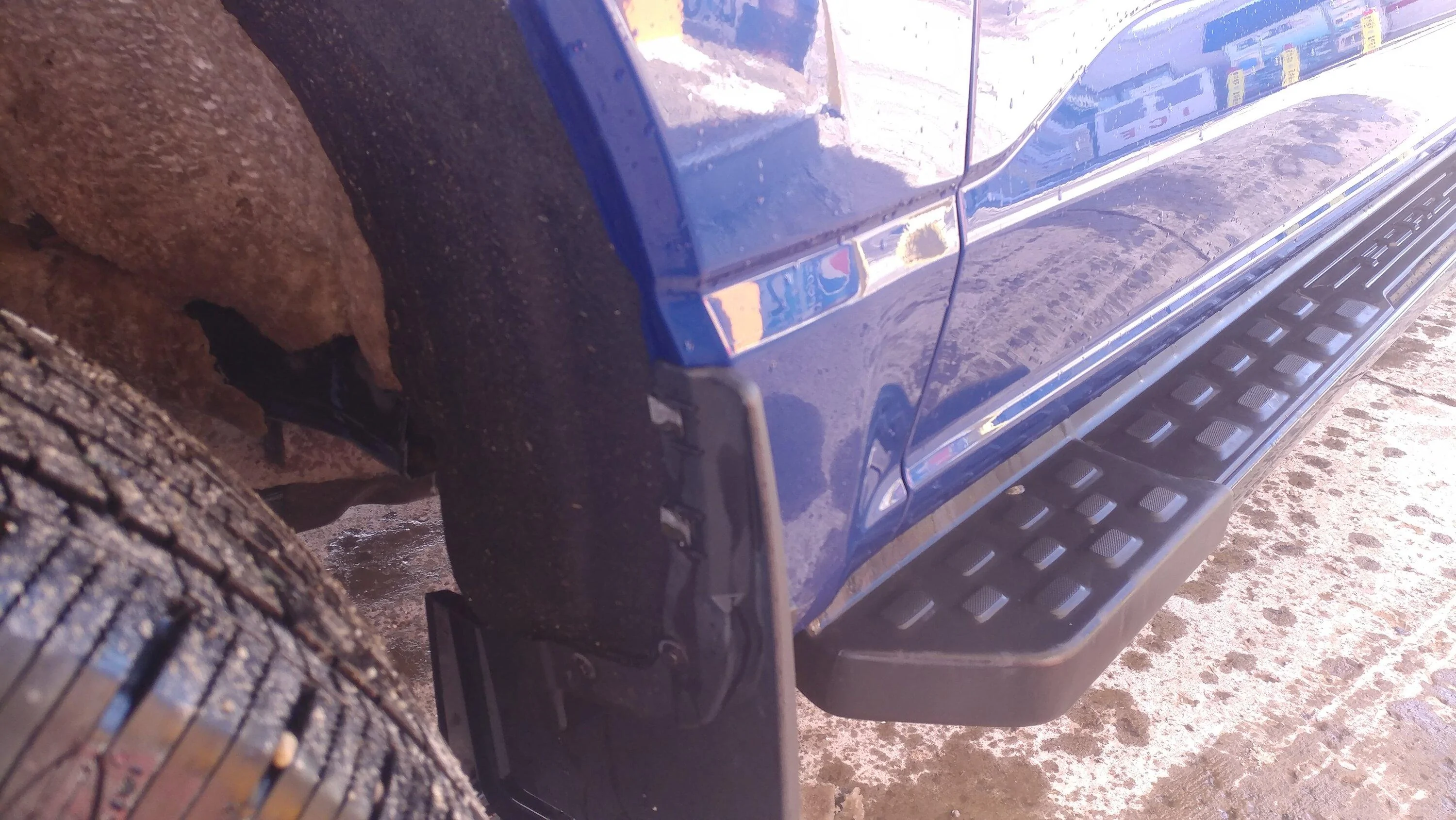

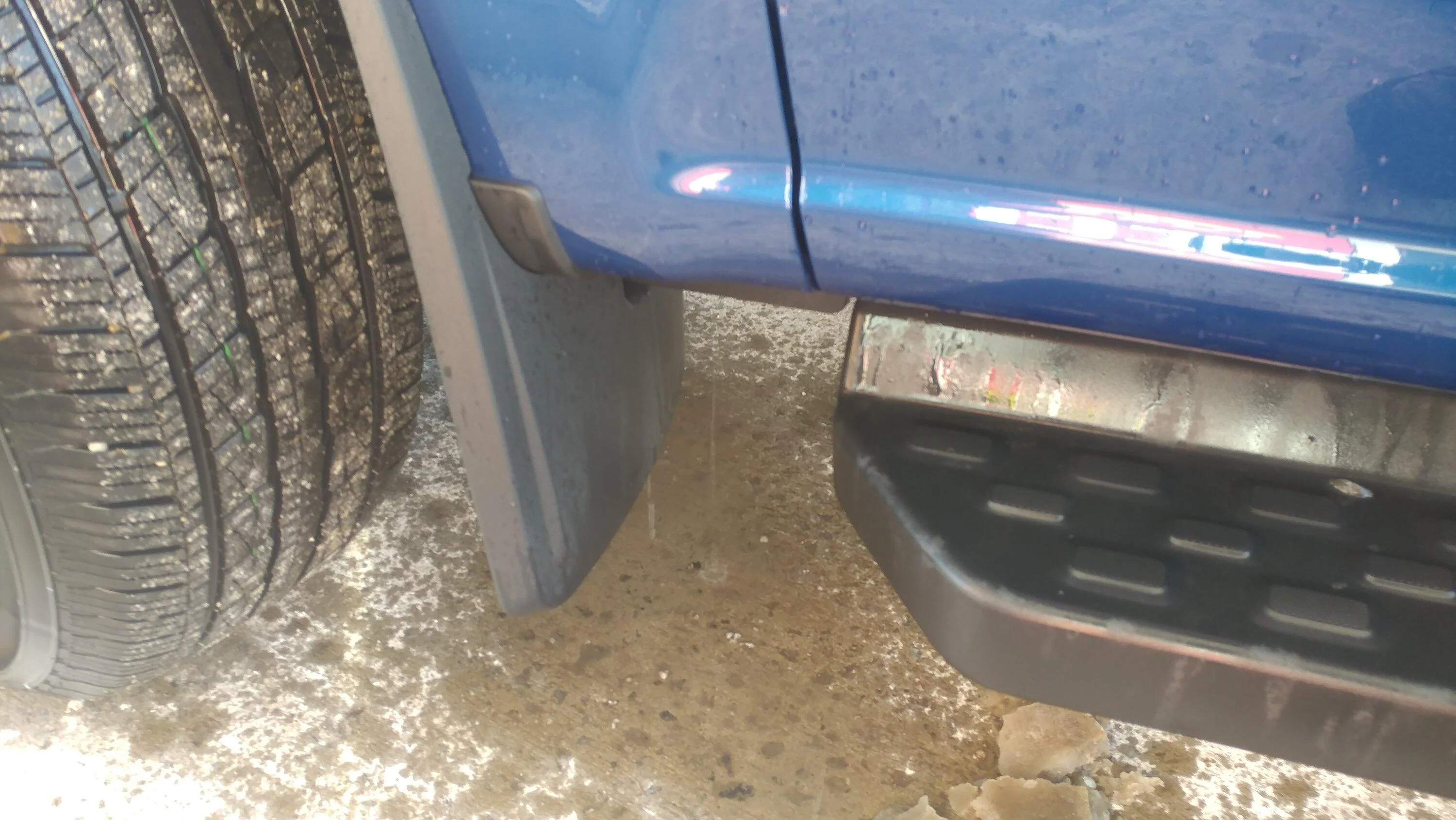

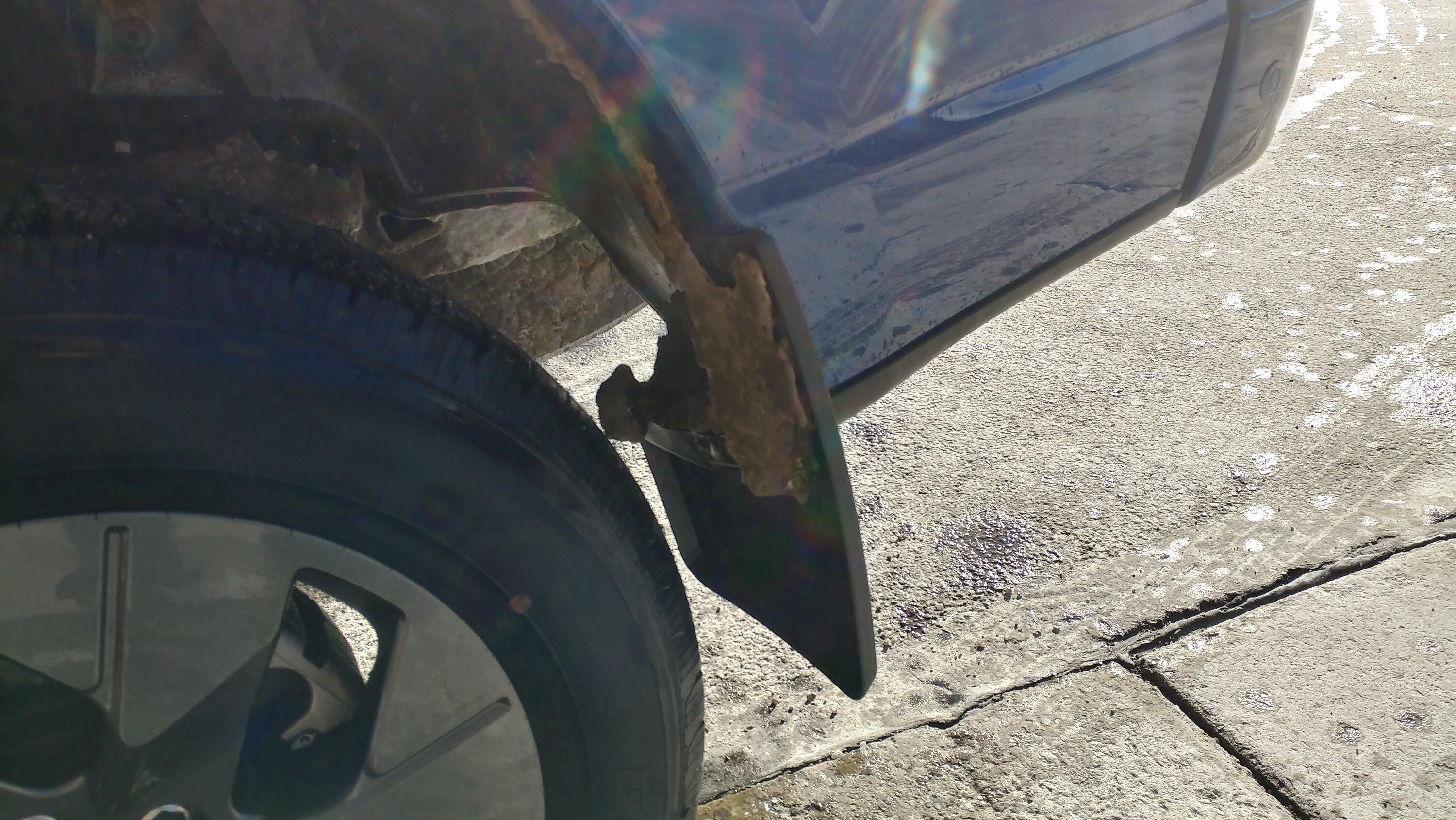

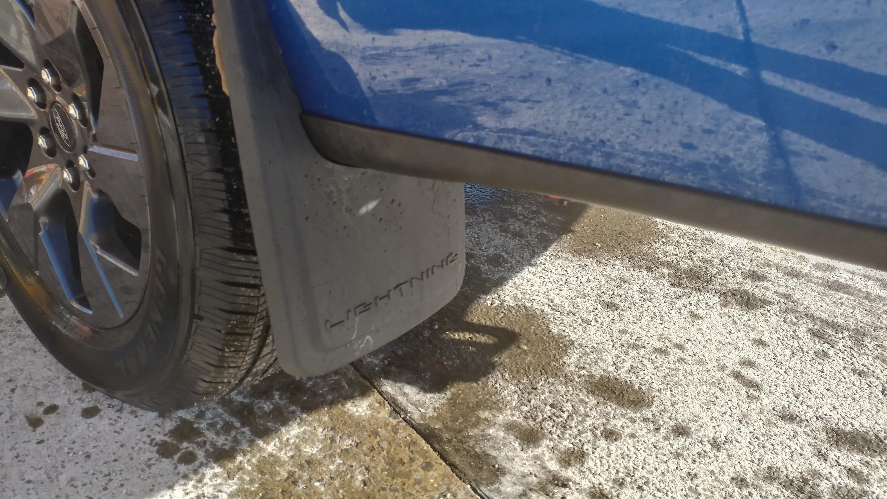

These are from Ford Accessory. Fairly easy to install, looked up different YouTube tutorials on attaching. Needed a 7mm and 10mm sockets. And a harbor freight body plug remover tool. The rear guards have metal brackets. I hope the metal is durable from road salt, maybe stainless steel? I spray painted it to help give it a protective coating before installing. Road salt brine is rough on everything.

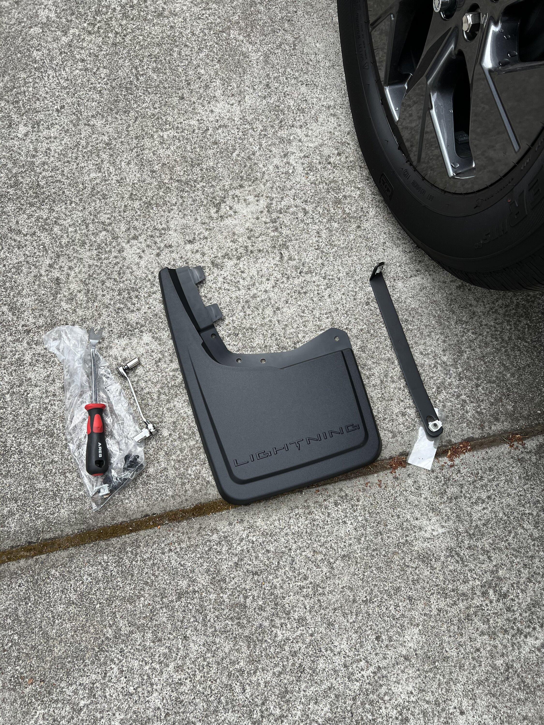

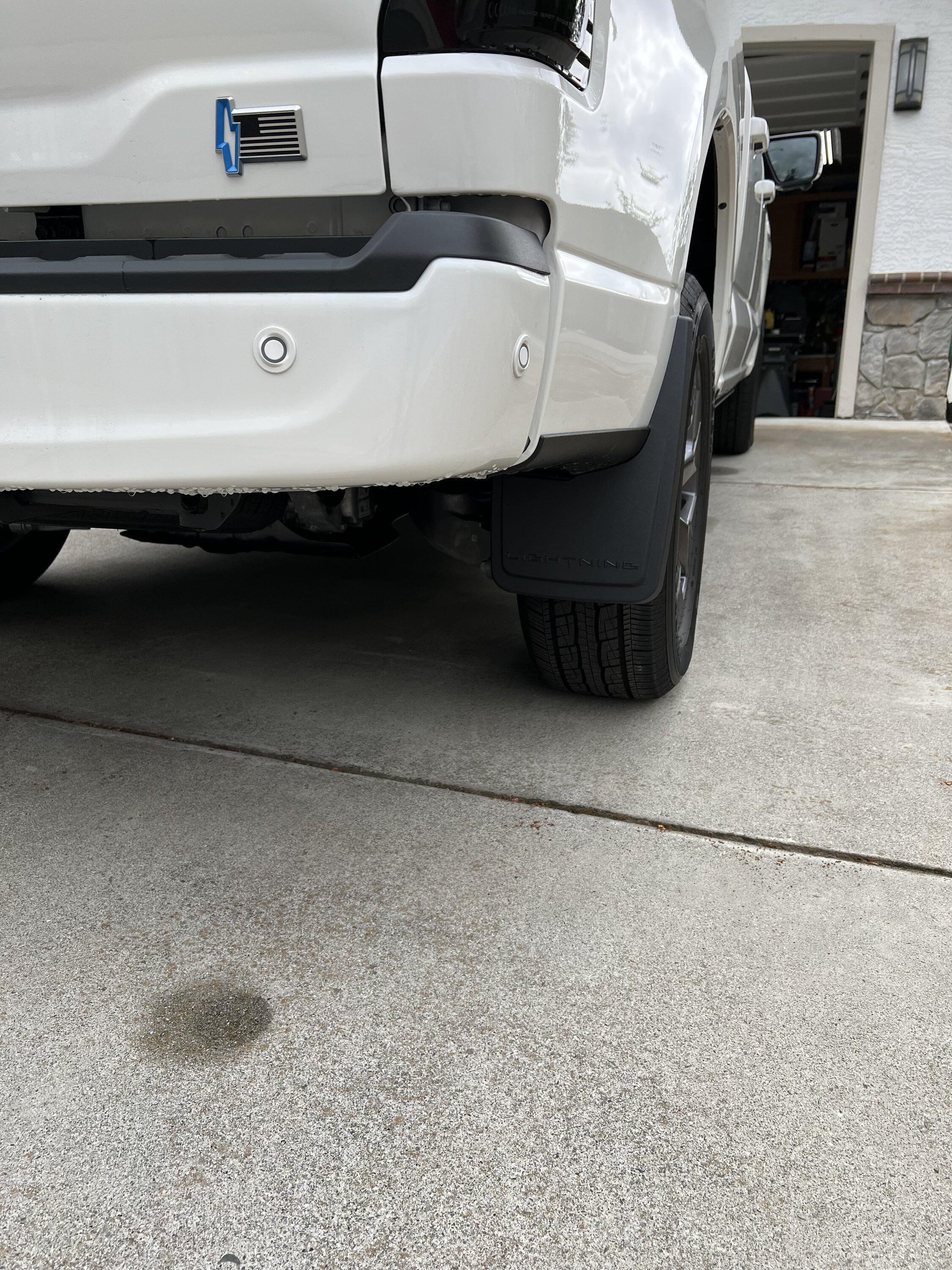

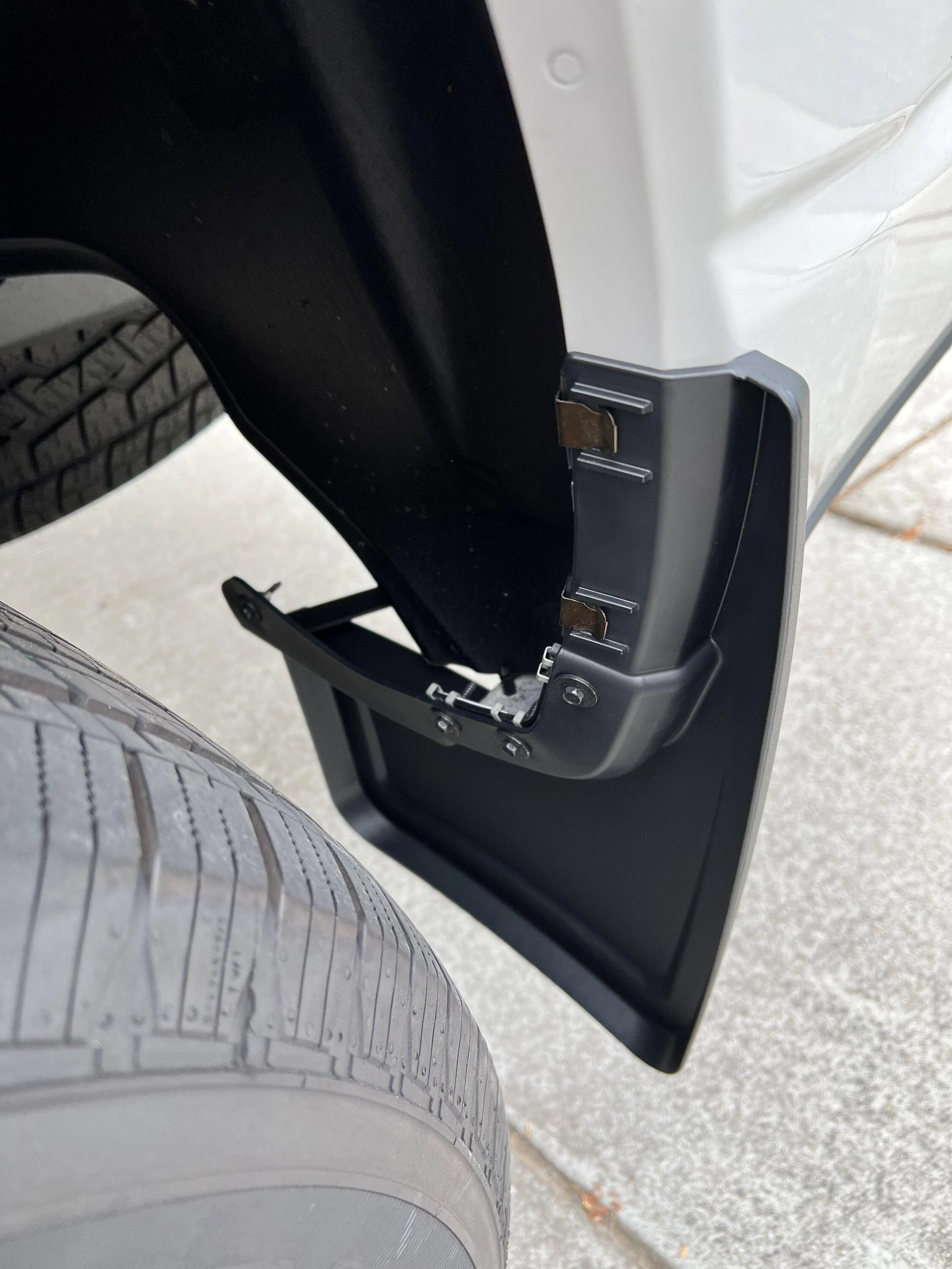

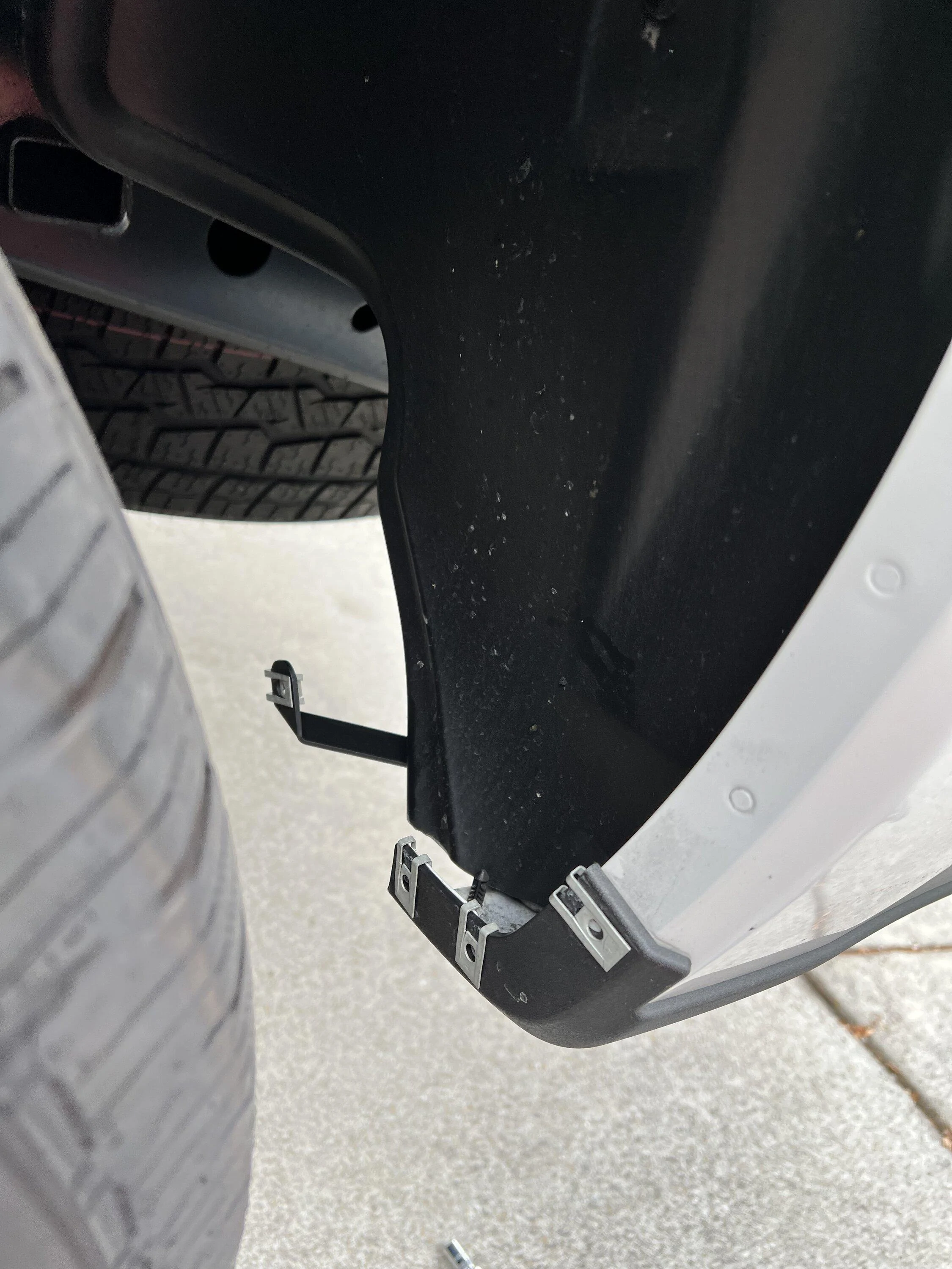

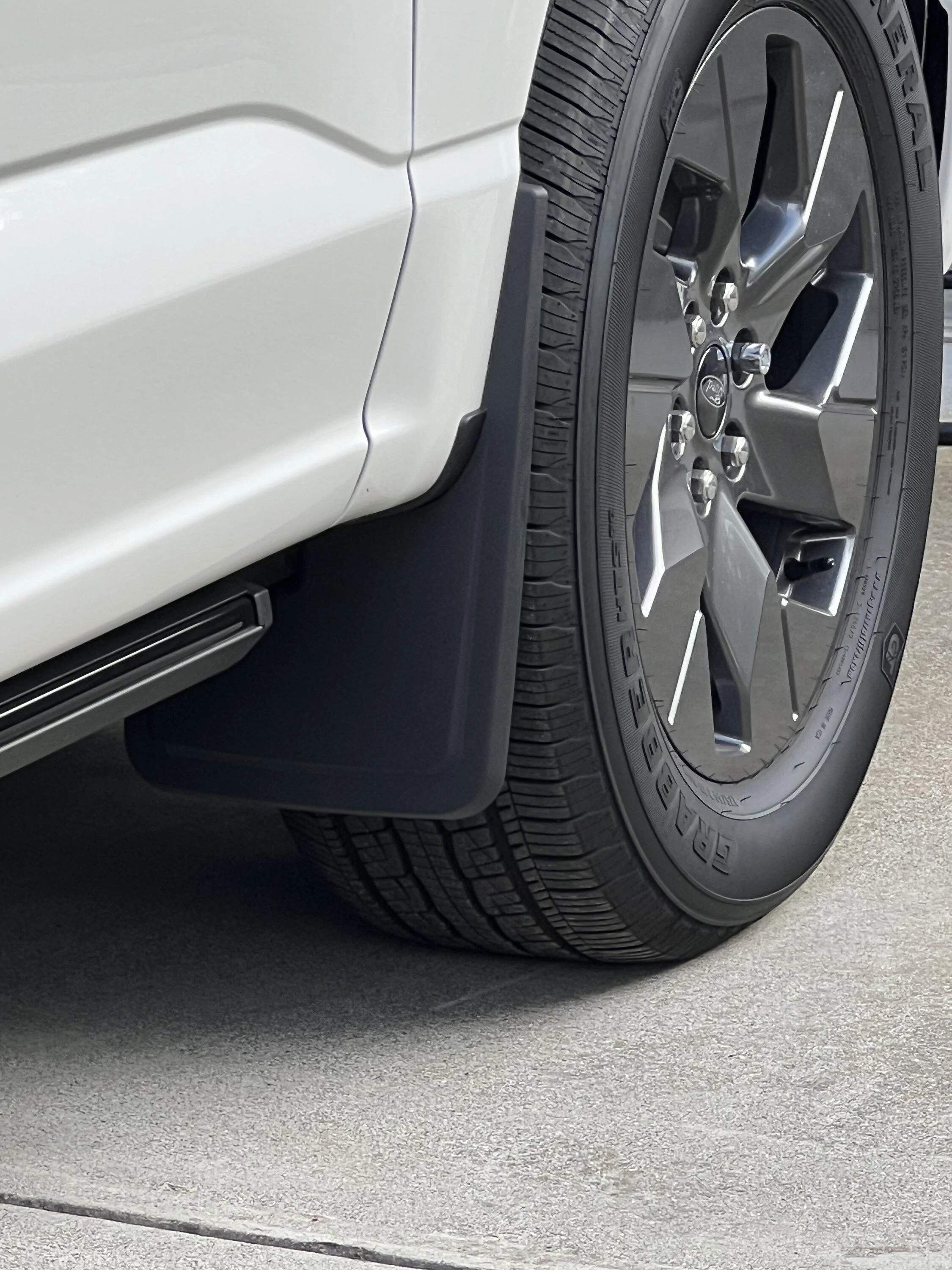

Here are a few more install pics to add to yours to help others see how these go on. It is easy, and I painted my rear braces as well.
