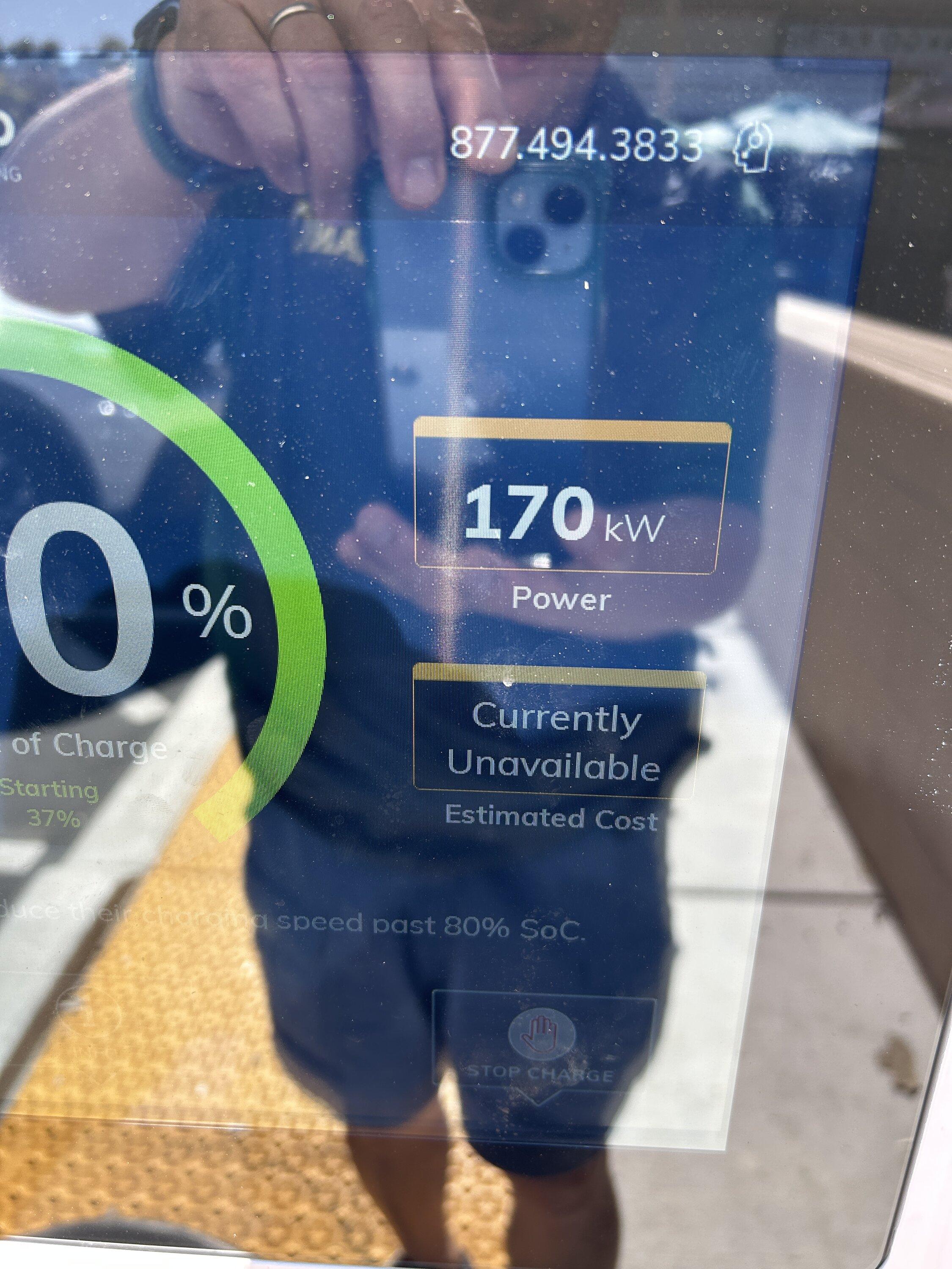

I use EVGo most of the time since they are numerous around me.
I like EVGo - especially the 350kW hyper towers - it checks for connection, voltage tests, insulation tests and then starts charging.
Might cost a bit more than EA, but availability is high - app is live - no waiting for free VW iD4 driver - no down chargers like EA - 170kW rate!
