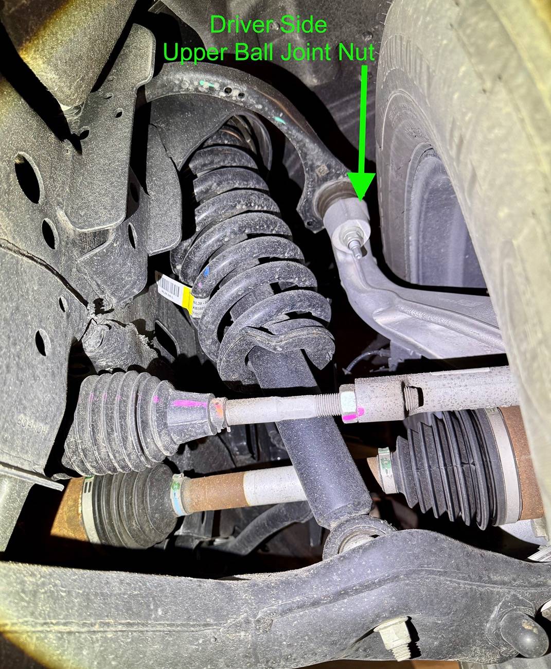

Did your Lightning get its upper control arm ball joint nuts checked under the recall last year? I would visually inspect them to see if both sides look consistent.

Thanks for the tip and photo, both sides look at/the same. Pretty heavy duty stuff under there
