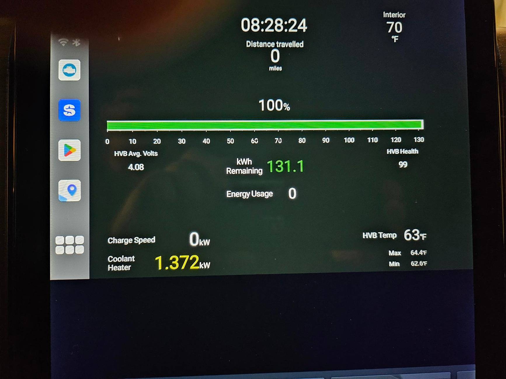

What TaxManHog said. This is the exact behavior my 22 Lariat exhibited after a battery module swapout. I took mine back to the dealer and they called back the same day and said Ford told them it would take 21 days for the truck to relearn the correct battery capacity. I would run it down to below 10% battery remaining then do a 100% charge. Each time it did that I would gain a few percent before it would do the jump to 100%. I did built an app that let's me display the essential battery data on the Sync Screen so I could watch the max kWh available increase with each 10-100% charge as well.
Well, it did eventually relearn its full battery capacity. It did however take a lot longer than 21 days, though. It was closer to 21 weeks. I got the truck back the first week of April but it wasn't until a few weeks ago that 100% was equal to 131 kWh available - and the battery health has jumped to 99%.
I may have been responsible for the extra time though as I did some tinkering with FDRS to force the battery to relearn its capacity. Everything is great now. There were some power limitations, but those went away as the "relearned" capacity got above 100kWh or so.
Here is a photo I took of the blessed full capacity event.
