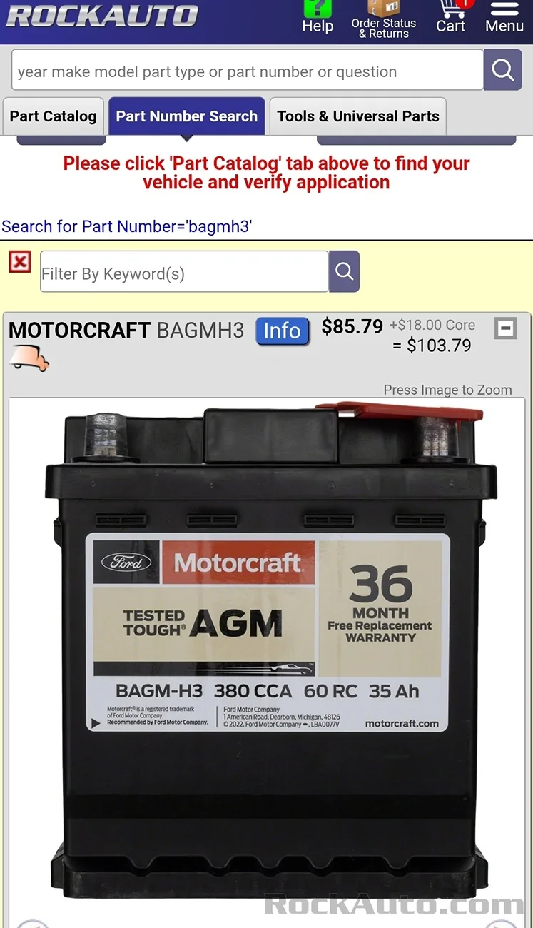

Yes, that Rockauto price is correct plus shipping and tax. Mine was $125 including both when i bought mine several months ago. You can technically mail back your core, but I believe you have to pay shipping. I just held onto mine. I think you can take it to OReilly's for a $10 gift card.

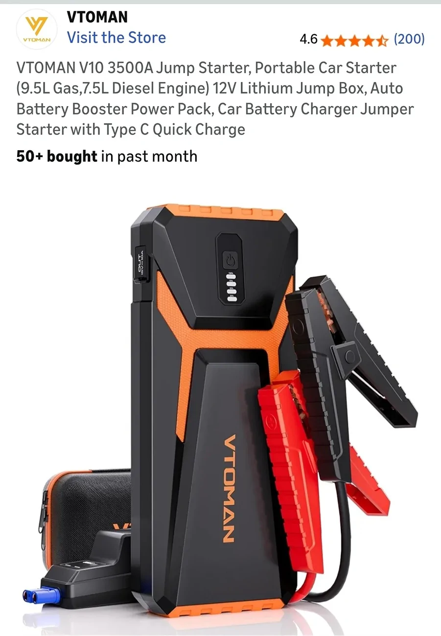

So the temperature is certainly not it. I'd just carry one of those little jump boxes and press on.

Thank you! Bought the Rock Auto battery and installed according to all the directions posted... seamless
