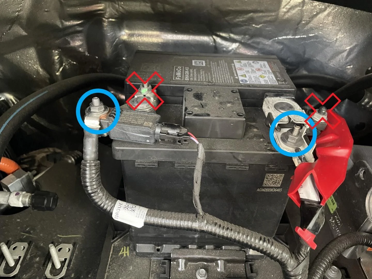

For charging, it's okay to use spots in the battery compartment as long as the negative is downstream of the BMS. I have a post here on the process. But here's a pic (blue circle OK, red X not OK)
The problem for me with the jump spots under the frunk side cover is there are about 10 clips to undo and they sometimes break.
That would be more simple for me too. I can try that.
So I need to reset the BMS and then charge the battery using the blue spots in the pic. I'll try that.
My research indicated you don't need to reset the BMS. The BMS tracks the age of the battery among other things. When you reset it, it tells the truck you have a new battery (see point 3 in the process link I posted above). Whether the truck uses the age for anything, I can't answer.
Ford's Service Manual for the Lightning doesn't even have the tech reset the BMS after battery replacement.
