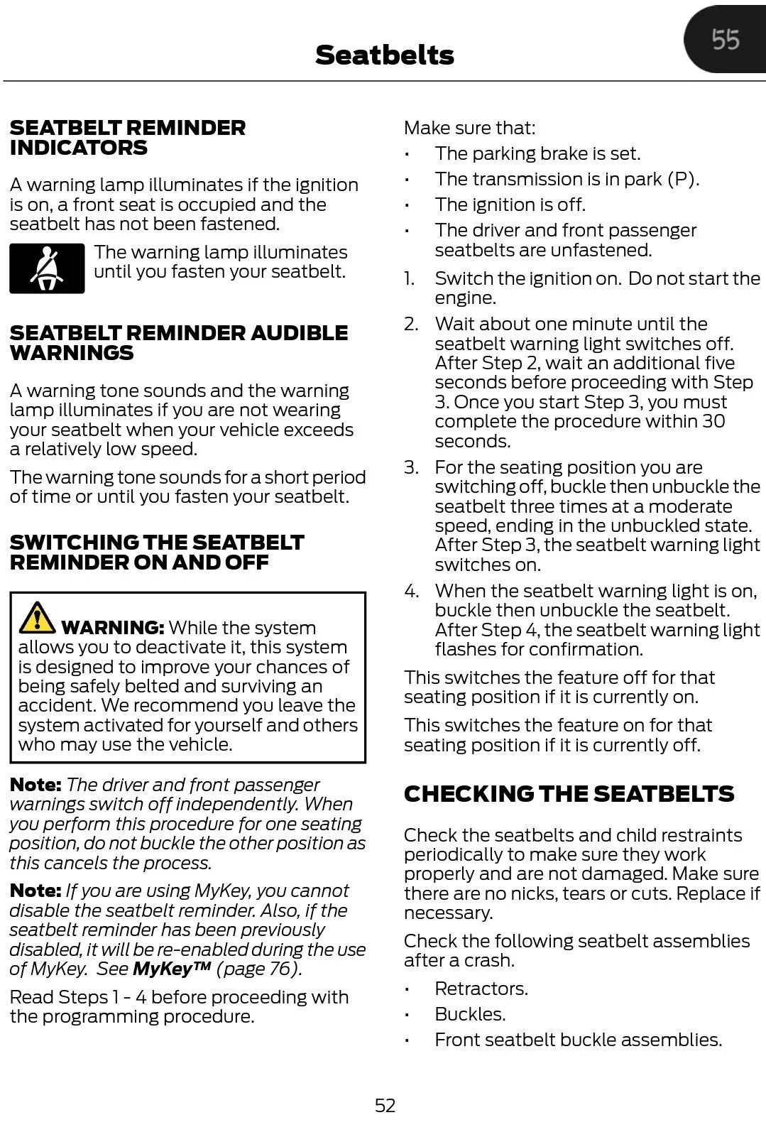

As someone who has had previous Ford vehicles, I have always disabled the seat belt warning chime.
I do of course wear my seat belt when appropriate. But I detest getting pestered by it when I am maneuvering at slow speed (like in an open field).
In the past this was called BeltMinder. I've scoured the online manual, and haven't found any reference to how to disable it on the F150L. Anyone familiar with how to do so?

It's in the manual. You can download a .pdf copy and review it. It's not in any menus.
PIONEER,
THANK YOU so much for posting this!!!!
I didn't know shutting off the seatbelt chime was possible, I did the above procedure and it works like a charm. (P.S. you must be sitting in the seat as you complete the steps)
THANKS AGAIN, APPRECIATE IT!!

Well, when you do switch off the seatbelt warning sound, don’t open your door while your truck is in motion…the truck will immediately/automatically shift to PARK!
I’ve made this mistake…..once?. You don’t want to, especially after the first jarring time!

Thanks for posting this, last night I could have used it, my buddy hates seatbelts and we endured the 5:34 minutes time it took for the minder to time-out, I'm setting this to OFF for future runs with him onboard.
UPDATE,
I was able to disable the two front seats.

Question: Does the disable process allow you to select the individual seats, front/back, or is it all seats/none?
****EDIT****
Answer: Read this thread more carefully ?: https://www.f150lightningforum.com/forum/threads/belt-minder-disable.13075/post-276855
Did you even click on the manual page that was posted? It literally tells you...:(
Oh yea, I had read it and knew….I was just being stupid and not thinking in the moment…sometimes behaviors need to be reinforced through mistakes (hopefully not fatal)?‍?. This one now is engrained in me like Pavlov’s Dog!
