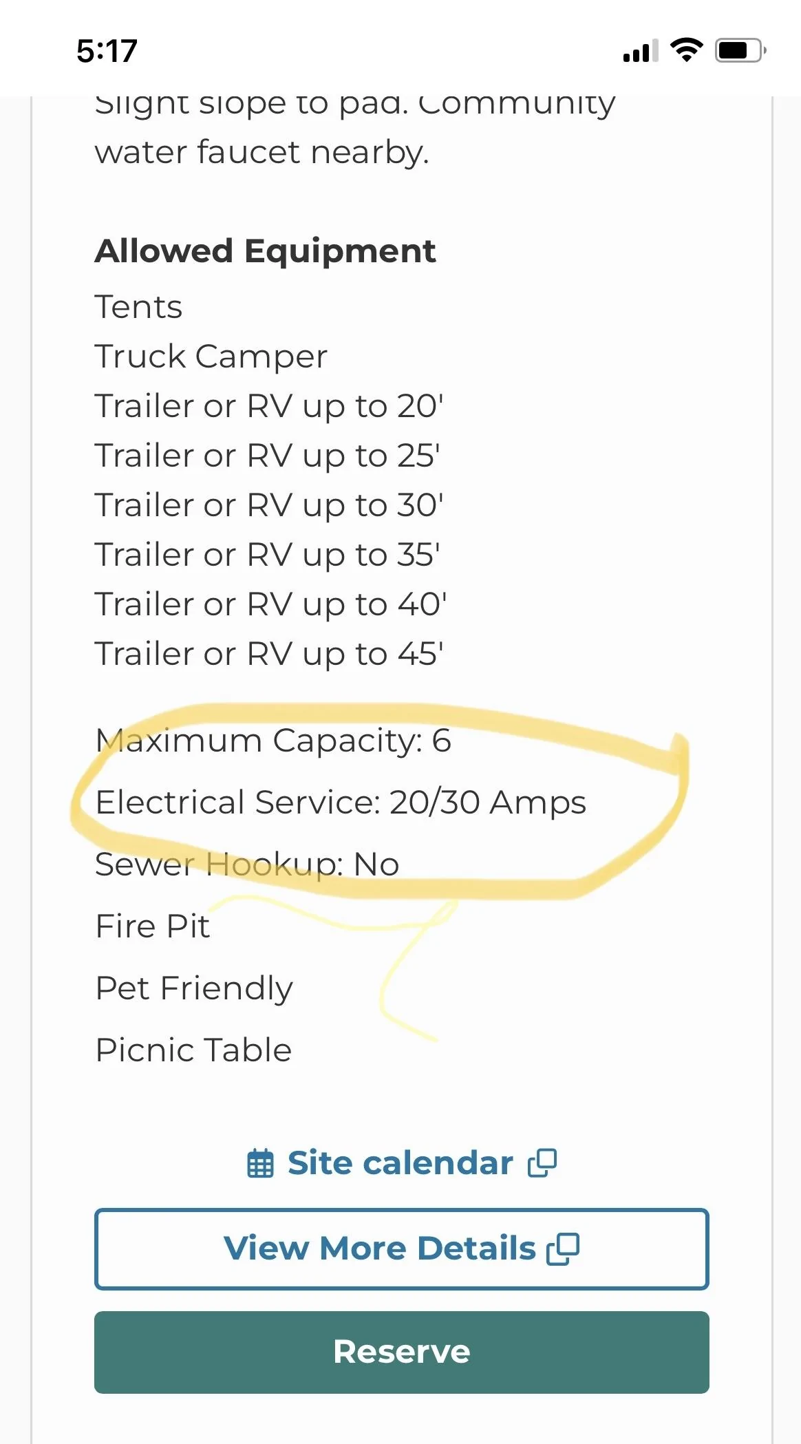

I’m going to be camping at a site that has 20/30 amp plug. This is how the site is listed:
Ford F-150 Lightning Campground charging at this site? CBBB2D5B-F77C-4F37-B46E-458F67B0D5EC
Will I be able to charge with the provided Ford mobile charger as is?
If so, how long might it take to go from 10 to 90%?

30 amp camground plugs are usually 120V. The on-board charger is limited to around 10 amps (1.2 kW) when using 120V.

You can charge but the Ford charger on a 110 like plugging in at home. Will need variable amp charger and TT-30 EV adapter to get anything faster.

You will not get more than 10 amps with a TT-30 adapter or any other 120V source.

The truck won't take more than 12 Amps at 120V. Just use the standard plug in a 15A or 20A circuit.
For the OP, what state of charge will you arrive with, how long will you be there, and how far away is the nearest DCFC? Figure on two full days of charging to recover 50% of your SoC.

Assuming you are using Ford's mobile charger, look for a campground that has 220/240v, 50 amp service with a NEMA 14-50 plug. The Ford charger needs 32 amps to run at Level 2 (about 6 kW/h).
