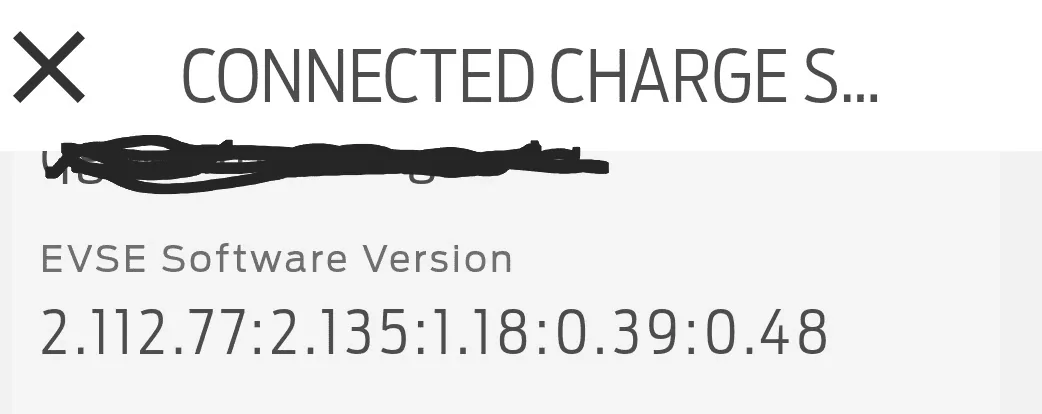

Have you tried power cycling the FCSP?
Unplug truck from the EVSE, switch your 100 amp break off for 5 minutes, then switch on, let the unit run for ~15-30 minutes to finish any updates that might have been pending.
If it's still failing, confirm what the firmware version is, this is the latest on my unit, as viewed on Fordpass connected charge station tile, settings menu, if you do not have this, leave the truck unplugged overnight to allow a download and update to post, repeat the power cycling.

My software version is 2.112.64:0. We have tried your suggestion, but the device is fried. You can actually smell burnt electronics on it. Factory reset button doesn't respond. Cannot connect to charger with app. Installing electrician has confirmed that this is the 5th unit that they have installed that has failed in the same exact way.
