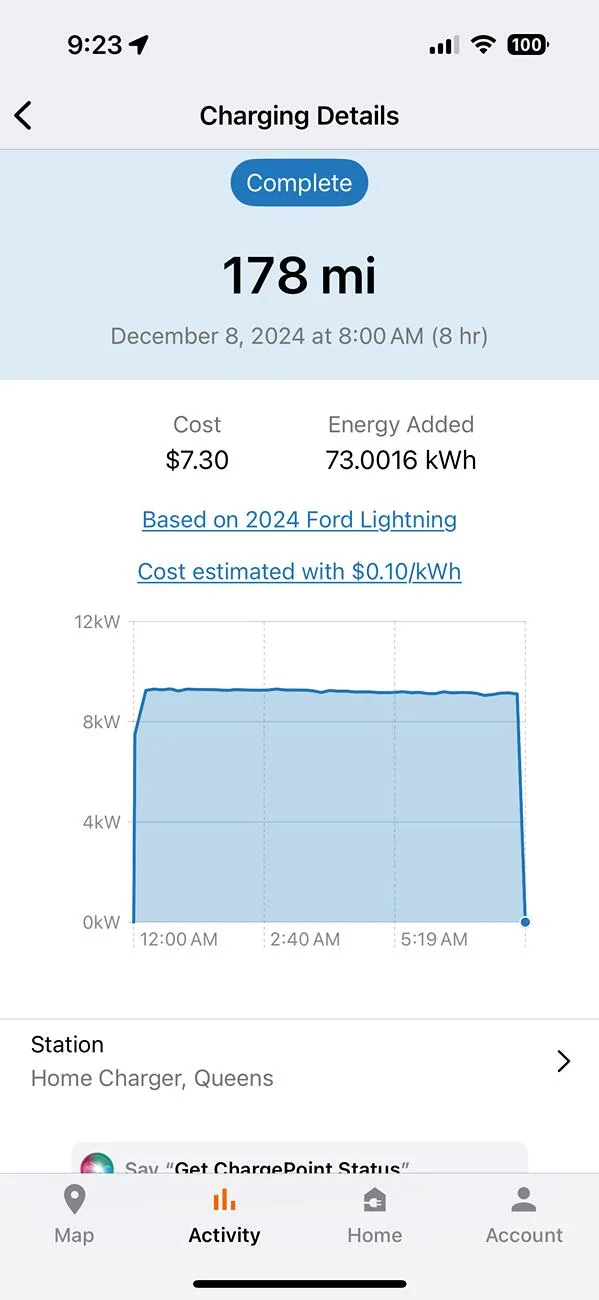

Problem is i have it set at 80amps on app, thats what im not understanding. On another note, charger says 6awg is max wiring, but how can you get 80amps with 6 wire. Doesnt make sense.
The truck on-board charger tells the EVSE how much current it can handle (through J1772 signaling) and no matter what your app for the EVSE says, the truck will only ask for the max 48A it can handle, and that's a good thing - would not want to over load the truck charging circuitry, bad things would happen.
The J1772 control pilot signal, also known as the CP-to-PE line, uses a square wave to indicate the maximum current an electric vehicle (EV) charger can deliver. The Control Pilot is used to negotiate charging level between the car and the EVSE, and it can be manipulated by the vehicle to initiate charging and can carry other information. The signal is a 1 kHz square wave at ±12 volts generated by the EVSE to detect the presence of the vehicle, communicate the maximum allowable charging current, and control charging begin/end.
Wire: #6 is for a ground, and #3 would be used for carrying the current (hot1 and hot2) assuming 80A continuous load (100A breaker).
For your max 48A continuous load (60A breaker) you could down size the wires to #6 for the hots (assuming a 90 degree rating and it is THHN or THWN-2 copper) and downsize the ground as well.
But check the installation requirements for your EVSE to get the correct wiring. And think about future proofing as other posts mentioned - maybe you want to be 80A capable for the future when you have a vehicle that can use the full 80A capability.
A hardwired EVSE has terminals designed for a particular maximum and minimum diameter wire and too large or small wire could cause problems. The wire needs to be torqued to the specification of the EVSE installation instructions as well.
All the details are why using an experienced electrician to install the EVSE is recommended and why inspections are generally required in most localities.

I switched everything back to #6 awg thhn and 60amp breaker. Thats max rated in the charger terminals. Theres no torque spec since their just push tabs. This is the max output i can get on my truck.

I did i re install the charger in app and set the settings to 60amp breaker. Thats the highest charge i got on the truck. I thought you can change the amp settings on the app but you cant you gotta reinstall the charger in app to do so. Kinda sucks
