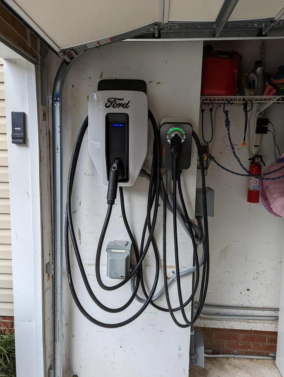

Michael…..I have the exact same set up at my garage. ChargePoint Flex and the Ford Pro Charger. The Flex is on 60 amps C/B and the Pro on 100 amps C/B.
This is how it works at my place and I have my issues to resolve with this Siemens build Pro charger.
Initially, the Pro will draw up to 16KW rate but it will not maintain that charge level thru out the charging session. If it maintains that charge level, it will shut down numerous times from overheating. (This is where I am frustrated with this charger). Siemens is not keeping up with the charger updates or is constantly changing the charge rate. I’ve been kicking the can down the driveway by not getting up with Ford on this issue.
The Flex on the other hand is the second one that I have installed.
I had to request a replacement.
The first one charged at a max of 48 amps on 60 amps C/B. Configured also on the 60amp setting.
Upon replacement, I configured it again for the 60 amp setting.
Charge Point decided to send updates to many users across the country. They derated the chargers to draw a max of 40amps, irregardless of your 60 amp C/B. Although they flatened the curve of the charge to maintain 9.5KW steadily up to the assigned level of charge. Until I get my butt to resolving the issue with the Pro charger, I use my Flex because of its consistency with the charging rate.
Whatever you do, listen to what everyone is saying here in this forum on this subject. Don’t cut corners and use the recommended circuit breakers. At least 60 amps for the Flex and 100 amps for the Pro.
